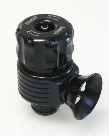

SoulSearcher Posted January 8, 2009 Author Report Posted January 8, 2009 so it's still in the shop :wink: but they've pressure tested all the joints - ok they put it on a dyno (I got a whopping 60kW!!!) and found that there was an exhaust leak from the manifold, new gasket should be fitted tomorrow fingers crossed. BOV diaphragm was furkk-ed (hence the different turbo noise!) so i got me one of theeeessseeee :P it'll be going back on the dyno soon to get everything set up properly and then i'll be getting a boost guage so I know whats going on with the turbo, hopefully this saga will end soon and cheaply! Quote

13BT_KE20 Posted January 10, 2009 Report Posted January 10, 2009 BOV diaphragm was furkk-ed (hence the different turbo noise!) so i got me one of theeeessseeee :wink: so Raven was right....he made a comment about your BOV making a different sound at the photoshoot, he its probably stuffed. Seems he was right :( Hopefully when its all sorted your dyno numbers are a bit more impressive, what do you think it will make? how much do it ideally want? Quote
