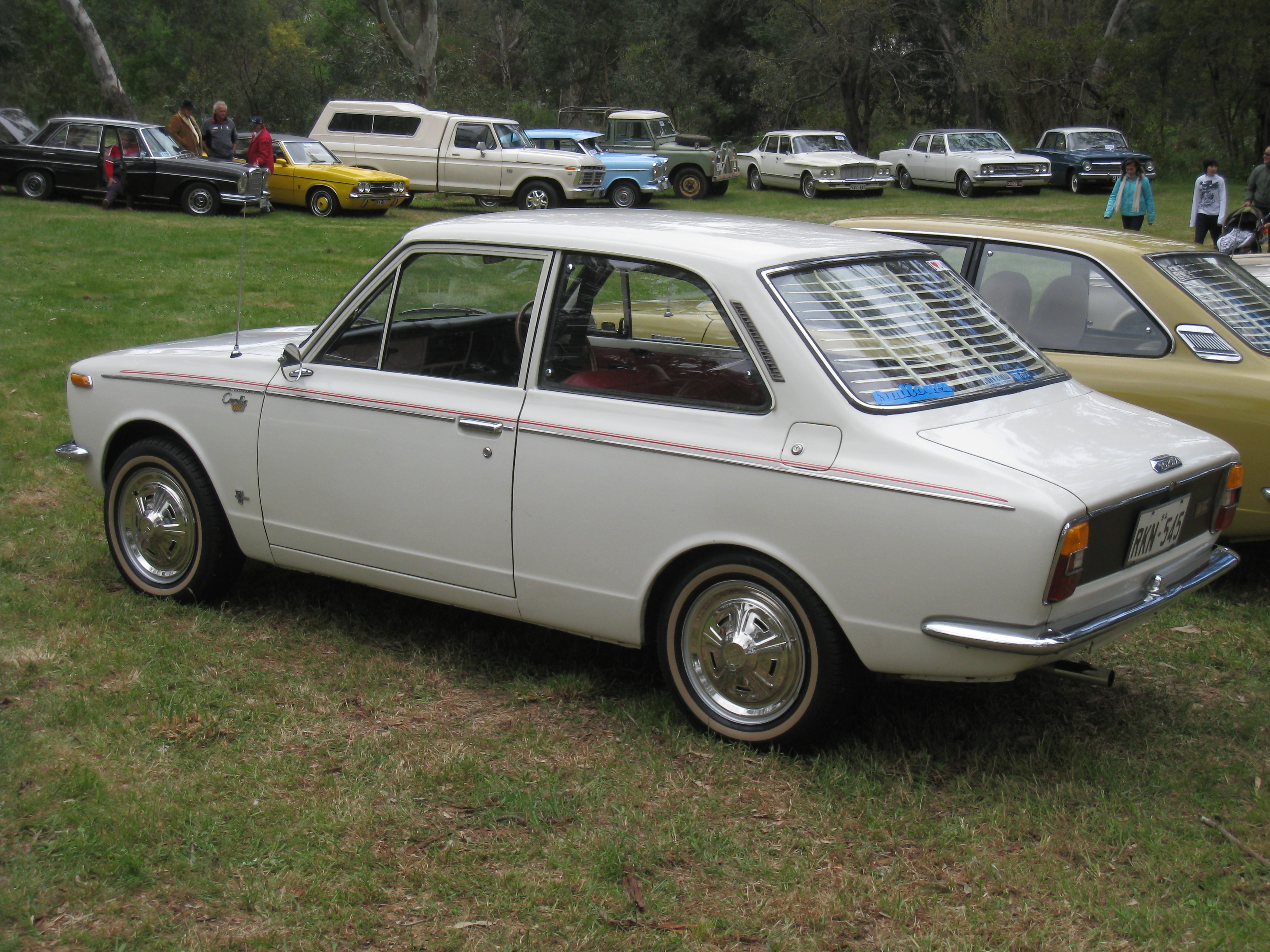

benzo Posted August 10, 2009 Report Posted August 10, 2009 Looks sweet Henry, I dig the pinstripe. I'm still trying to figure out what colour they are. black and red? +1 to what Ryan said about the exhaust though Did you end up selling the KE10? Cheers, Ben. Quote
kE20ME Posted August 10, 2009 Author Report Posted August 10, 2009 (edited) haha yea its red, sorry about pic quality crappy camera phone.. yea the exhuast does hang low... i had a suss of the mounts and its sitting on the hangers as it should be.. i think being a non standard muffler doesn't help... when i get my mig welder back from a mate ill look into.. maybe cut and re-weld the muffler back on as i think the outlet doesn't sit dead centre from the muffler.. so it just needs to be turned around till it lines up and sits higher :P ke10 is still here benzo... you want it? ill do you a special price hahah :lolcry: i want to list it on ebay but I'm not going to bother until i have some decent quality pics of the car and parts etc etc.. gotta get down to the shed to sort it out... Edited August 10, 2009 by kE20ME Quote
