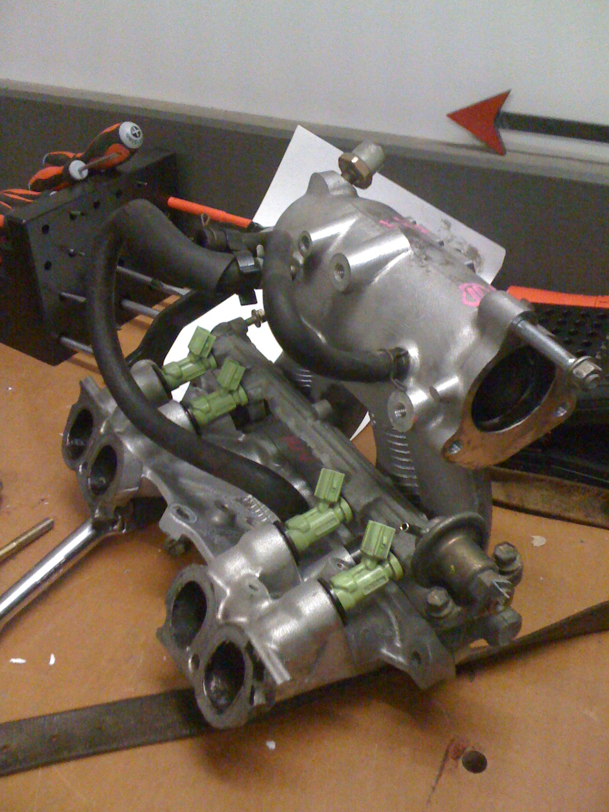

leigh Posted August 24, 2010 Author Report Posted August 24, 2010 leigh said: Car is going along well... Installed a new central locking kit Last week as i didn't like the setup of my old one! Also bought some parts to setup an incar boot release. So will hopefully install that over the weekend!Waiting for my TAX return to come so I can look at getting some new bits! Thinking Coilover sleeve kit for my ta22 struts plus new swaybars or maybe going for a 5kze...... :jamie: 7ke manifold purchased, Surge tank, efi pump and lifter pump purchased aswell! Rising rate fuel pressure regulator on the way! Thanks Si Hopefully getting a standard 4k cam off Ben this week aswell! Just sorting out sensors for the ECU (Thanks to Nick for the Help) Will hopefully start modifying the sc12 this week to mount the 7ke throttle body infront of the blower! Wreckers this weekend to find a pully to mount to my motor aswell or will start match porting the 7ke manifold to the 4k head! Quote

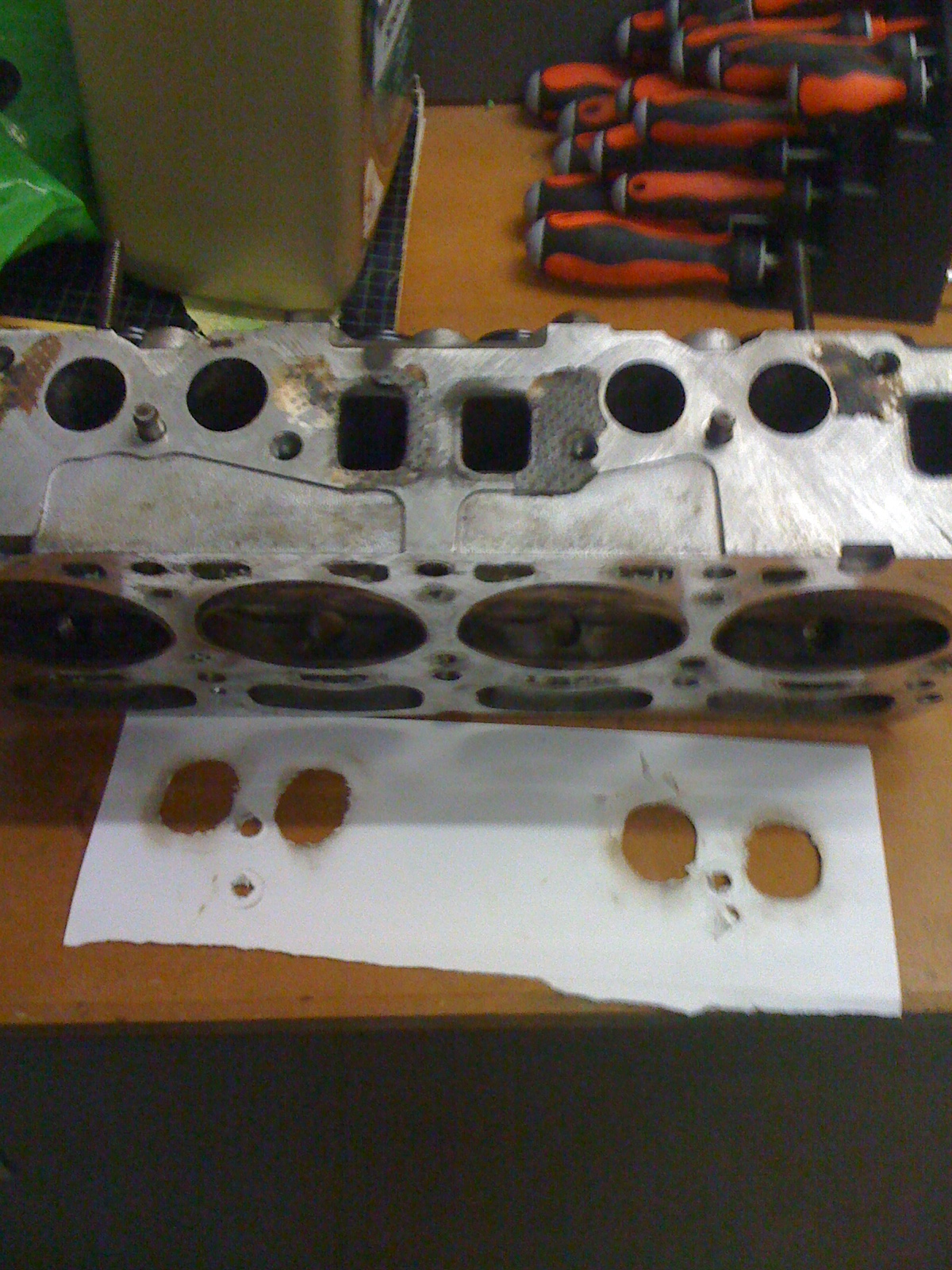

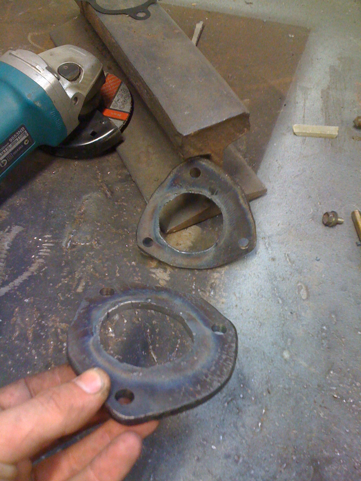

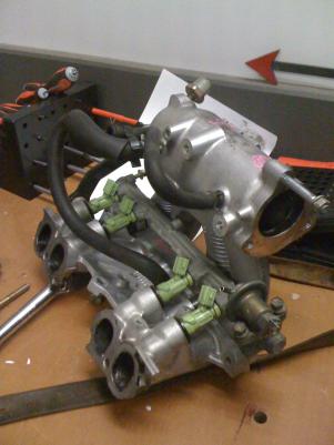

leigh Posted August 26, 2010 Author Report Posted August 26, 2010 (edited) 7ke mani Head to be opened up Some flanges i started to knock up this arvo Edited August 26, 2010 by leigh Quote

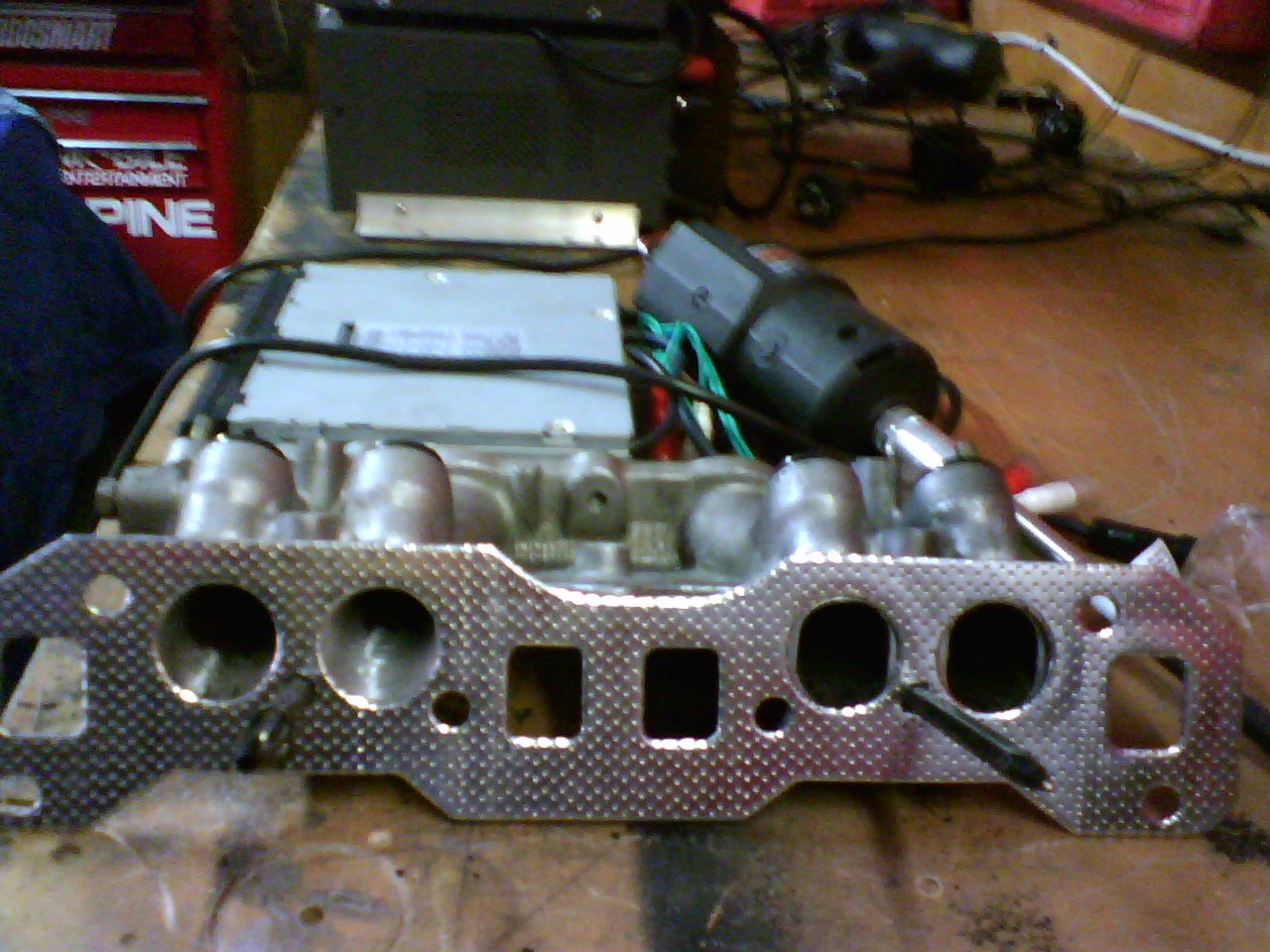

Taz_Rx Posted September 1, 2010 Report Posted September 1, 2010 Only way to match port the manifold and head will be to round out the manifold ports and then port the 4k head to the size of a 3kbp. Gasket is a permaseal EM30, which has 3kbp sized ports. :jamie: Quote
leigh Posted September 1, 2010 Author Report Posted September 1, 2010 Taz_Rx said: Only way to match port the manifold and head will be to round out the manifold ports and then port the 4k head to the size of a 3kbp. Gasket is a permaseal EM30, which has 3kbp sized ports. :blinks: Ill do it that way then! Get abit more flow! Where did u get that Gasket from Si! I like the look of it! :jamie: Quote
Taz_Rx Posted September 1, 2010 Report Posted September 1, 2010 Burson. Should be able to get for around $10 depending on how much they like you! :blush: And while you're on Wellington street stop in at nuts and bolts and get yourself some sanding flapper wheels in a couple of different grits. You'll need the 3mm shaft ones if you're going to use a dremel. If you don't have a dremel then I'm about to buy a die grinder for my compressor so you could come around and use that. :hmm: Quote
