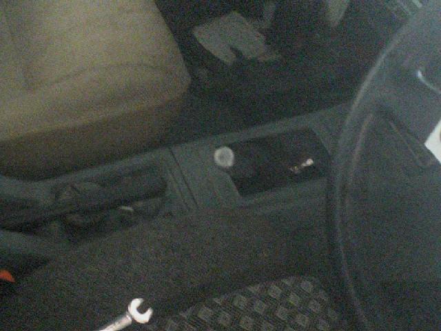

4age Posted February 26, 2005 Author Report Posted February 26, 2005 (edited) it was on her when i bought the old car that the 4age was in so i really can't tell you if there was any problems but she is a nice box :D tiny shifter sorry for bad pic but i have only got a mobile phone to take pics with Edited February 26, 2005 by 4age Quote
irokin Posted February 27, 2005 Report Posted February 27, 2005 I bet it doesnt have a thread on it does it? My celica has a stubby little "shifter" Its just there to put the flashy handle on. Your not accually supposed to put the knob striaght on it. Quote
trdcamrypride Posted February 27, 2005 Report Posted February 27, 2005 yeah thats like ours it is like 7 cm high plain mettal and then the gear stick just slides on and off. verry nice to drive likr that thoughi find it easer to drive the rolla with the 3000 lb cluch than the camry with i light cluch yet my dad finds the camry easer i dunno whats going on there. Quote
4age Posted February 27, 2005 Author Report Posted February 27, 2005 (edited) yea the stick haz been shortened but aparently wasnt very big to begin with + it sits 2 inches lower in the new rolla lol so its so small its only as high as the knob that haz been put on it so when i go to get rego I'm gona need to get a new stick because there is know way they will pas it lol :D Edited February 27, 2005 by 4age Quote
