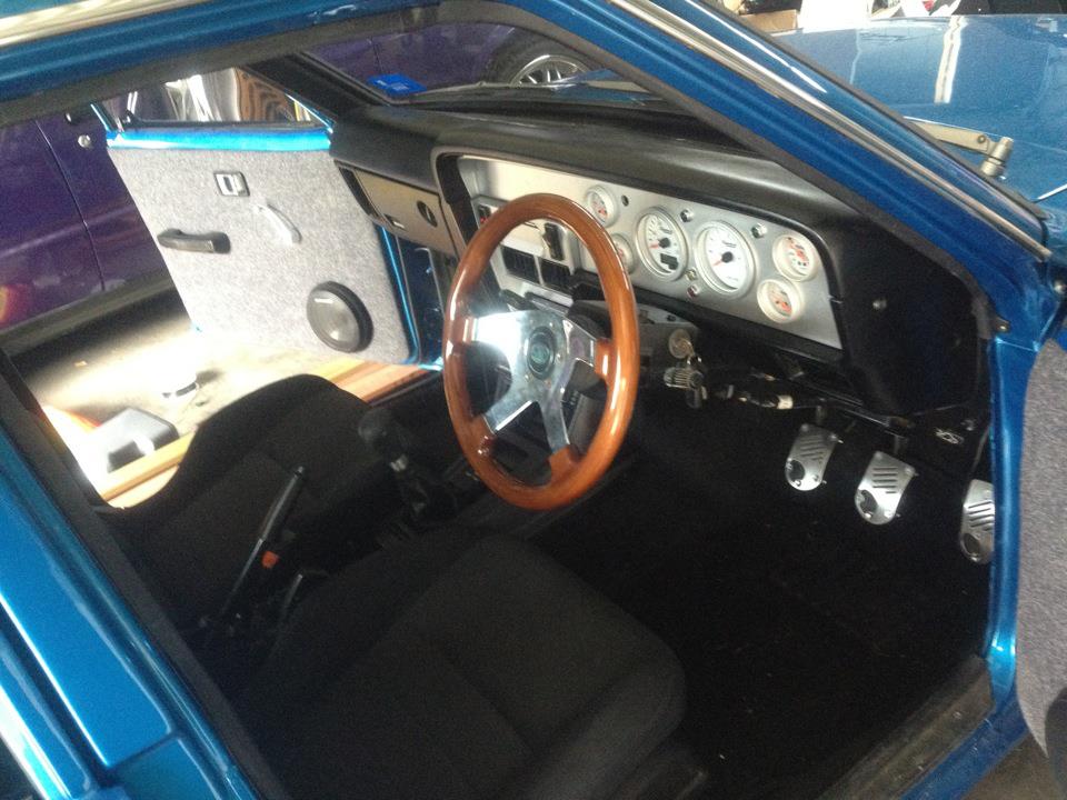

johnny t Posted January 15, 2012 Author Report Posted January 15, 2012 caltracs for traction for sure n maybe short stroke shocks with out a rear sway bar.. I'm thinkin more along the lines of a panhard bar to attatch the diff to the body to give it a bit more stability in the rear as i already have reset leaves with tramp leaf just need something to hold it together under full boost n angle. ill try it n see how it goes.. thanks for the link yeah paint isnt even cut n polished yet straight off the gun when it gets polished just before powercruise in 2 weeks ill put up better pics!! i just put my seats in n painted my dash ill put up some pics =) your build looks crazy so well done gonna be sweet when its done, i like ur attention to detail like shaving the flutes n the indercator in front guard looks great =) Quote
