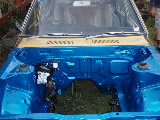

johnny t Posted January 4, 2009 Author Report Posted January 4, 2009 (edited) my engine bay got painted saturday :y: its off to the panel beaters tomorrow if i can get a trayler, to get the rest of the car ready for paint fix few dents ect. hopefully ill get it back soon so i can get the engine back in a get it to the auto elec to get the wiring done aswell can't wait! Edited January 5, 2009 by johnny t Quote
furryfrog Posted January 12, 2009 Report Posted January 12, 2009 Looks nice, Any more progress since the last picture? Quote
