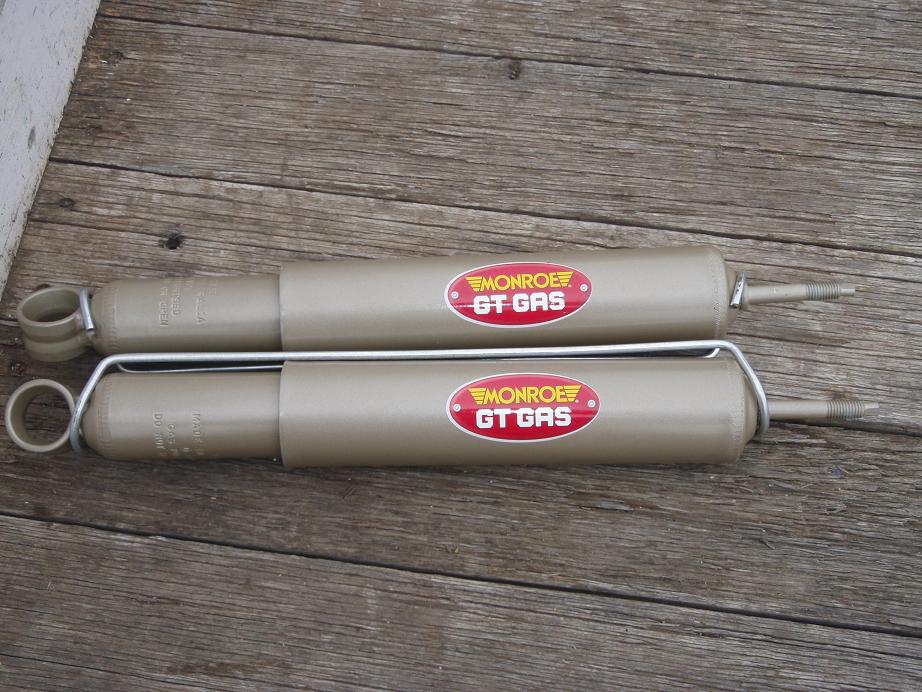

johnny t Posted December 27, 2008 Author Report Posted December 27, 2008 (edited) ive been flat out over the last couple of days here is my progress! ive put brand new monroe gt gas shockies in, whiteline sway bar. and a fresh coat of paint on the diff. also today i took the engine out and cleaned it ready for the painters to do there thing! should have it to them around the 2nd of jan get it bak mid-late feb to put the SR bak in!(finally) ;) Edited December 27, 2008 by johnny t Quote

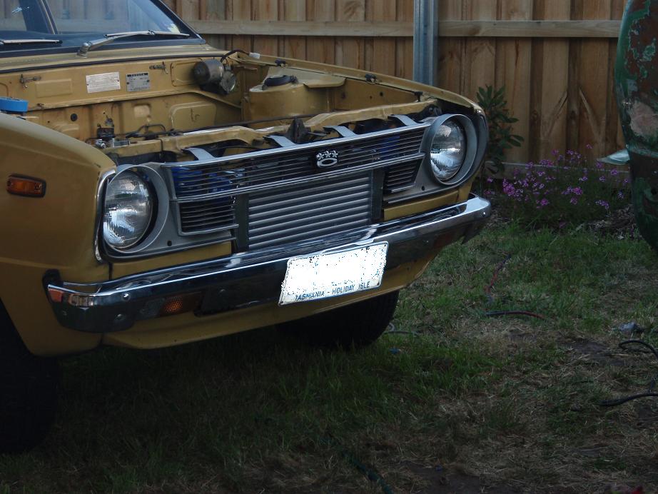

johnny t Posted December 28, 2008 Author Report Posted December 28, 2008 (edited) Here is the front of my new rolla.. my plan was to put the k55 front on it but it doesn't have the mounts to mount the 55 headlights! ;) so i decided to stick with the ke30 look now. what is everyone's view of the front of my 30? i had to cut the bottom half of the grill out because of the way he the intercooler is mounted .sorta sucks cause now its not so much of a sleeper.which i first wanted but i didn't have a choice anyways tell me what ya think thanks johnnyt Edited December 28, 2008 by johnny t Quote

oh what a nissan feeling! Posted December 28, 2008 Report Posted December 28, 2008 pre-load drivers side i recon. It is a shame you couldnt get it in behind the grill, but theres not much else you could do. I managed to shave the back off mine until it just fitted, but i think ke55 grills sit out a bit further. Looks pretty neat anyway! Quote
