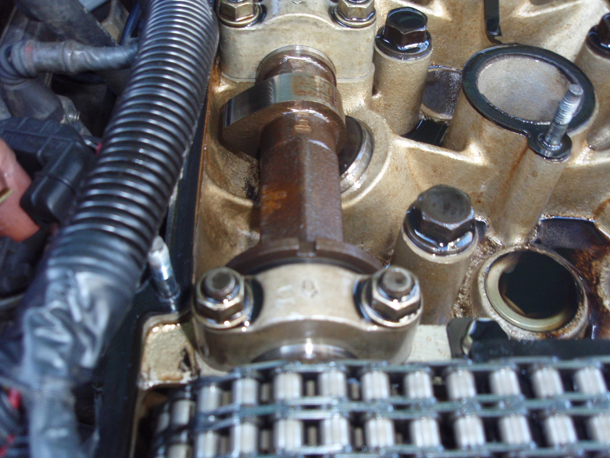

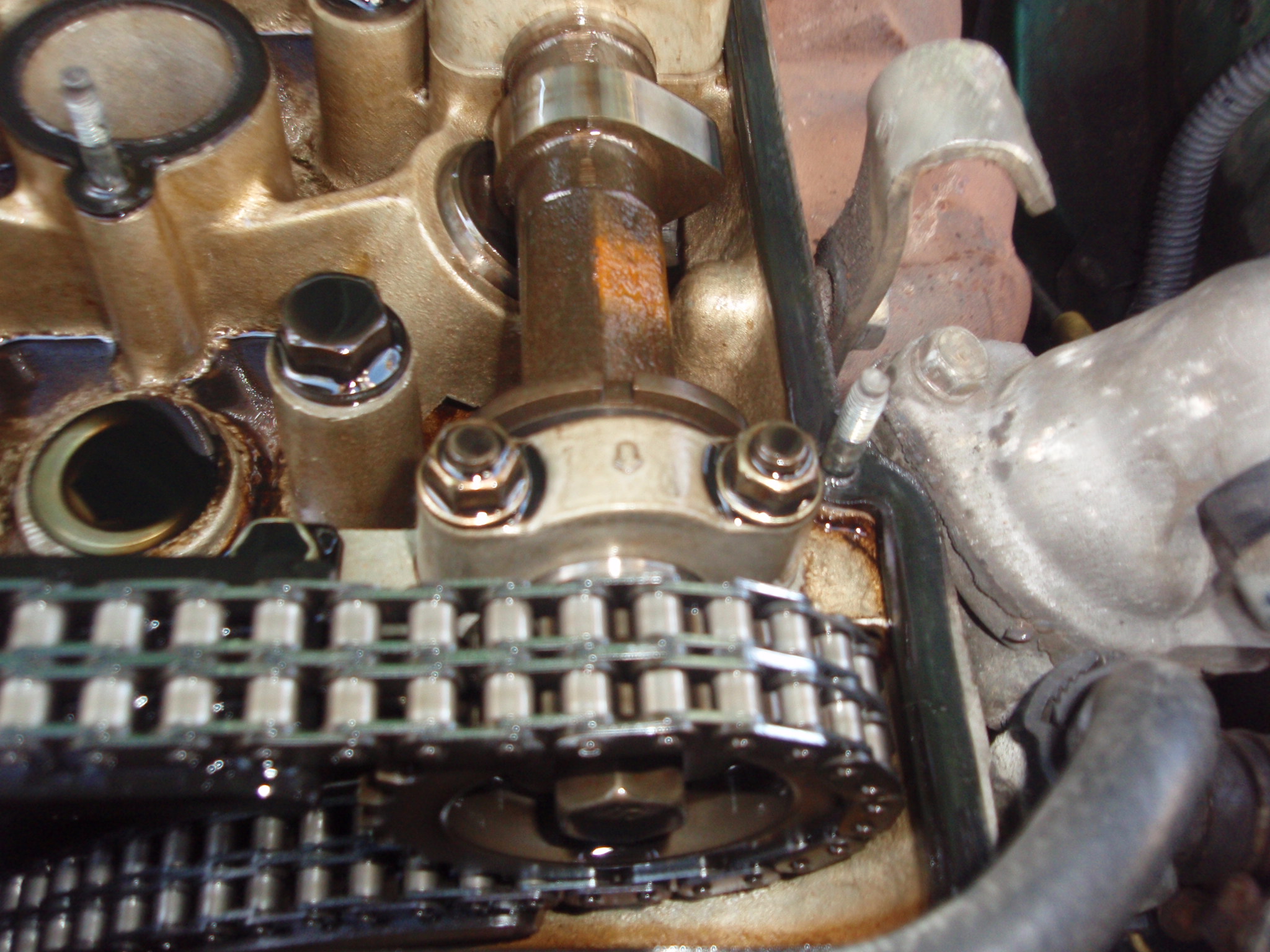

machg Posted March 1, 2009 Author Report Posted March 1, 2009 Dare I say...bling? & proof cam timing is spot on... Quote
