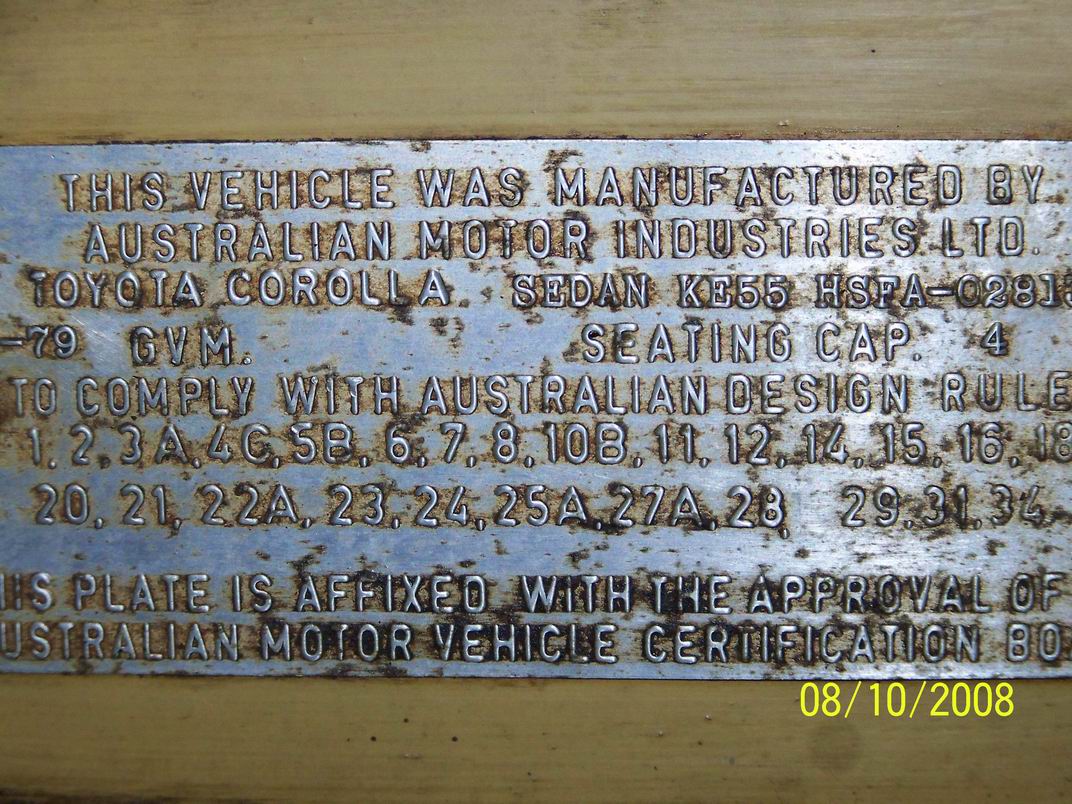

towe001 Posted August 9, 2008 Report Posted August 9, 2008 1JZ~lux said: This is what I was worried about. If I remember correctly, the Aust compliance plate has chassis number, engine number, build date, GMV and a few other important ones. This plate was riveted on and the rivets rusted off while driving. The indesructability of the 3K means I don't look under the bonnet often so I can't say it fell off in any particular area. Australian compliance plate is just that - what design rules the car complies with at the time of manufacture (eg - seat belts, seating, EPA crap, etc etc) Where as the build plate is to show what motor, gearbox, diff is in the car, what colour and trim codes are used, where the car was made, the "VIN". Incidentally the "VIN" is also stamped on to the firewall next to the build plate. For us (australia) we only got a basic "VIN" number on the cars. From memory its the engine code (eg - 3k) and then about 6-8 numbers which is/was the cars' build date (also its chassis code). America got a more formal version that gave the lot. Well, almost the lot. I'm to lazy (and warm in bed) to go out to garage and grab the info from the manufacturers parts catalog. If its just the compliance plate you need, just go to the wreckers and find another one and grab the screws holding it as well Quote
mustangsally Posted August 9, 2008 Report Posted August 9, 2008 As i am an authorised officer and can issue modification plates I get asked this all the time. In QLD the compliance plate is required for the details like seating capacity and codes for engine gearbox diff ect. . By fitting a QLD mod plate I correct the missing info and QLD transport seem happy that this is enough. Quote
towe001 Posted August 10, 2008 Report Posted August 10, 2008 This is the compliance plate and it might have the seating capacity but what it doesn't have is engine type, chassis code, etc thats on the build plate. Quote

WinKE55 Posted August 12, 2008 Report Posted August 12, 2008 (edited) It does have a code that is on the chassis; HSFA-02813 or whatever the last number is, that number is also should be on the top of your driver strut tower area. Edited August 12, 2008 by WinKE55 Quote
