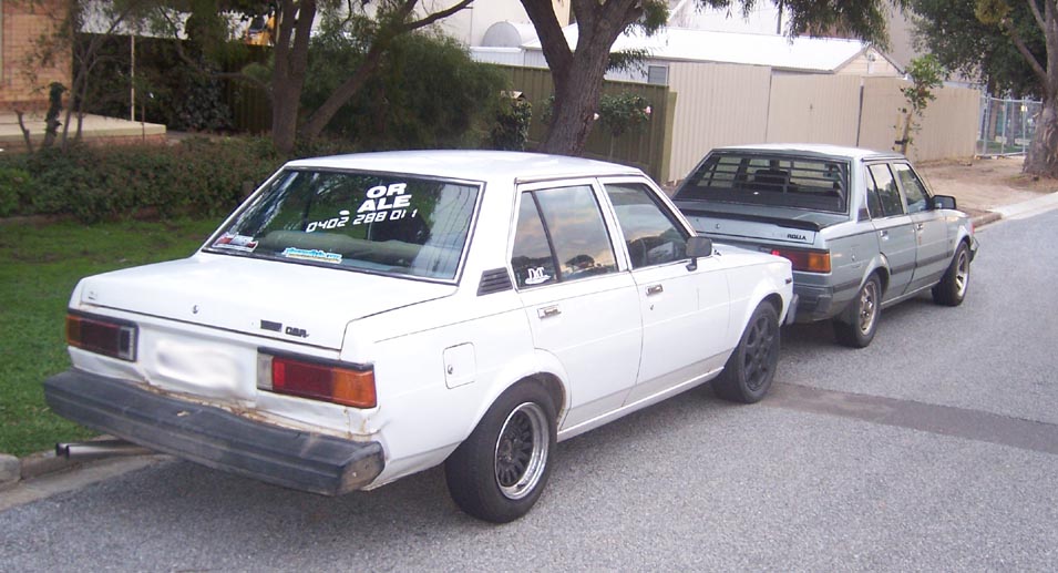

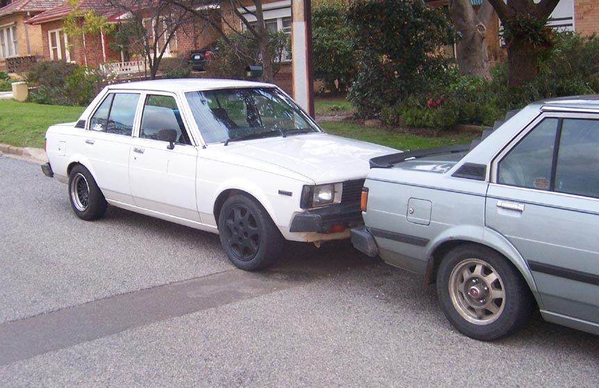

DearmanKE Posted July 24, 2008 Report Posted July 24, 2008 (edited) Update, This car has Plans now :bash: I will be superchargeing a 4k and puting it into this car I have never dealt with forced induction before so alot i have been doing alot of research on the matter I have started collecting bits and pieces so far i have 32/36 weber rescently rebuilt sc12 supercharger AFAIK in good nick Bosch high pressure fuel pump 4k AC Mount Soon getting a fairly fresh 4k to use as the base motor. The plan originally was to do a blow through setup, But i am now leaning towards doing a suck through setup as it seams like it has been done before more so than blow through carby and also i wont have to worry about overpressureiseing the carb, As alot of this stuff is and will be new to me I'm bound to stuff up somewhere along the way, so basically suckthrough = simpler. Current specs of the car(nothing special) Cut front springs standard front shocks, Nardi Steering wheel HQ Monroe rear gas shocks(good length and fitment, short stroke but not overkill like sieraas) 245mm free height Falcon Rear springs. S13 Wheels/13inch jellybeans/dragways, some other random 13's very tired 4k with water leaking out of the head, at the bottom so i think its done the gasket. doesnt matter because i have a daily ra40 for now Locker Once i get a full time job stuff should start happening a fair bit quicker, pizza boying only just getting me by these days lol Also on the list to do is front suspension and proper rear springs, In time id like to go 86 struts with descent shocks, 6kg springs and 4kg rear springs. Also some nicer wheels, 14X7'ish Edited December 1, 2008 by DearmanKE Quote
DearmanKE Posted July 28, 2008 Author Report Posted July 28, 2008 (edited) just a little fun daily for now if i find myself with spare cash i may get sprinter struts and proper springs and shocks but for now its not gunna have much done to it except be driven next mods will be rona arms and maybe a lock spacer Edited July 28, 2008 by Shizotimang Quote
