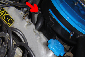

this is the little piece of hose i was talking about earlier. looks like it's there to vent crank gas and also spit oil everywhere?? shouldn't be venting to atmo - what the hell is this thing for?
that piece of hose was connected to the stock air cleaner, and yes its to vent the gas build up in the crank case :).
my suggestion is to head over to super cheap or the like and buy a oil beather or you could got back to the stock air cleaner setup

the hose on the rocker cover is for emissions, but wont really do any harm, just grab one of the oil breather filters from places like repo etc.
Sweet, will pick one up when I get fuel lines, thanks!

yeah the hose on the rocker cover goes into the stock air filter normally.
