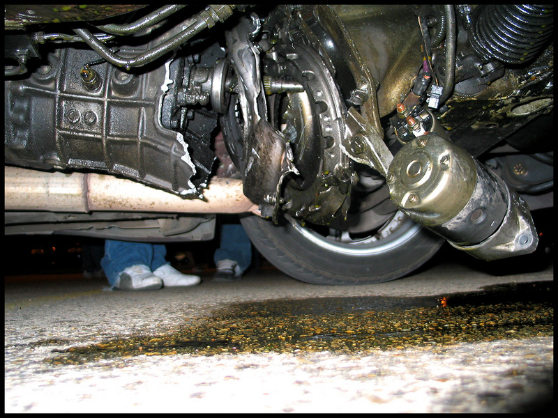

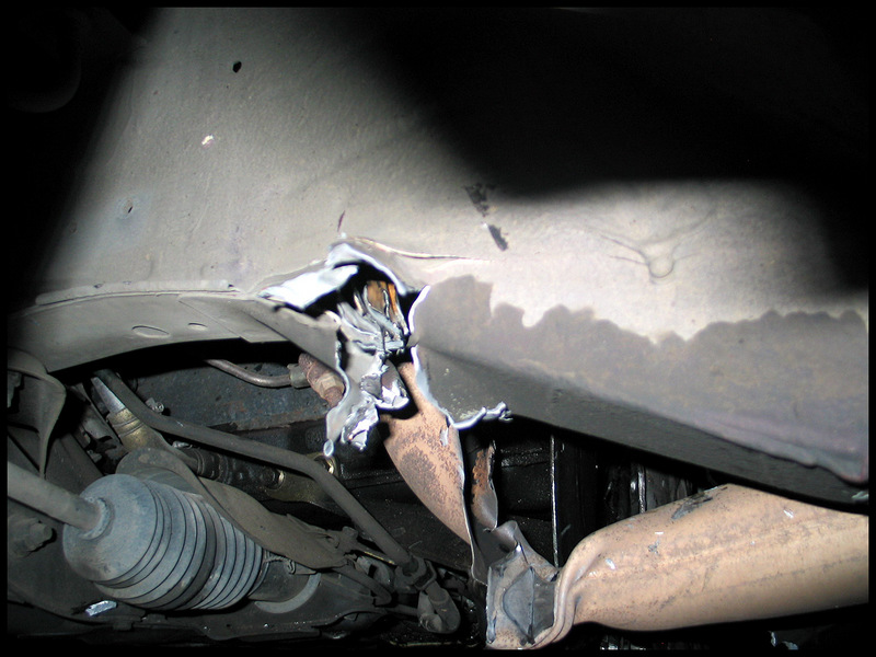

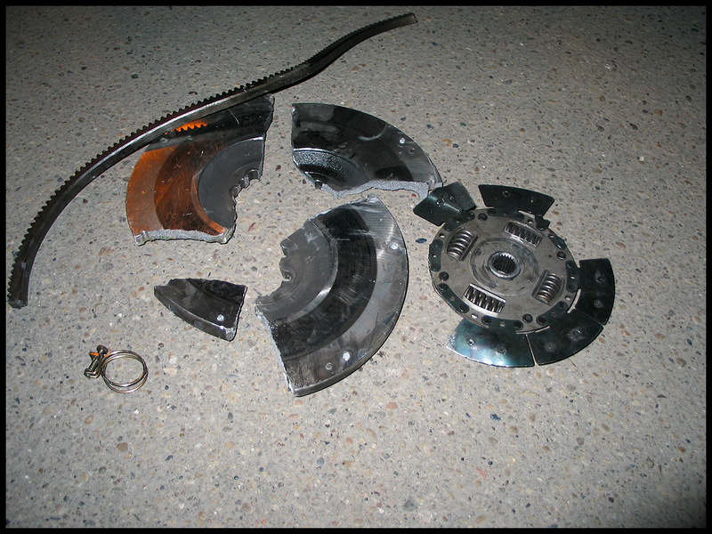

Jono Posted July 17, 2008 Report Posted July 17, 2008 not as good as the bogan vid but here are the pics of that r33. Quote
ke rollin 20 Posted July 17, 2008 Author Report Posted July 17, 2008 smeg that would really be a bitch to fix! ye when i say the same i mean in size..? i guess some will be lighter/heavyer... but will they all fit the same...? cheers Quote

yoda69 Posted July 22, 2008 Report Posted July 22, 2008 ke rollin 20 said: ok then..haha well i guess ill ask them what will be a good amount to take off then. :yes: gday haydo go light with the fly wheel. if ya can get a k motor to put the fly wheel through the bellhousing. i will eat my hat.to thin they cook them selves,and the clutch anyway. stick with stock flywheel bolts,these will brake way before you ever touch the border line with the flywheel. you may loose the lumpy idle.a well tuned car should idle without trying to jump out of the engine bay.bad tune. the wait in a stocker fly wheel keeps it spinning at low revs. with cam an light fly wheel your idle should end up at about 900 to 1100 revs.if tuned RIGHT. Quote
