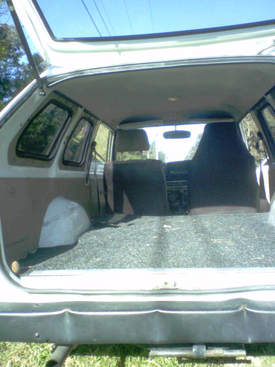

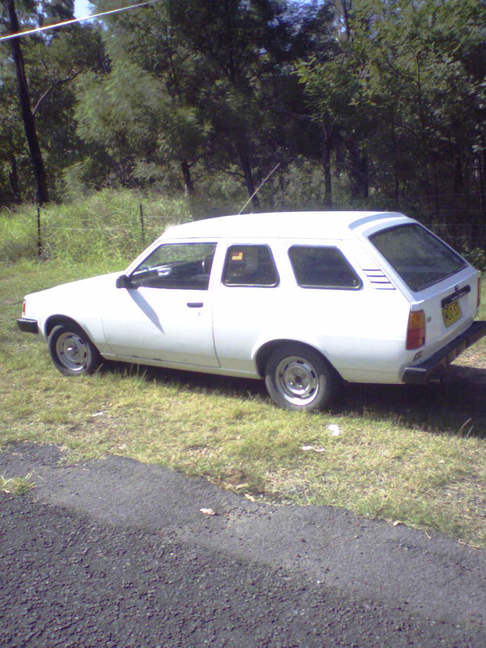

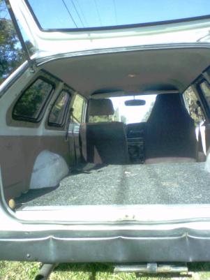

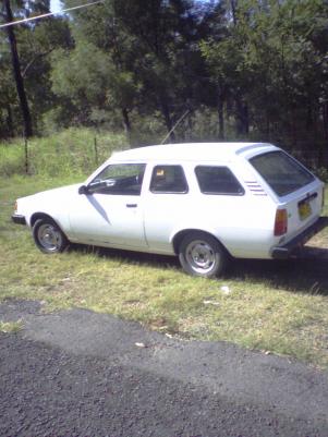

I use the panelvan for wintercamping. I can stretchout inside the van, if I lie crosswise and passenger seat is forward.
This beast is a workhorse. :fuzz:
Camping and bike-transporter. Pushbike fits straight in, no disassembly.
The only drawback I can see is with AE71 Panelvan is the extra large doors; hard to find.
and perhaps the rear hatch door & bumper/mount ; replace from a wagon.
Otherwise rest is all standard AE71 parts.
Corolla panelvans are hard to find, but should be available (stock & 4AC) cheaply <$800.- :P
If cost is more, than they have been modyfied already; so u have a bargain point.
Picture of van; '83 AE71
