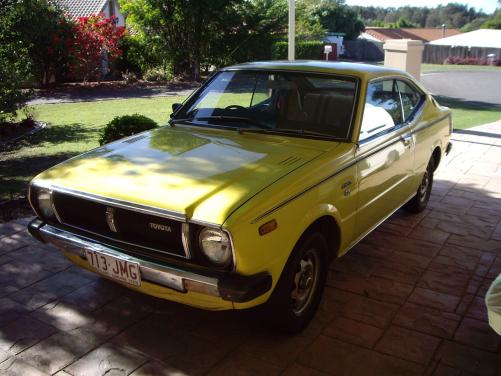

SO... Back to searching.. I saw one down at my local pub and it was a granny car.. so I stuck a note on his window and got it for I think $1200. with rego..

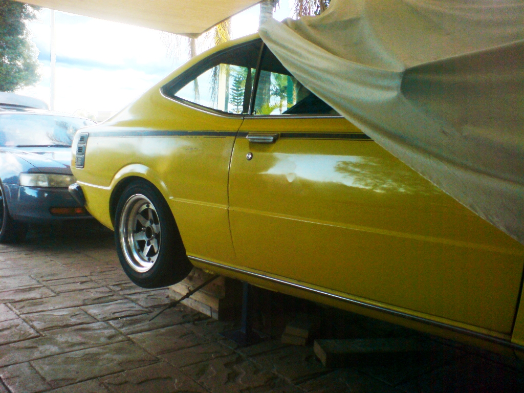

Up on 4 jack stands with nothing in it. She has no wheels suspension motor anything except dash and door cards

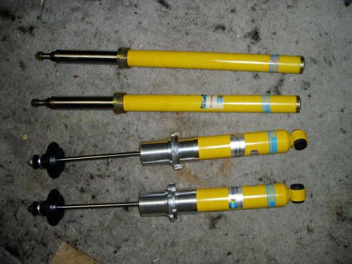

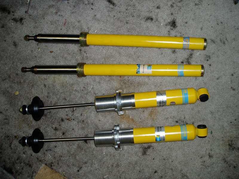

it is getting some major work done.. I have started with suspension work. Bilstein shocks at all 4 corners running coil overs front AND REAR!!! pic of shocks below
Thats right leaf spring are GONE! Its getting a celica T series diff with TRD 2way LSD and RT142 dics. Making WATTS Link rear end for it too.

Having been a party to putting a five link in an Escort, do you really know what you're in for?? You're going to have to upright and turret the rear mount. Are you using existing leaf mounts for the trailing arms? What are your trailing arms from, or are you fabricating your own? Mmmmm, Billies. Quality

yeah mate I know what I'm in for.. I have made my own trailing arms for the 4 link rear. they are all equal length and are made out of sealed spherical bearing so they don't flog out. also central adjustable LH and RH thread. Its all good. When I get the WATTS link setup with the diff I will be able to locate the diff into the current position to determine where to make the upper suspension mounts. If room is an issue (which it looks to be) I will be mounting them inside the cabin with push rods from the diff through the floor attached to rocker arms.

Good stuff. Maybe consider making turrets to put the rears up ala Group 4 escort. It means that the things will be near vertical. (Should be able to do it, but I suppose I should look at mine to see.) The verticalerer... ( I think thats a word) the better. Going for a cantilever design is just going to do your head in, and it wont work as well as you hope.

Yeah I was planning on doing that but see the problem I have is that the distance between the chassis rail and the inside of a standard rim under the guard is only 105mm and doesn't allow much with rims. Plus I would have to move the suspension lower mount 20 mm closer to the end flanges on the diff giving less available room for offset. mounting the suspension on the inside of the chassis rail is out of the question because there is too much over hang diff vs leverage at lower mount of dampers.
These are the dilemma's I will face when I bolt the diff in with the WATTS linkages. If there is a problem it will be 20mm or so push rods through the floor.

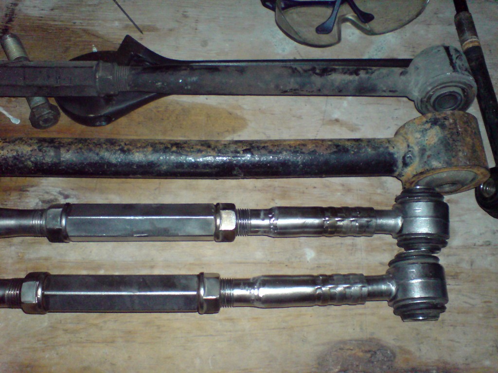

just bought some 14 x 7 longchamps for the girl.. also I have mounted the new diff in and set it at ride height. now the diff is located I can make the coilover mounts and WATTS linkage mounts for it. Ive had to take the bump stops out and will have 3" travel. Might actaully move the bump stop or make some more.
Also pictured below is the new trailing arms VS the old ones
