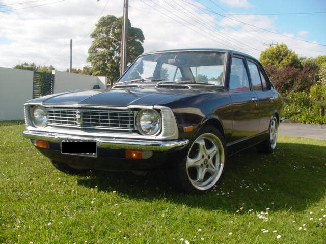

ke-rolla Posted June 22, 2008 Report Posted June 22, 2008 (edited) well iv already posted her up on other forums so I'm sure a few of you have seen it, anyway i thought id share it with the others who havent and see what they reacon, don't have many pics of it on my laptop so il give you the basic rundown of whats happend over the last 2 years since i got it.. bought the car as it looks in the first pic, running the mighty 3k and driving overrated, winter came round a couple months later and the damn thing wouldnt start so i decided to go injected, was ment to be a short and simple conversion but one thing led to another and well heres a rundown on whats been done: 16v 4agze smallport head/block>w55 celica box custom turbo manifold with rebuilt s4 rx7 turbo turbosmart 38mm ex. wastegate custom intake setup-blacktop quad throttles link g3 ecu all wired in with boost control solenoid 4.3 LSD hilux rearend fitted with s4 rx7 rear discs and plenty more.... car hasnt been started but is nearly there and plans are to have it going and tuned towards the end of the year let me know your opinions and ideas :( more updates will be up soon Edited November 18, 2010 by ke-rolla Quote

Doogs Posted June 23, 2008 Report Posted June 23, 2008 Nice job, and a 4 door to ! :( Keen to see some more pics. Quote
ke-rolla Posted June 23, 2008 Author Report Posted June 23, 2008 cheers mate this is the only other pictue i have of it, was taken just after i took it off the road Quote
PMP020 Posted June 23, 2008 Report Posted June 23, 2008 nice one. a boosted 4 door. would love to own a 4 dr 20 one day, we didnt get them over here in australia. just like you guys got all the 2 dr ke26 wagons, bastards :( keep the progress shots coming. cheers, scott Quote
