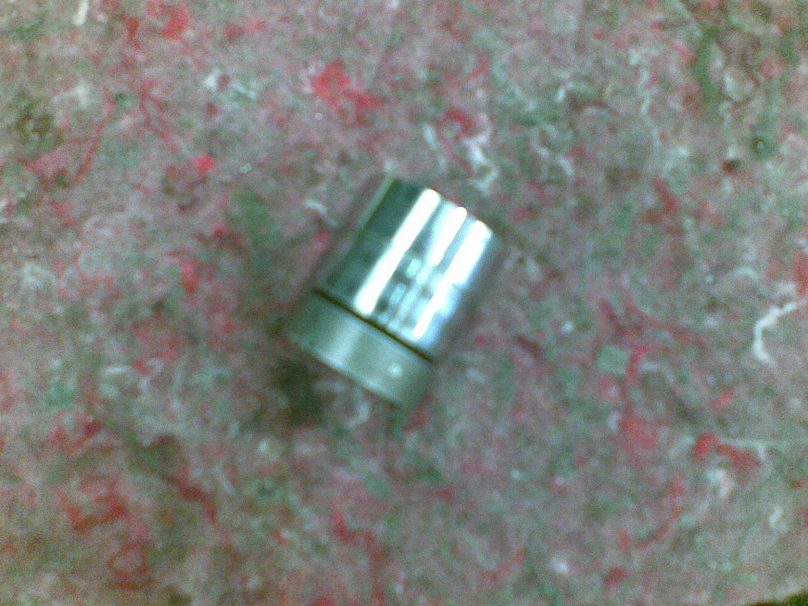

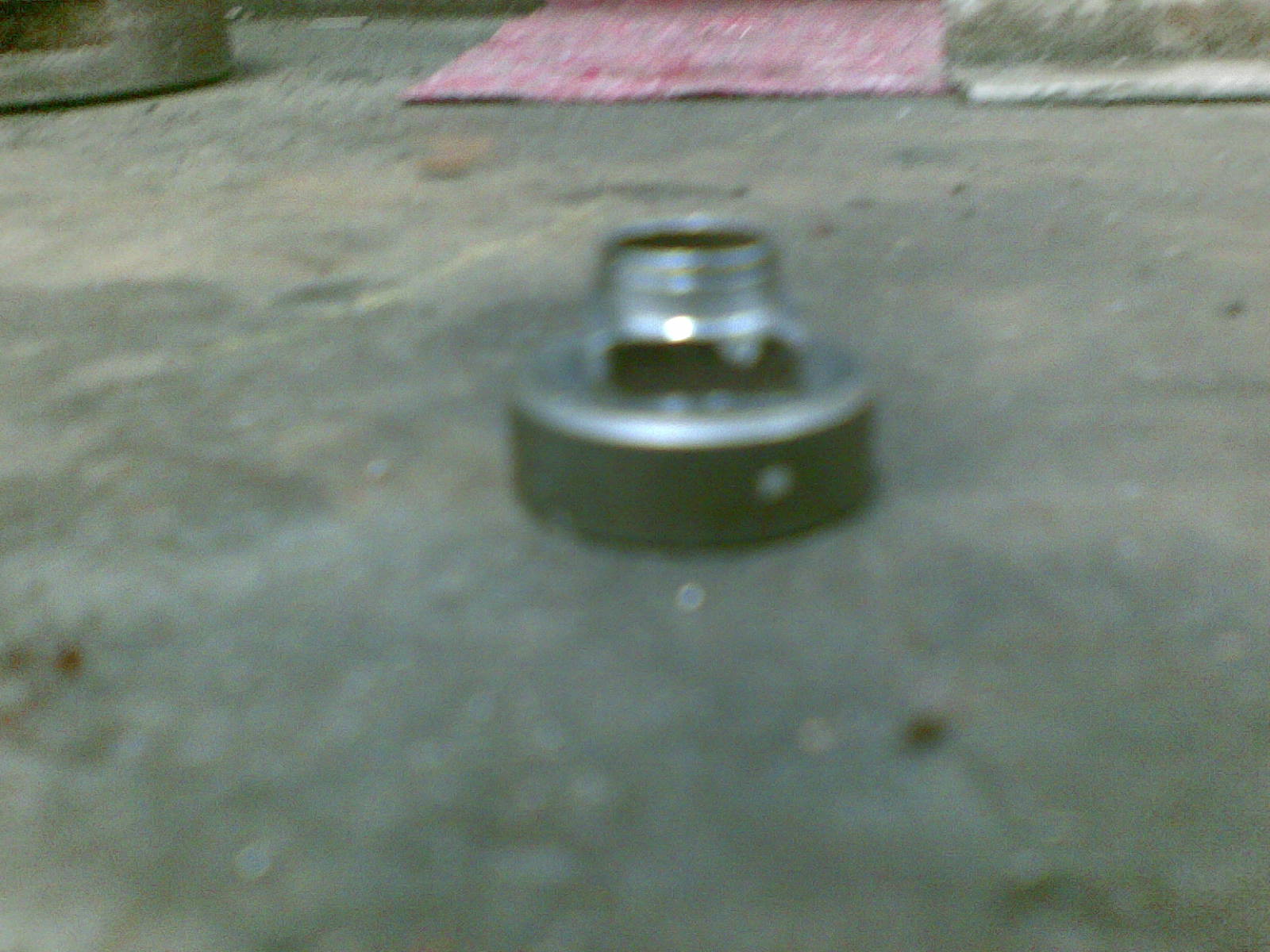

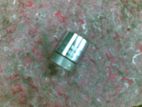

Pete-ke20 Posted June 22, 2008 Author Report Posted June 22, 2008 okay, so its been a week or two since my last update on the beast, in the past while i havnt had much of a chance to do many major things to the car, but i have had some spare time at work to make a few little bits and pieces. I have improved my CAS drive set-up, as the set-up i had didnt run tru and was bad. The system was basically a 17mm socket running off of the cam bolt, that was held to the trianlgular CAS bolt/captive nut thingo, with three grub screws but it had to adjust them to with-in the 1thou kinds range i would like it to be. So i turned the trialgular bit down the be round and then pressed fit a piece of 1/2'' square bar over it, which fits perfectly up the end of a 1/2'' drive 17mm socket funnily enough, i then had the shorten the socket a little, which the lather made light work of. I then glued the socket to the base of the drive mech so it didnt fall out during install. I also had the chance to turn up a seal for where the CAS mounts to the timing belt cover mount i made, previously there was a .5mm gap the way around where water and dirt could get in, bad as seeing there are magnets and shit in there. So i got a bit of teflon, as i had heaps lying round, and made it an interference fit into the CAS unit and then bigger around the sealing face so i could seal, while teflon is not the best to use for a seal, it will be adequit as the CAS does not move and crushes against it once installed I have also relocated my coil mount from the front of the plenum, which now has a throttle body in the way, to the rear, unfotunatly i will need two new ignition leads as two were too short to reach only by a few mm too :( and i don't like stretching the f**k out of them. i think i have some pics of my CAS (Crank angle sensor) drive thing i made. All i have to do now is interior and the inlet and exhaust plumbing + shorten my accel cable!! Sorry about shit quality pics my phone lense was dirty Quote
