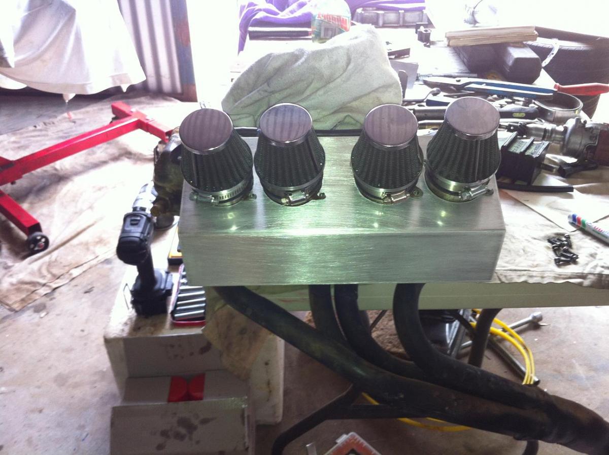

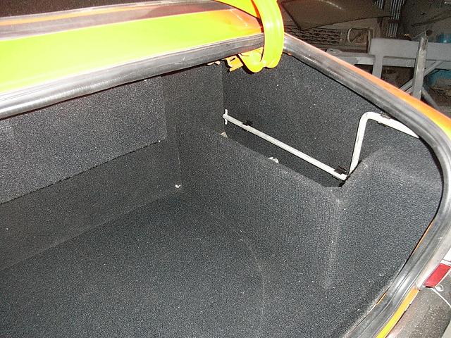

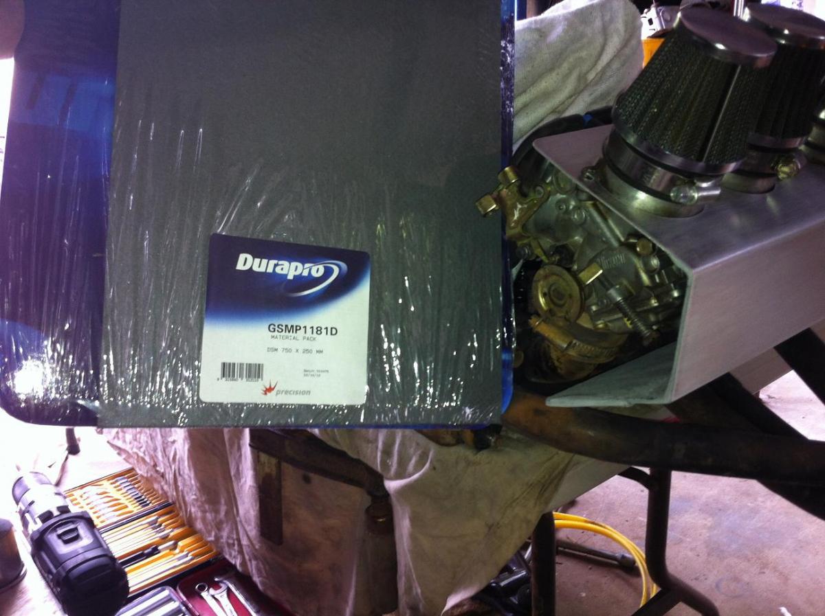

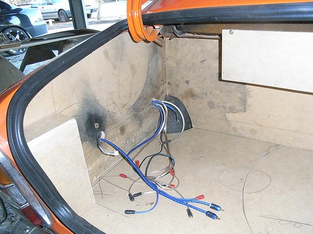

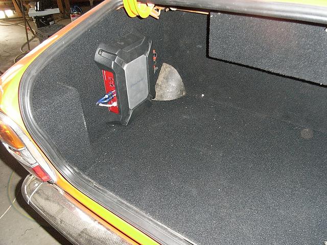

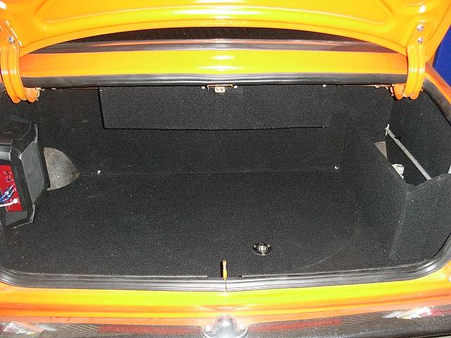

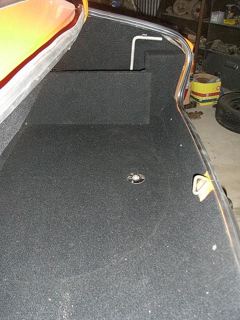

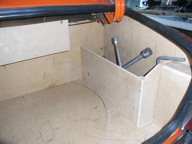

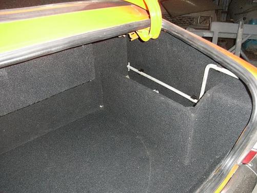

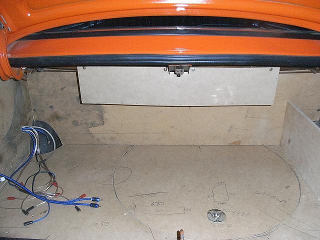

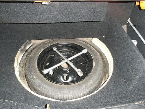

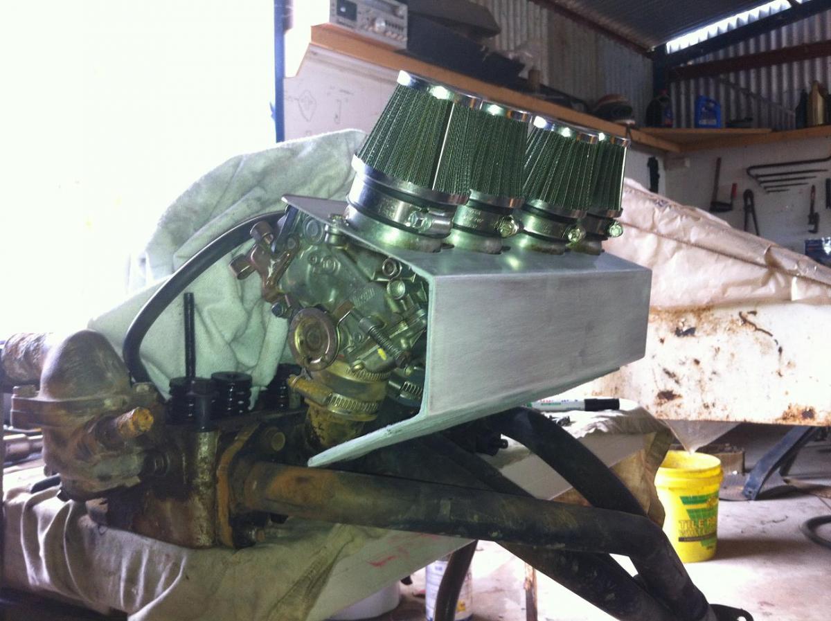

TOMMYS Ke 11 Posted February 14, 2013 Author Report Posted February 14, 2013 (edited) Hi there every one we have'nt put any photos up for a while so i got Thomas to down load some for me (I'm not that clever haha)for you all to ejoy what we have been doing to his little rolla. Photos of the carby heat sheild i made and the linning out of his boot it all came up real sweet (well thats my opinion) also a couple of photos of the current project FJ holden ute which i have to fully reassemble bloody big job but should be fun and look allright when finished i'll post pics of the finished job anyway i hope you all enjoy. Cheers:- Stuart (Thomas dad). Edited February 14, 2013 by TOMMYS Ke 11 Quote
