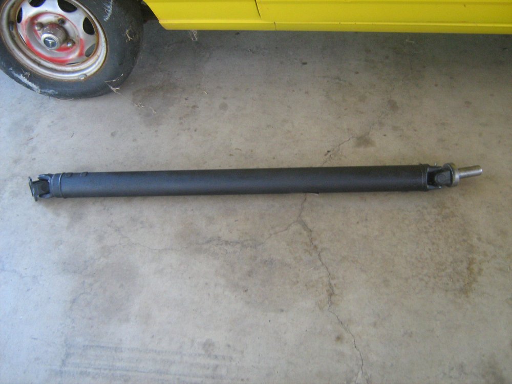

7shades Posted April 30, 2008 Author Report Posted April 30, 2008 At that price, I may as well get two... maybe in different colours. Quote
philbey Posted April 30, 2008 Report Posted April 30, 2008 Crikey. You'd have to be pretty keen to run Aluminium unis in the long term as well - you can guarantee you will be replacing those when they go BANG. Quote
irokin Posted April 30, 2008 Report Posted April 30, 2008 Well its not really designed for road cars. The big design advantage is that it takes loads of torque down the shaft but a knock from the side will snap it. So when your unis fail it doesn't take your legs off, the shaft just disintegrates. Its also a piece of cake to balance because of the low weight. That particular shaft is for an S13 and I very nearly bought it! Quote
