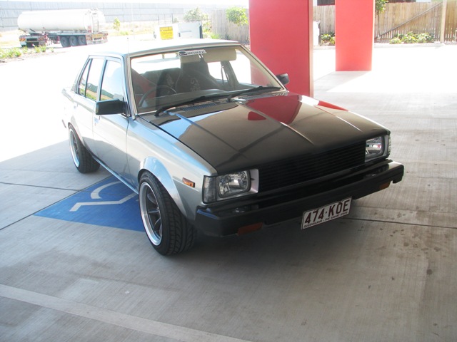

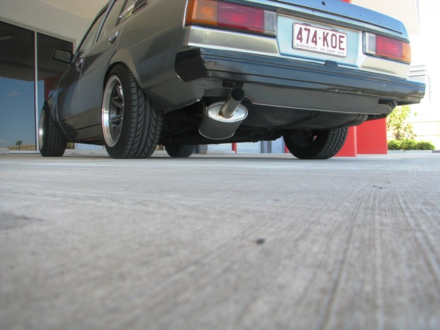

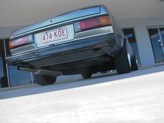

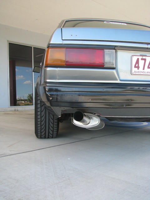

adam-__- Posted May 15, 2008 Report Posted May 15, 2008 Here are my wheels. 15x7.5 -8 offset wheels wearing 185/55 tyres (my speedo was out so I used larger profile tyres to make up for it). Flare work was involved for them to fit. Quote
Low Toy Posted May 16, 2008 Report Posted May 16, 2008 adam-__- said: Here are my wheels. 15x7.5 -8 offset wheels wearing 185/55 tyres.Flare work was involved for them to fit. Well worth it tho, those fill out the guards nicely... looks sick... Quote
styler Posted May 16, 2008 Report Posted May 16, 2008 hey 185 on 7.5 inch rim works but i doubt its legal. Quote
adam-__- Posted May 17, 2008 Report Posted May 17, 2008 (edited) Low Toy said: Well worth it tho, those fill out the guards nicely... looks sick... Yep, I agree. Cheers mate. styler said: hey 185 on 7.5 inch rim works but i doubt its legal. I think a 185 is just too small for a 7.5" rim to be legal, but if I had run 195's it wouldn't have fit. I don't mind a bit of stretch, but each to their own. Edited May 17, 2008 by adam-__- Quote
reddo Posted May 19, 2008 Report Posted May 19, 2008 (edited) adam-__- said: Here are my wheels. 15x7.5 -8 offset wheels wearing 185/55 tyres (my speedo was out so I used larger profile tyres to make up for it). Flare work was involved for them to fit. how hard did these wheels rub? Edited May 19, 2008 by LittleRedSpirit Quote
