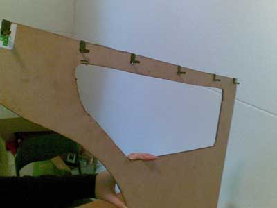

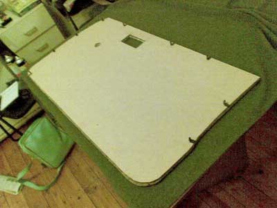

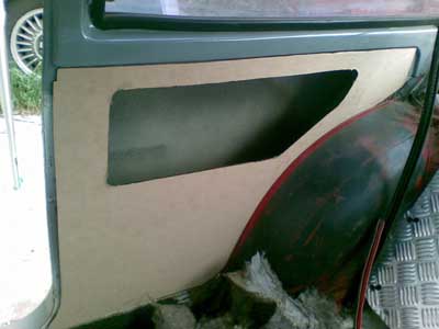

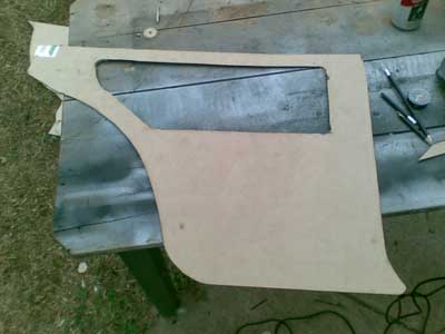

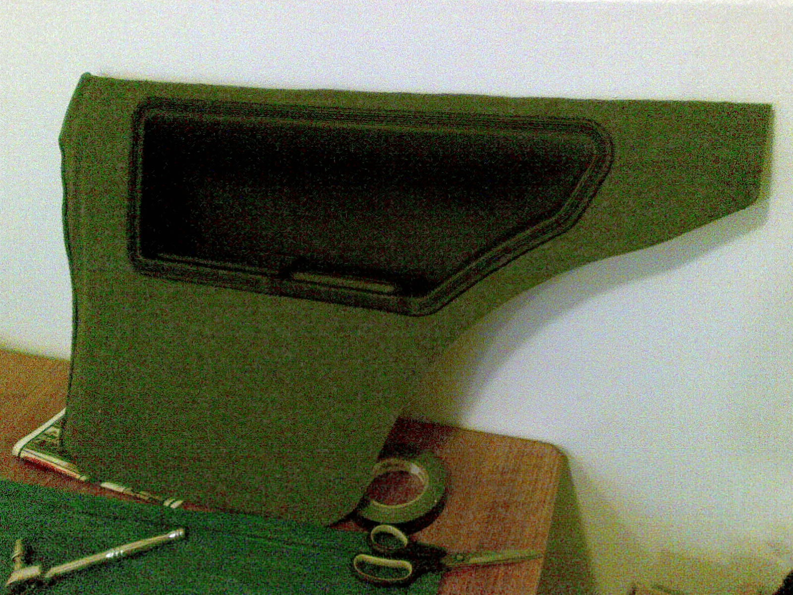

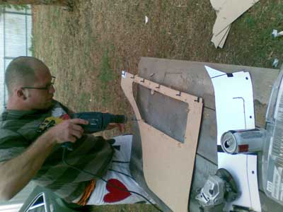

first trace your original trims onto the mdf.
cut out new mdf trims
trial fit
put the clips on.
drill holes for the lugs on the "pocket" bits

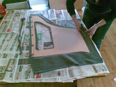

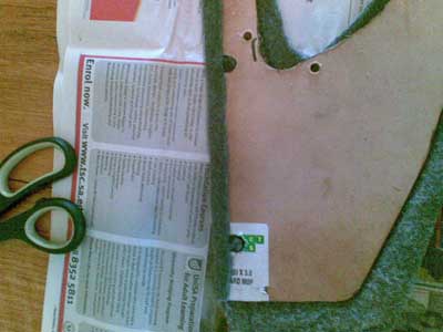

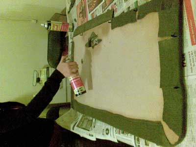

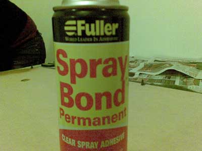

upholstering the trims, used spray adhesive to stick the fabric to the trims.

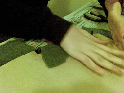

my partner cutting the fabric

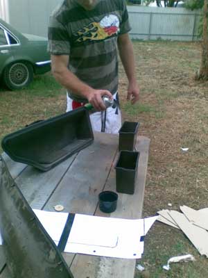

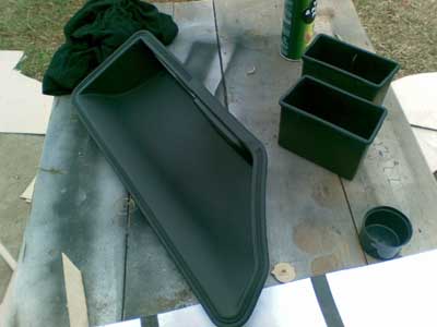

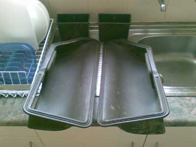

ugly brown pockets getting washed

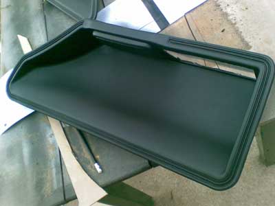

vinyl spray to make them black
ooh, my venetian!

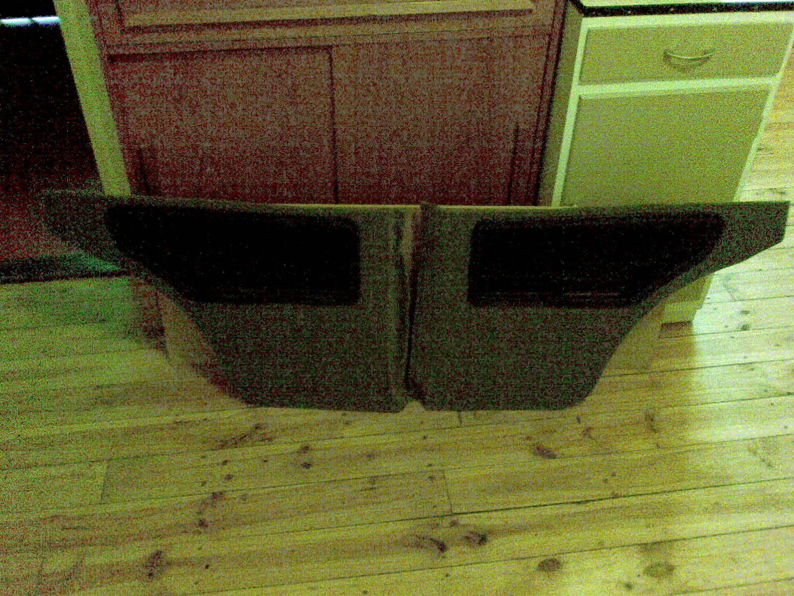

re assemble the trims and you should end up with a nice schmik looking brand new trim!!

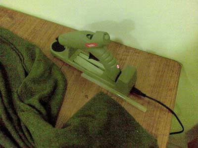

hot glue gun

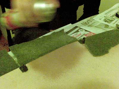

spray adhesive, upholstries best friend!!

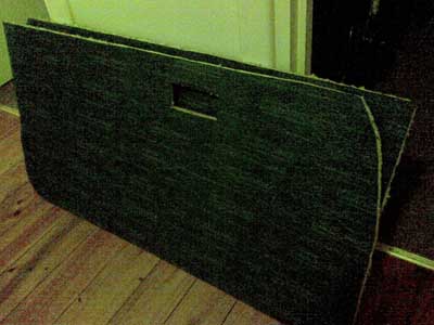

sticking the excess to the back of the trim, be careful not to leave wrinkles in the other side!!

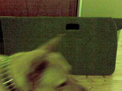

the finished product, better photos tomorrow when there is more light.
