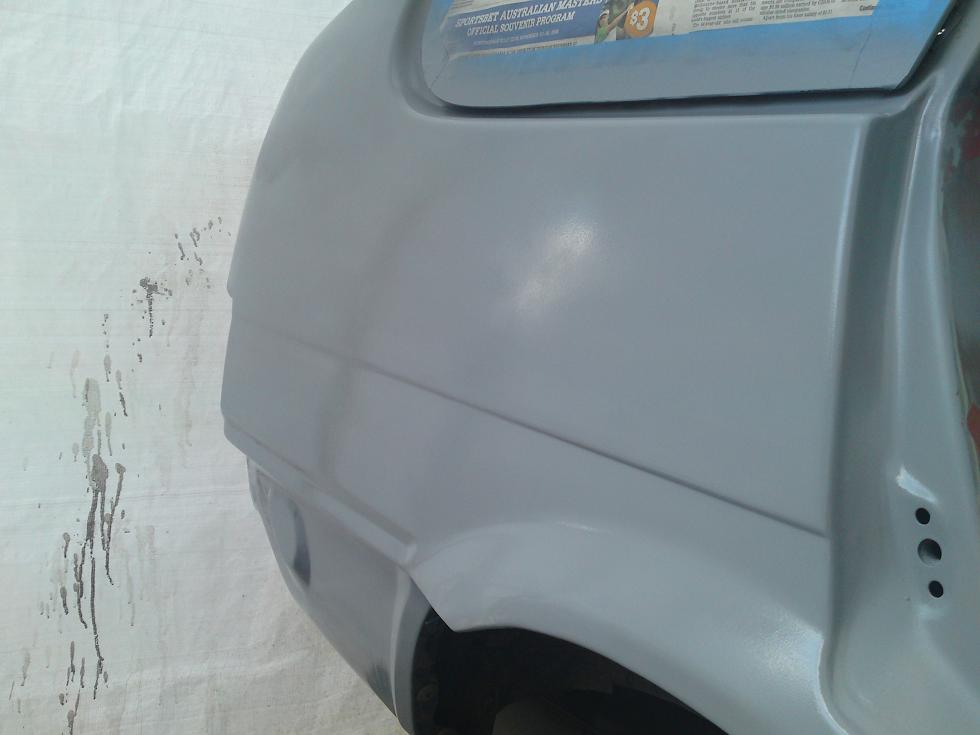

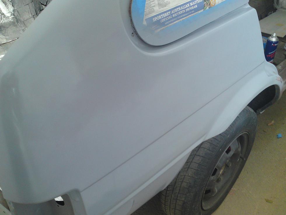

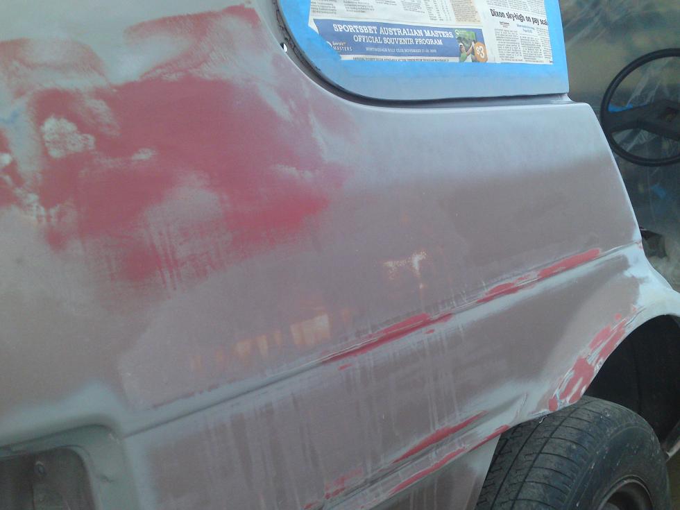

Johno Posted February 27, 2009 Author Report Posted February 27, 2009 (edited) Is this painted yet? Just trying to give you some motivation. Thanks man :y: This must have been at least on the third page, :dance: I "WAS" going to paint the whole car last weekend, rolled the car out in the sun and went over the whole car looking for any bits to fill just making sure i got everything. I sanded the whole car down with 400grit sandpaper and then went over the car with wax and silicon remover and made sure it was all clean.... BUT!!....... The rear quarter right hand panel had a waxy feel to it, I wetted it with water and the water beaded off like i had just polished it with turtle wax. I wet rubbed the panel back a bit and tried again and water still beads on the panel. No where else its doing this. Only that panel so i have come to the conclusion that i have to strip that panel back to bare metal :( I had organized for the panel beater guy who's painting my car to come round this weekend to look over the car but have to fix this problem first :y: I haven't done a fat shit to the car this week. I had to help my brother fix his Ke70. Its getting a rwc and needs a fair bit fixed so i been spending my time on that and also making a video for the rollaclub 2009 Gor cruise. check it out.. this is where most of my time went after work each night.. http://www.youtube.com/watch?v=_LNx7Tl8ZCA Oh and its better if you watch it in High Res ^ :) Edited February 27, 2009 by Johno Quote
Johno Posted March 1, 2009 Author Report Posted March 1, 2009 (edited) The car is now ready for 2 pack primer. Still have to do the doors and boot but its getting there. Tested the rear panel with acrylic primer and no probs at all. Sticks like shit to a blanket. Edited March 1, 2009 by Johno Quote

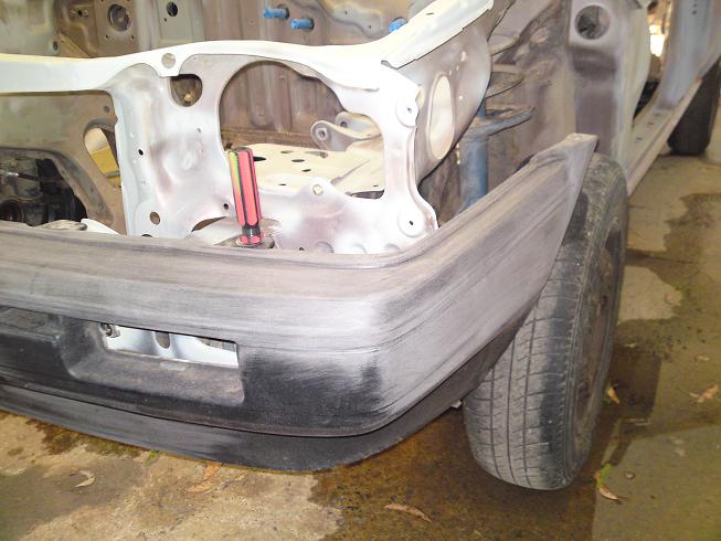

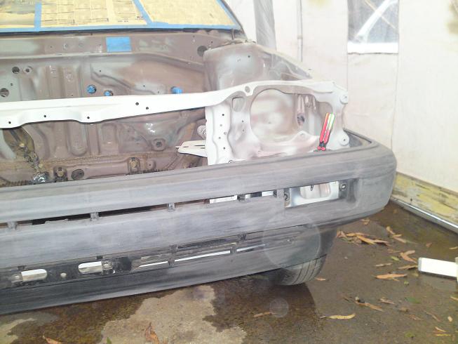

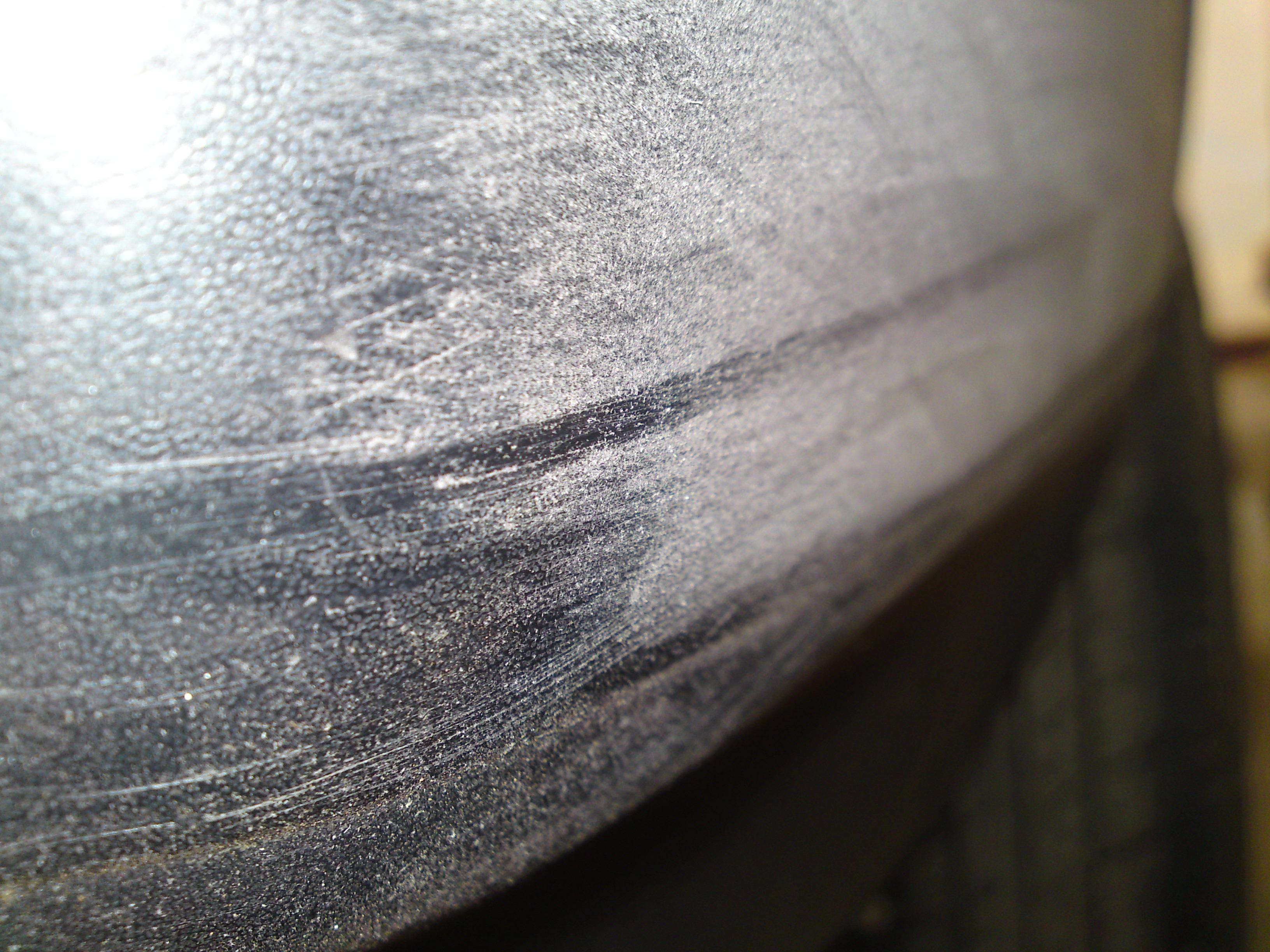

Johno Posted March 6, 2009 Author Report Posted March 6, 2009 (edited) This weekend might be the weekend where I paint the whole car with 2 pack primer, :cool: Got the rear and front bumpers sanded this week. The rear bumper was very easy to sand because it was painted before so all i had to do was give it a quick sand (1hour) but the front was about 6 hours because it has never been painted and it has that goose-bump texture all over it. I started with 180 then went 120 then thought f@$k it and went 80 and ripped it all off. Its still got a bit of texture on there but the undercoat should fill it up a bit. Anyway.. just waiting for the weather to get above 20c. Its been about 15 all week up here in the hills. Sunday is going to be 23 and Monday 26 so long weekend here we come! Reduced quality upclose of bumper. Will only let me upload max 2mb, Image was 2.5mb As you can see with the water on the ground the weather has been shit cold and raining. Edited March 6, 2009 by Johno Quote
