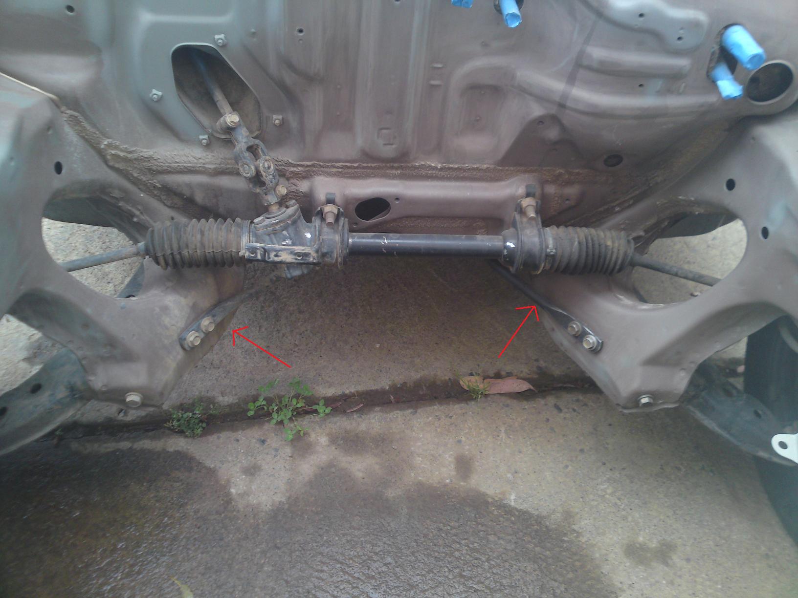

Johno Posted February 2, 2009 Author Report Posted February 2, 2009 (edited) Is it safe to remove these bars and roll the car around for painting?? Edited February 2, 2009 by Johno Quote
KE30_KE35_KE55 Posted February 2, 2009 Report Posted February 2, 2009 Is it safe to remove these bars and roll the car around for painting?? I think they are just braces so the rack does not flex, it should be fine with no weight on the front. Quote
Johno Posted February 2, 2009 Author Report Posted February 2, 2009 I think they are just braces so the rack does not flex, it should be fine with no weight on the front. Its not braces for the steering rack. Its braces for the body. I been thinking it might be a small sway bar or something like that. Might be ok to take off, I just don't want to crack welds when i take it on the trailer and the bumps cause the car to twist. I might be over cautious but just want to make sure. Quote
RollaBus_4agze Posted February 5, 2009 Report Posted February 5, 2009 Why not much paint them with the car?!?! I realyl don't think it will hurt man... I had mine out for at least 10months (car wa sjust sitting tho) and no twisting happened! Quote
Bowler Posted February 5, 2009 Report Posted February 5, 2009 so long as you don't have 2 fat bastards sitting on opposing corners, jumping up and down, i think you'll be alright. these cars are built such that the steel is no-where near the yeild stress, thus they're still within their elastic limits. even if you did get some sort of load on a corner, as there is no weight from the engine, the chassis will be fine. and you also need to consider the forces involved with fanging this car around the corners near your joint - the chassis is designed to take it. take them off, you'll be alright. Quote
towe001 Posted February 6, 2009 Report Posted February 6, 2009 Their a brace to stop the control arms from flexing under cornering etc. More or less work in the same fashion as a strut brace on the struts or a rear wheel drive cross member with its control arms. If your just going to be pushing the body around the yard i can't really see any problems with taking it off. When you fit them back up make sure the car is on level ground and fit up the ends on the firewall first then the where the control arms are, then tighten them all. From memory Whiteline has a brace that fits between the arms Quote

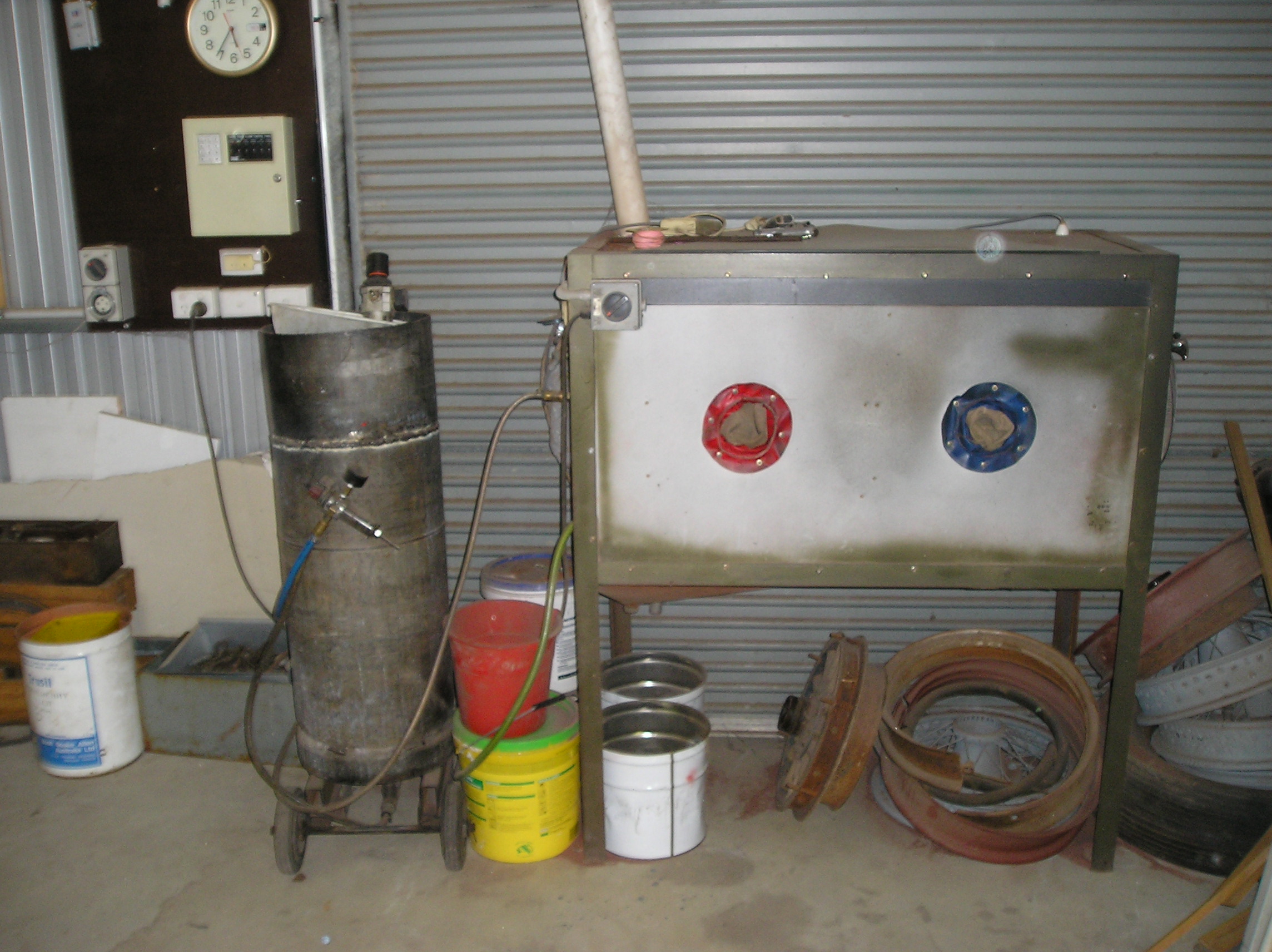

KE30_KE35_KE55 Posted February 10, 2009 Report Posted February 10, 2009 Ever considered building a blasting cabinet? I have built one. it is agricultural but works OK. Quote
