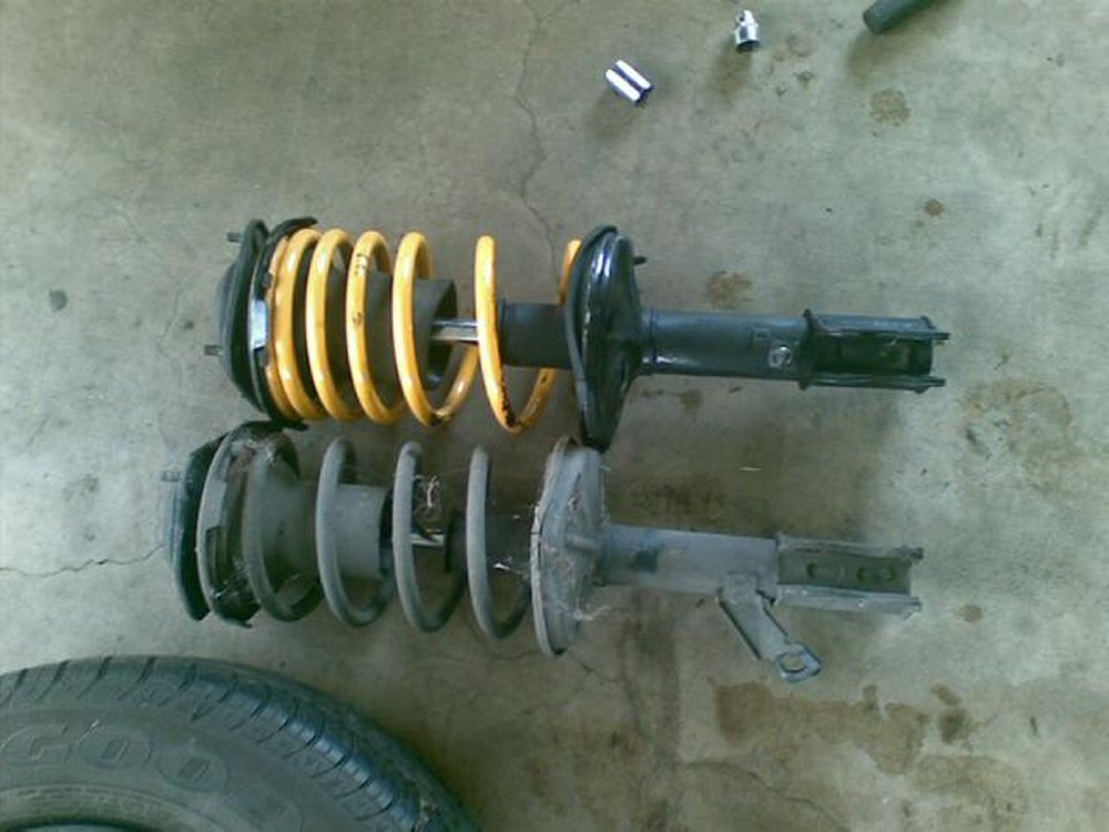

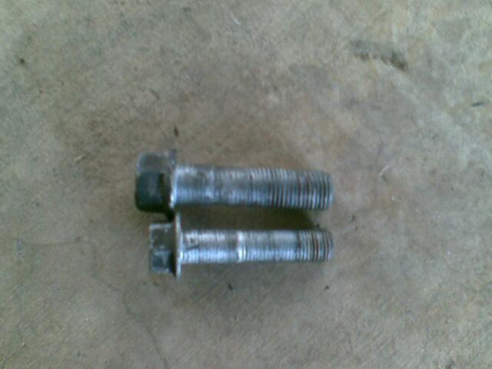

Trev Posted December 11, 2008 Report Posted December 11, 2008 (edited) There is a difference between single cam and twincam front struts/hubs, The hole sizes are different, Here are a few pics i took. The twincam bolt is the top one, To run twincam hubs i'd advise to use the twincam ctrut otherwise the bolts slops on the strut. EDIT: Pics not working. Edited December 11, 2008 by Trev Quote
200Boy Posted December 11, 2008 Report Posted December 11, 2008 Well I ran twincam struts in my singlecam seca. Didn't notice any difference in fitting apart from the strut tops on the twincams are 4 stud instead of 3 :D Also none of those pics work for me. Quote
Trev Posted December 11, 2008 Report Posted December 11, 2008 Well I ran twincam struts in my singlecam seca. Didn't notice any difference in fitting apart from the strut tops on the twincams are 4 stud instead of 3 :D Also none of those pics work for me. Trust me they are different, Here are the pics again: Twincam ones are alot bigger. Quote

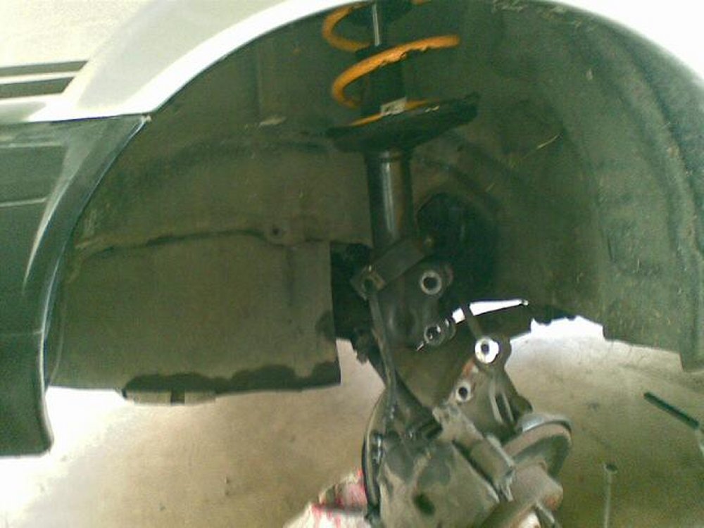

Johno Posted December 11, 2008 Author Report Posted December 11, 2008 (edited) As bowler said, I want to put sx springs in and maybe koni's. Not too sure about the gearbox, I been thinking that the 4ac and 4age gearbox might be the same ratio's. My 4ac when it was running went to about 30km/h in 1st, 4age goes to 40km/h in first. The reason that the 4age goes faster in 1st is because the engine rev's to 7.5k instead of 6k rpm. Thats my theory anyway :) Bit of an update: Cleaned both engines with the new Karchar pressure washer that i just bought. Removed the aircon, power steering pump, starter motor, thermostat and few other bits off the 4age, getting ready to swap the gearbox's over. Been busy tonight body deadening the car. I painted bitumen paint over the floor and internal panels on the car then sticking dyno mat everywhere. Its not really dyno mat but looks like the stuff and works the same. It cost me $112 for 10 meters by 220mm roll. I'm saving as much as i can to pay for the spray painting. Especially around this time of year when i still have to buy Crissy presents and go away on a holiday with a group of mates, and i don't get paid for holidays cos I'm a sub contractor. I have also been painting bits and pieces on the engine. Heat reflectors, engine mounts, brackets and thermostat. I want to paint the cam covers the same colour as the body colour. Here's a few random pics of stuff i been doing. Boot before sound deadening Black Bituman paint Dyno Mat stuff (bunnings style) lol. :D Nissan X trail sandy colour, The colour i picked to paint my car Oily 4age Clean 4age, just after pressure washing Engine mounts (4ac ones are painted) Chromed up the bolts 4age vs 4ac Edited December 11, 2008 by Johno Quote
