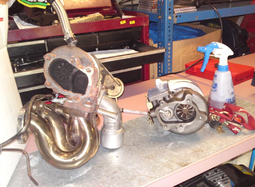

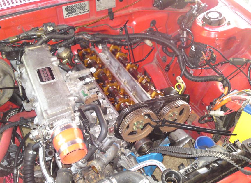

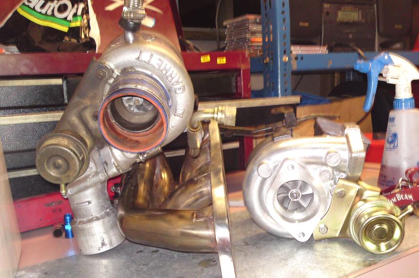

redae71 Posted December 17, 2008 Author Report Posted December 17, 2008 well shes off the road for a while again, head gasket is leaking oil and I'm puttin my new turbo on and gettin the injectors cleaned... and new injector plug wiring.... new turbo is heaps bigger! pics below Quote
Taz_Rx Posted December 18, 2008 Report Posted December 18, 2008 Keep us posted on how long the new turbo lasts. Did you ever question the low purchase price for a "brand new turbo"? Quote
redae71 Posted December 19, 2008 Author Report Posted December 19, 2008 Keep us posted on how long the new turbo lasts.Did you ever question the low purchase price for a "brand new turbo"? yeh, will do... i did question the price definitely, i had to rotate the bearing housing 180 degrees to make the oil drain face the right way so i took the liberty of pulling both housings right off and having a look, both wheels look identical to the garett items and it looks pretty well screwed together, but then again you never know until youve driven it for a while... basically they are developed the same way hypergear ones are using parts from different manufacturers. i also was never sure about those monsta t3/t4's but i know of at least 4 people running them for the past 2 years with no problems at boost levels ranging from 9-20 psi Quote

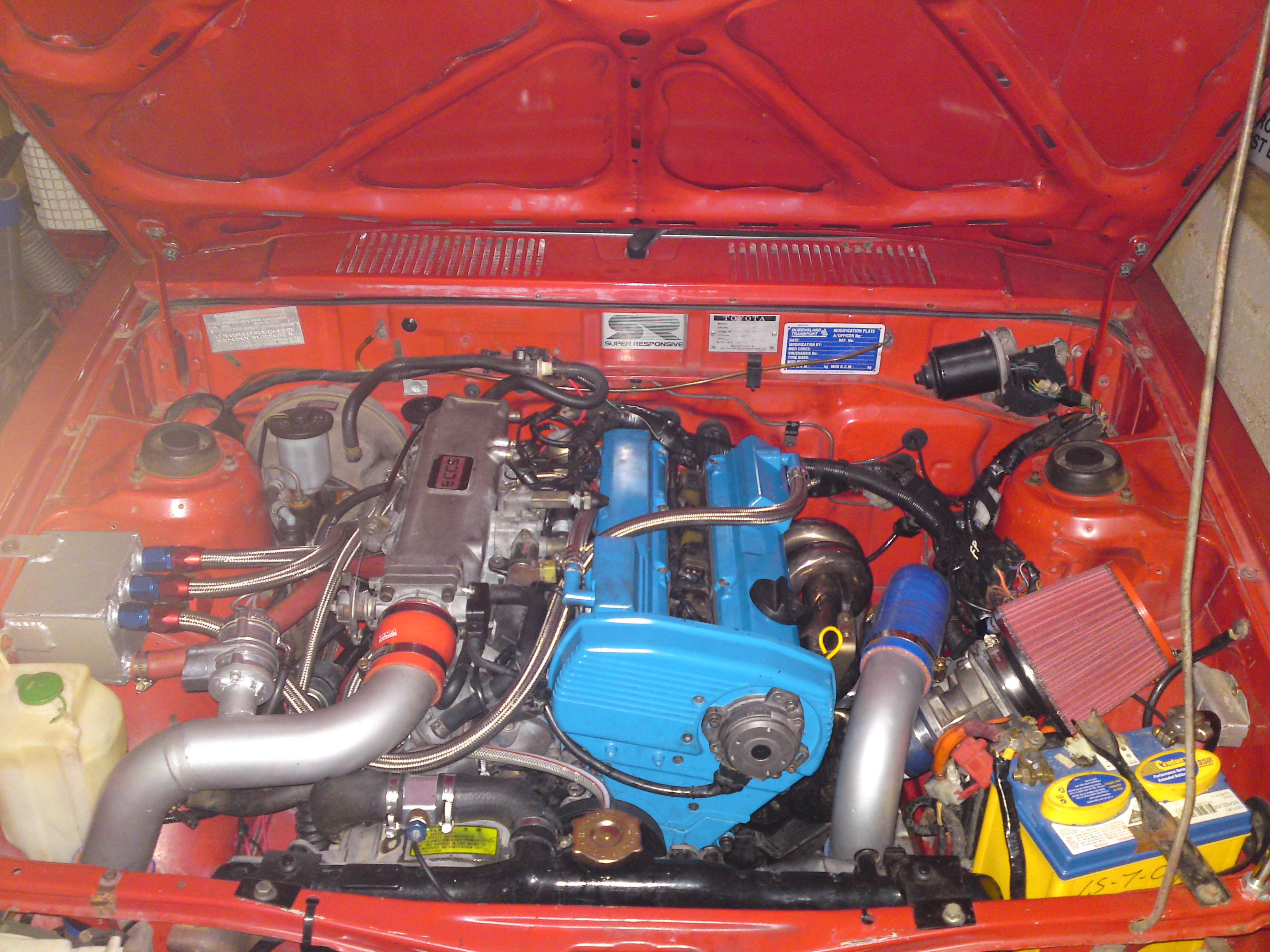

redae71 Posted February 26, 2009 Author Report Posted February 26, 2009 ok its running again with the new turbo on it, full boost at 4500 running on 12psi, slight miss when it gets hot cos of one of the coils missing the carbide tip, but it really goes better then i expected!! catch can turned out good to, goin on the dyno in the next month to get the wastegate actuator and ignition timing set properly... getting a roadworthy as we speak and registered soon :lolcry: :) heres a pic! Quote
