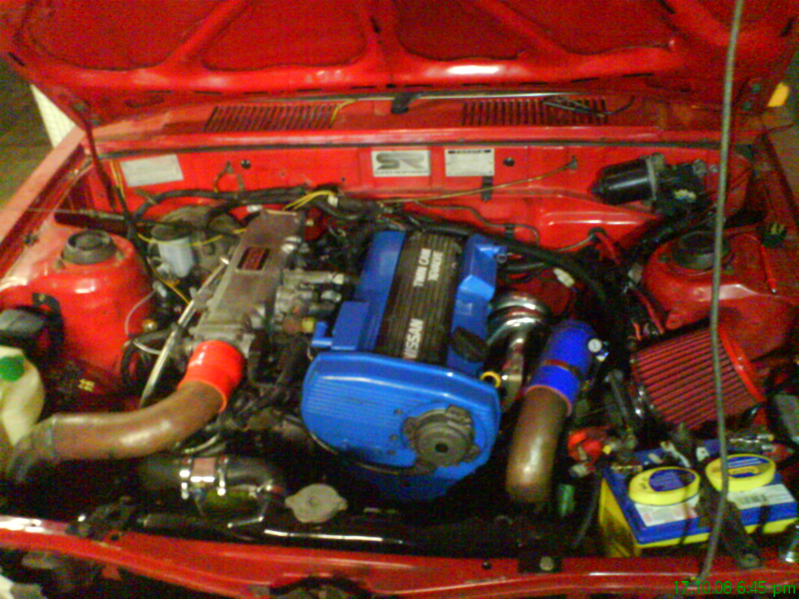

redae71 Posted August 19, 2008 Author Report Posted August 19, 2008 ok so ive now finally got a radiator and twin thermos in, i used a honda prelude radiator, got it flushed and cleaned up. it came with two wicked thermo fans that worked when i tested them. made up some brackets with bungs to hold the radiator in and it is perfect. since last reply i have fitted the dump pipe, boost controller and a fair few vacuum lines. all thats left to do now is throttle cable, clutch line, install the custom harness and fit up the rest of the exhaust... just waiting on some funds.... more pics up soon Quote

redae71 Posted December 4, 2008 Author Report Posted December 4, 2008 OK so its finnally running.... took about 30m mins to start I'm assuming due to lifters bleeding up and also injectors took a while to start workin as well, once i got it running it was missfiring so i took out all the coils and found 3 were missing the spring and carbide tip so i masacred some dizzy caps and problem solvered :yes: exhaust is now on il post a video up if i can figure out how, the video is of the first time it ran well with only the split dump pipe on. anyway any questions or comments appreciated.... also if anyone has a t25 or t28 i need one cos mine is frikkin loud as, lol bearings are fingered, anyway enjoy! Quote

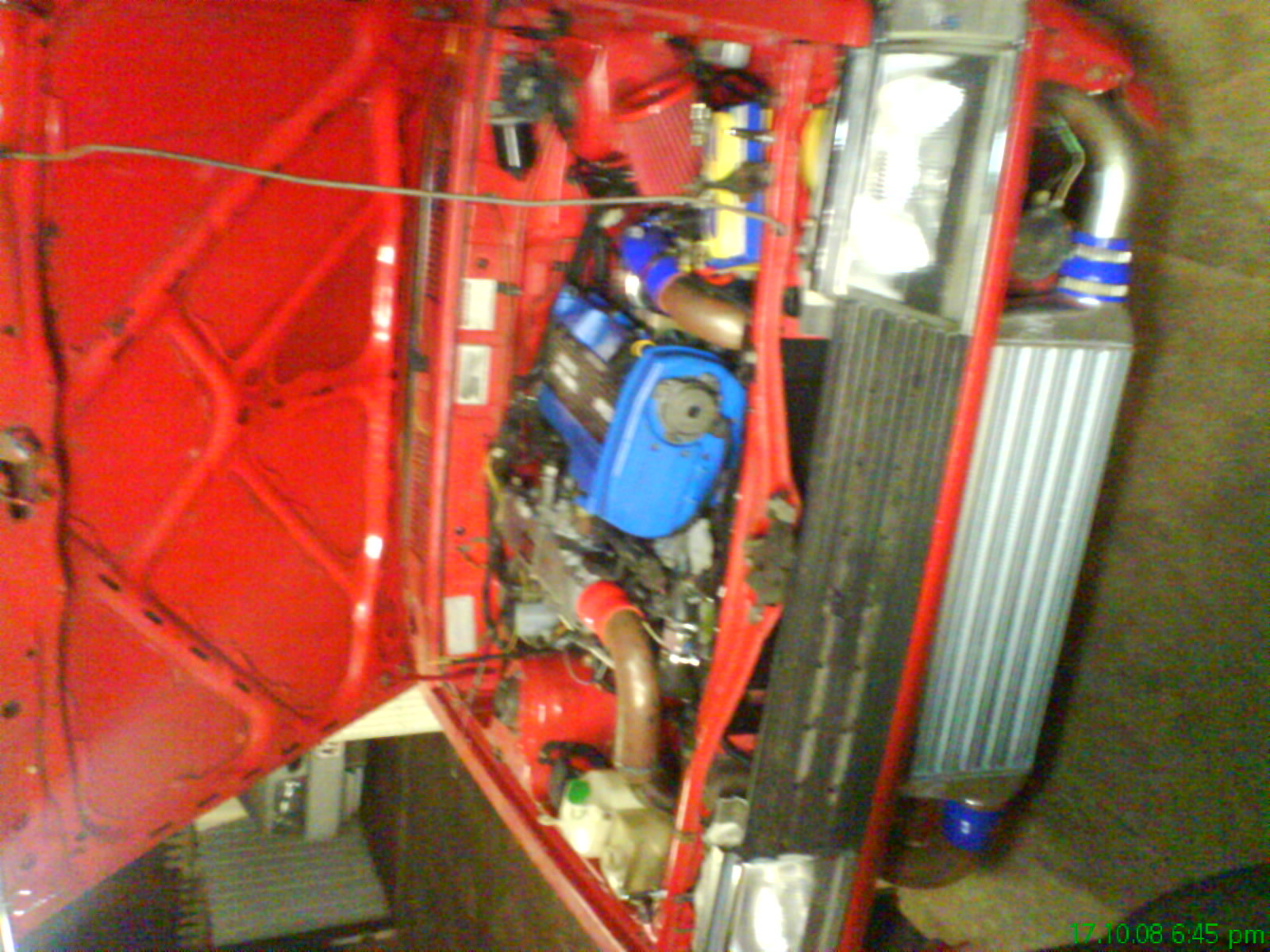

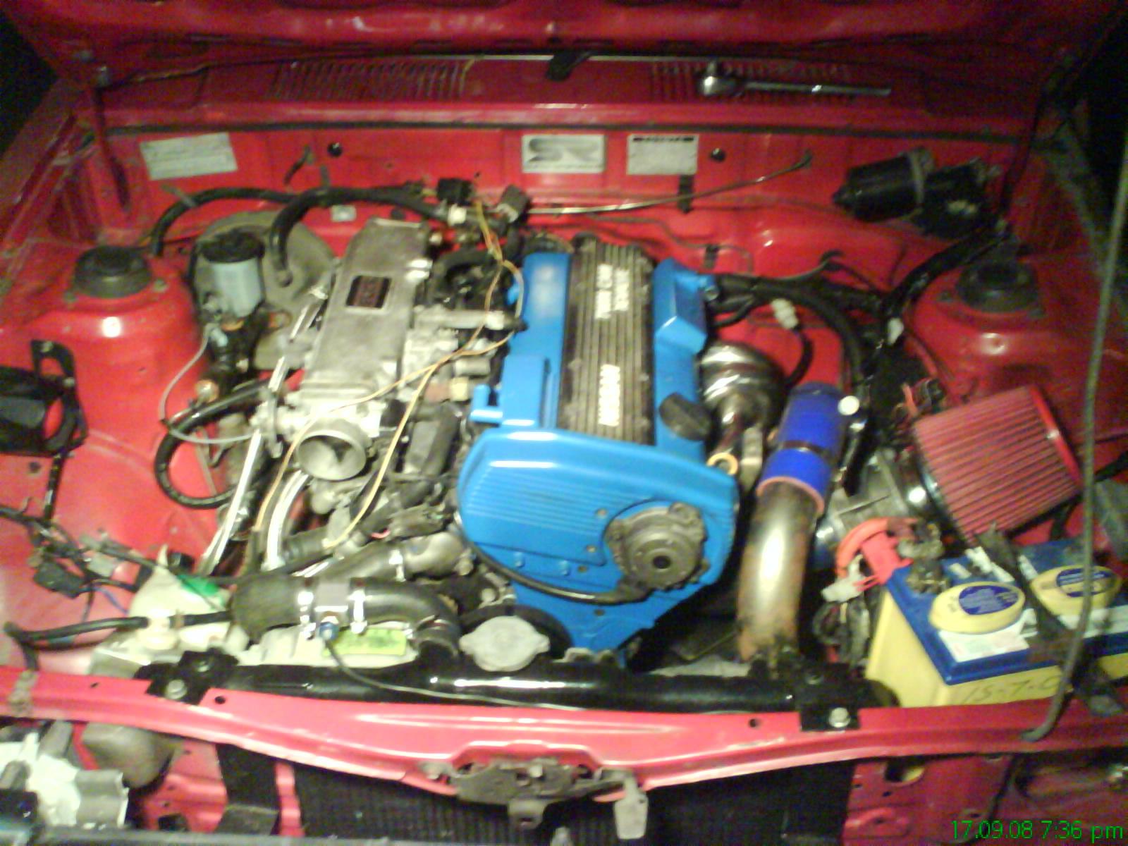

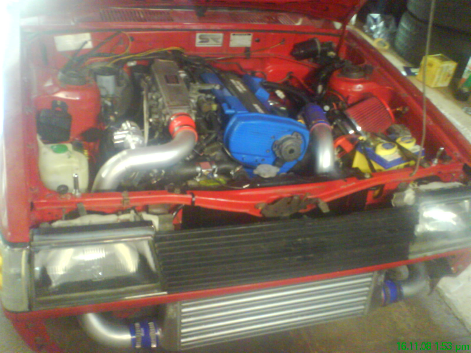

redae71 Posted December 5, 2008 Author Report Posted December 5, 2008 sorry computer f@$ked out last night here is the rest of the pics, video wont work Quote
