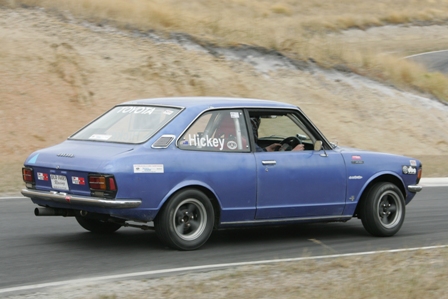

ausca62 Posted May 16, 2009 Report Posted May 16, 2009 soundpimp said: Second photo, third car back is a yellow KE30 sports sedan. Pretty quick car that one! The car owner is a rollaclub member. Quote
