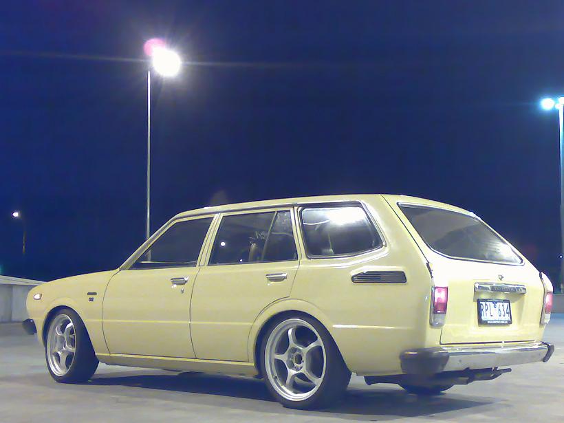

TE278U Posted May 7, 2008 Report Posted May 7, 2008 Shizotimang said: that and 15's should be a maximum on a ke70!not just legally but there an 80's car, go with 80's jap styleing 14's even better! with close to 0 offset :hmm: yeah, cause i f_ing hate this look...... 17 x 7j +42 offset (20mm bolt on hub adapter converts from 4x114.3 to 4x100) 205/40/17 tyres. never rubbed or scraped, and this is dumped. cut springs front, inverted leaved at rear with full length landcruiser helper spring Quote
