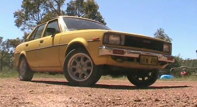

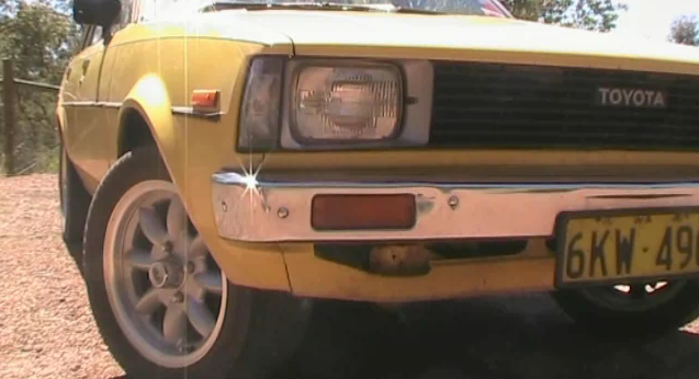

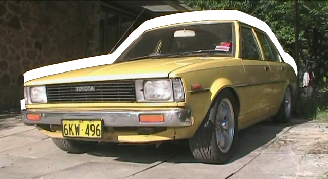

Mybowlcut Posted October 21, 2008 Author Report Posted October 21, 2008 (edited) trav_555 said: looks hot mate good on ya Travis Cheers. Roo said: get a lift kit for itHa-ha. :laff: I know, I know, it's sitting way too high... has been since the Superlites were put on. Getting RA60 struts/brakes/diff and lowering it next. Haha... ignore the white bits... Edited October 21, 2008 by Mybowlcut Quote

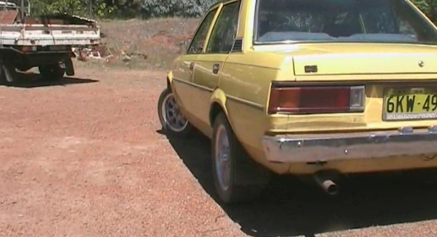

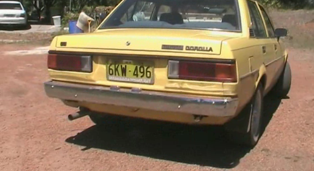

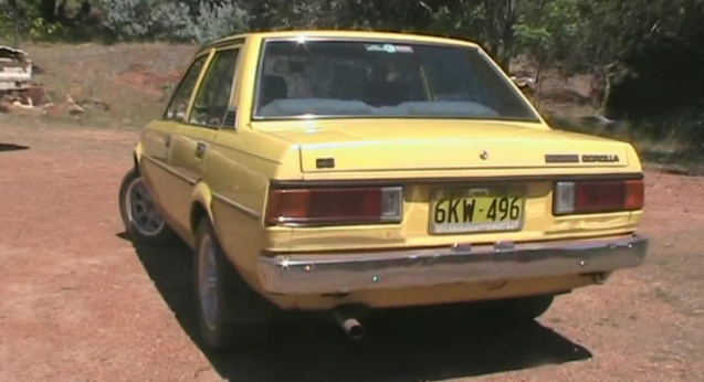

Mybowlcut Posted November 1, 2008 Author Report Posted November 1, 2008 Back bumper is now on thanks to Garnett and my cousin who is an awesome welder: License plate lights are not working but shouldn't be too hard to fix I guess. Quote
Mybowlcut Posted November 1, 2008 Author Report Posted November 1, 2008 Also, I took some pictures of the whole back bumper process and Garnett is going to make a How-To out of them. :jamie: Quote
