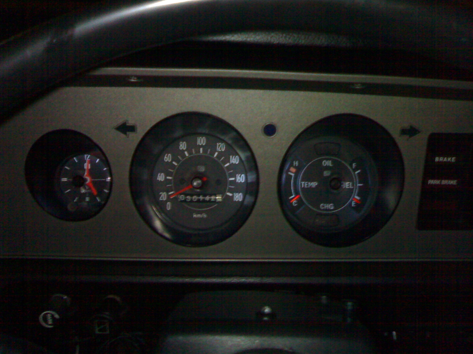

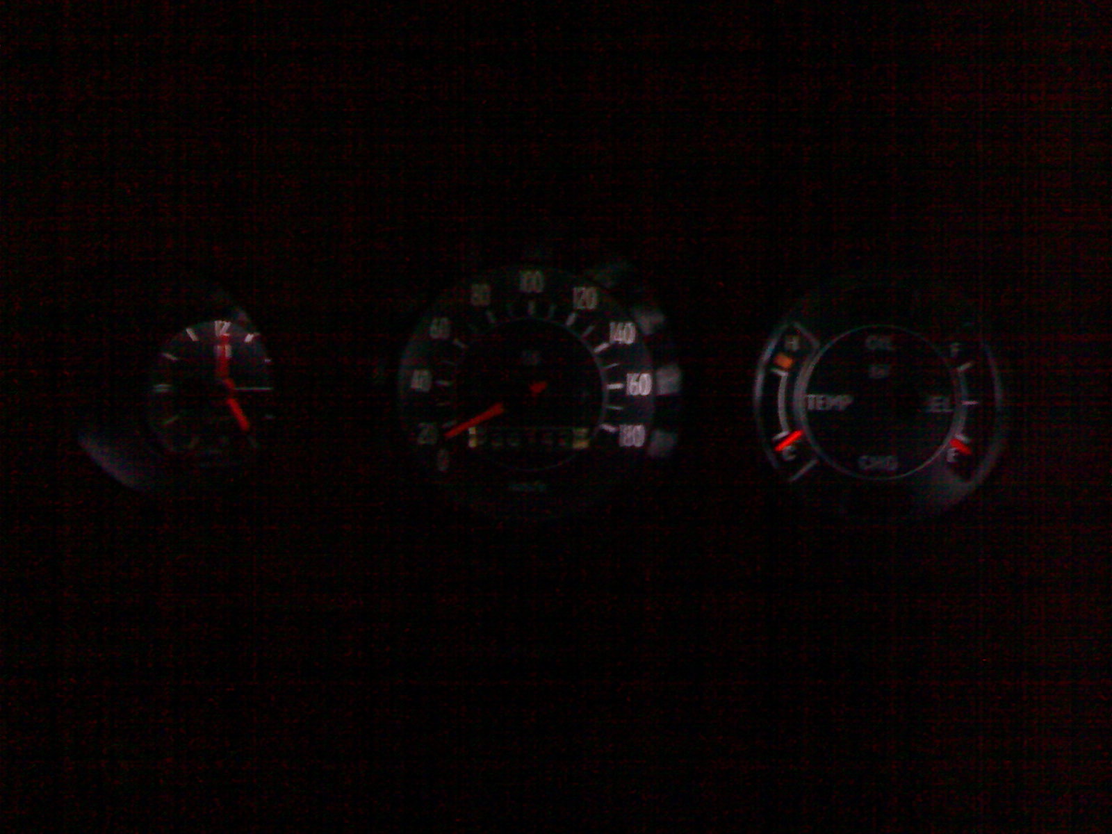

skibum Posted May 24, 2008 Report Posted May 24, 2008 Been looking at doing this for a while. Half of the bulbs in my 86 seca were out or very faint. Replaced them all with blue LED's. Very happy with the result. They all plug into the standard bulb placements and are adjustable for brightness through the factory control. Found these ones on Ebay from a guy here in Brisbane that inhabits the Skyline Australia forums. $20 and half an hours work. Quote
