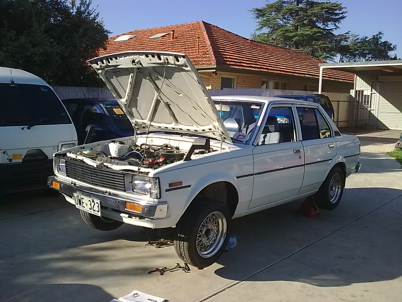

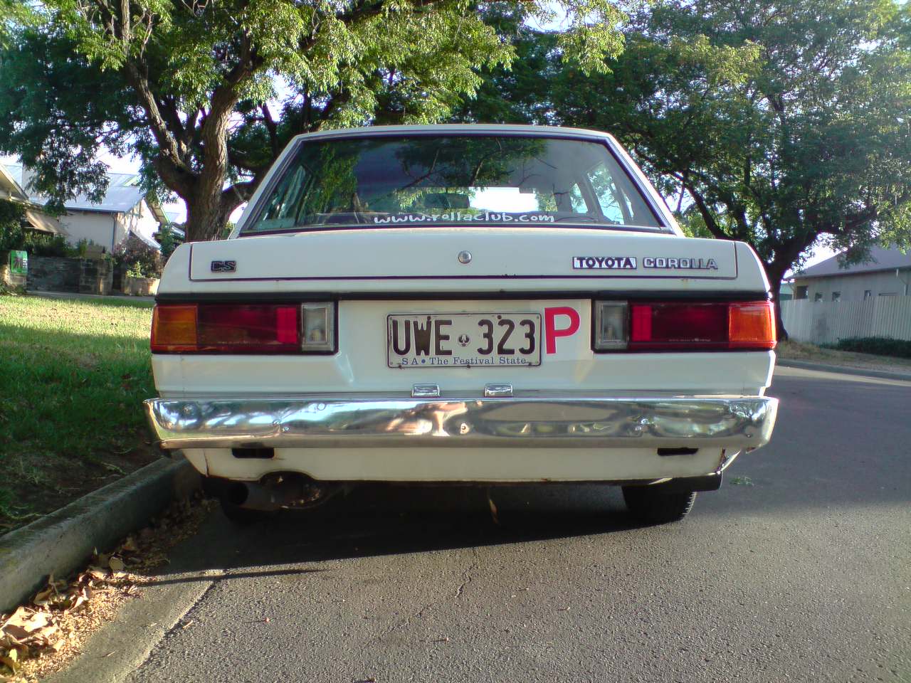

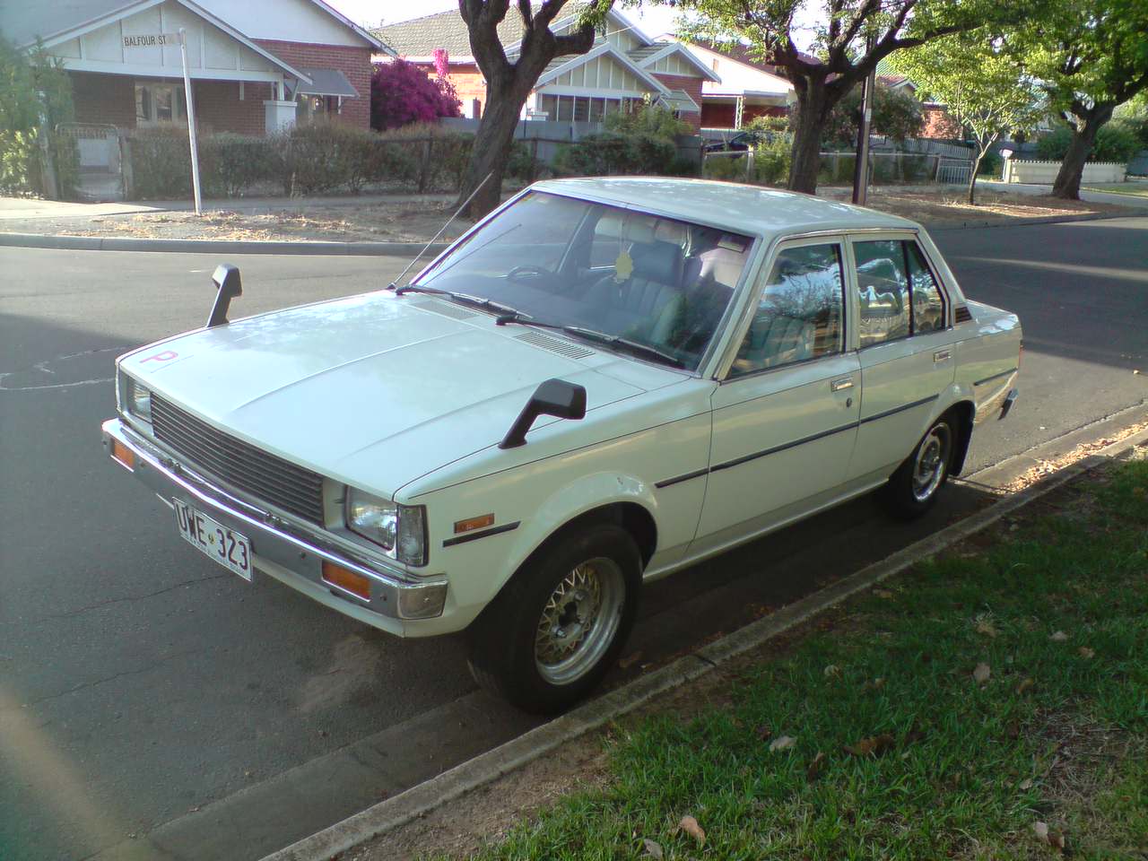

Tally Posted January 17, 2008 Report Posted January 17, 2008 (edited) Hey guys Some of you may remember that white auto KE70 that was for sale in the car trader for a few weeks. Well I ended up buying it. And yea thats pretty much it. heheh, Nah. When I got it the paint was faded and the whole car was in need of a good clean inside & out. The car itself is pretty overrated. After giving it a wash my dad suggested that I polish it up a bit to bring up the shine. After a whole day of hard work I finally got it looking like brand new. Before i got it, my uncle had a 2" e-system installed and had the head removed and replaced with a 3K head. It has cut spring all round and sits pretty nicely. I know I know, its auto, but its my first car that is ON the road hehe. Its a good cruiser. SPECS: Car: 82 CS KE70 Corolla Colour: White Engine: Stock 4K-C with 3K head Trans: Auto Interior: Blue Sound System: Stock AM/FM radio PLANS: After I get new tires for it I'm going to slap some whitewalls on it and maybe grab some venations for it. Going for that old-school look on this one hehehe. Might covert it to manual if I get time. If anyone has the parts necessary for the conversion, please PM me. And also I need two chrome trim rings as it only came with two. So yea enough chatter, here it is :D Cheers Tally Edited May 1, 2009 by Tally Quote
LittleRedSpirit Posted January 17, 2008 Report Posted January 17, 2008 Minty Fresh. Its so white, its like a celebrities' teeth. Very nice find mate, this one is so straight, it needs chrome bumpers and quads. Quote
Tally Posted January 17, 2008 Author Report Posted January 17, 2008 hehe thanks man. Yea its pretty good for its age. Was a driving instructors car. Well looked after. its not 100% with only a few things needing attention but it certainly is minty fresh :D If I sell the KE25 then I may think about using this as a project car but nothing is certain. Id get the chrome bumpers from a T-18? Those quads in the parts trader certainly were tempting but the price!!! Quote

Tally Posted January 26, 2008 Author Report Posted January 26, 2008 Hey guys Been driving around in it a fair bit lately and lovin it hehehe. Just a few questions. Ive seen a few KE70s on here with the full chrome bumpers. I assume they are from the TE72/T-18 am I right? I have seen a few of them driving around adelaide and was just wondering how easy they are to get hold of and how much they go for. I think I read that they have mounting issues when put on KE70s... Also what small/simple mods can I do to it. Would It be worth chucking on some extractors on it. Its got a 2" system already, but its auto. :) I might rip out the dash and disconnect the front speakers as they are screwed. It came with brand new speakers sitting in the back so I wanna connect them up. Any help would be much appreciated. Cheers Tally Quote
fusion Posted January 26, 2008 Report Posted January 26, 2008 Sounds like T18 bumpers, I have heard its alot easier when you have the T18 bumper brackets aswell. Get a manual before extractors I say :) And get a head unit for hooking up the speakers? Quote
TOM Posted January 27, 2008 Report Posted January 27, 2008 Nice work Tally, looks kinda like mine! Hope to seeya cruisin around Radelaide soon! As for the chrome wheel trims, Just wrecking Toyota's at Wingfield have a whole rack of chrome trims with at least 6-10 immaculate KE70 ones - i bought a couple last week, and i mean overrated with no gutter rash at all! I also met a guy at U-Pull-It at Elizabeth who is building a supercharged 4K KE70 with tricked up standard auto trans, tried to convince him to join rollaclub and show us his work which hopefully he will do... Cheers, Tom Quote

Tally Posted December 28, 2008 Author Report Posted December 28, 2008 ok so............... whats new with this car???? alot really lol... well ill try to sum it all up: Fitted fender mirrors Fitted T-18 bars Fitted tacho dash Fitted front rims General maintanence Fitted CD player Bought parts car, doing 5speed manual convo... Got my AE86 strut convo nearing completion and installation and yea few other things... So guys I have a few questions that I havnt had any luck getting answers to on AE86DC... 1. Machining brake rotors? How much and whos good to get em done in Adelaide? 2. Good brake pads for ADM AE86 Calipers? 3. Any idea if I can get like some sort of rebuild kit for a K50? or replacement rubbers or a shift rebuild kit... 4. lightening my flywheel? How much and whos good to get it done in Adelaide? 5. My KE70 5spds would be 19 spline? 6. Where to get spigot bearing? Cheers Tally Quote

Tally Posted May 1, 2009 Author Report Posted May 1, 2009 (edited) Quick update as havnt updated for a while. Engine got fixed few months back. Running sweet as now... Got new Bridgestone Adrenalin Potenza RE001 tires 185/60/R14 and Converted the car to manual using my KE70 parts car that I had, now at the dump (RIP). Also chucked in rear suspension 4kg ###### springs and KYB Excel-G shocks. Front going to be done soon with AE86 struts, 6KG springs, brand new pads and rotors. Getting it done by Nat at Tyrepower North East Rd. Should be good for hills thrash after that... although I might get a cam and chuck on my twin SU carbs as it struggles alot up hills... darn 4Ks lol! Cheers Tally Edited May 1, 2009 by Tally Quote
