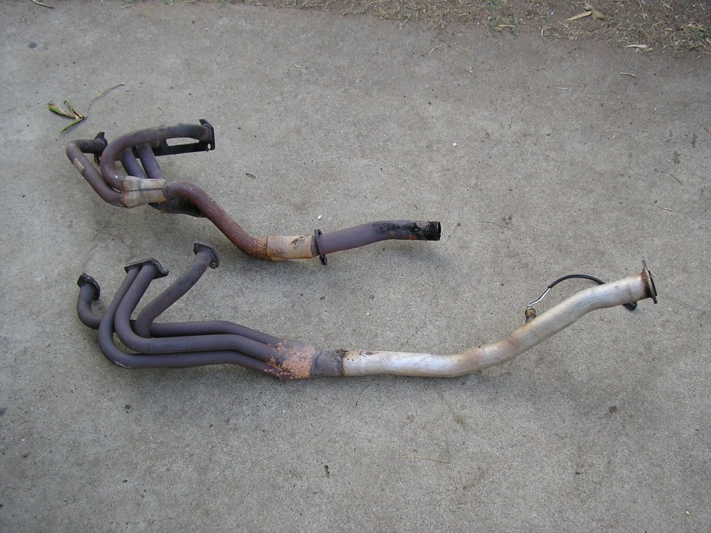

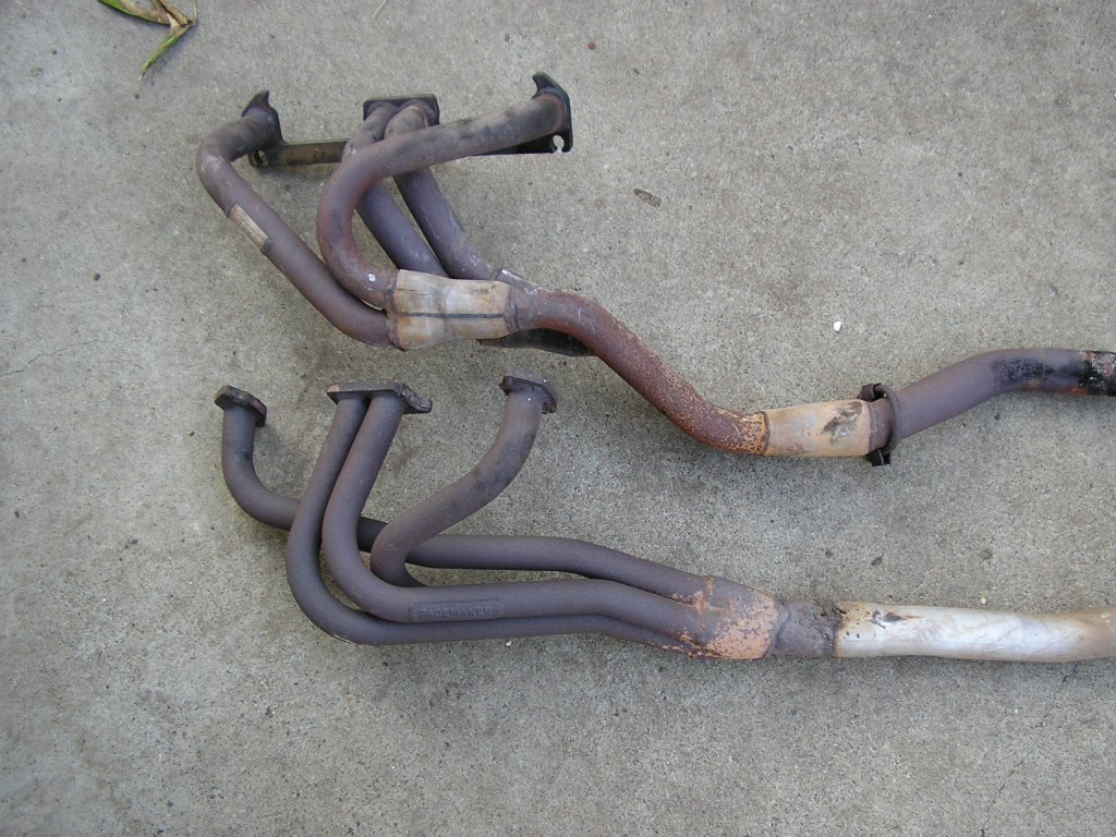

Felix Posted January 8, 2008 Report Posted January 8, 2008 Felix, was that you that mentioned in another post you had some Perry headers? These are pretty good price from what i see on their website. How do you rate them? And how nice do they fit? Actually I worked out that the extractors in my ke16 are not Perry's. Not sure what they are as the metal brand tag has fallen off at some stage. They are a small tube 4-1 design, and fit the car a lot easier than pacemakers. I can't quite remember what the previous owner said they were... Hurricane comes to mind, but I'm not 100% sure. Looking through some pics on my computer I found some of my spare extractors which are earmarked for a ke10 I have stored at the mother-in-laws. They are 4-2-1 Perry's, which came off a mates ke20 club car. They look like they would fit a ke1x easier than 4-1 extractors as they are less bulky around the collector. The pipe would need to be cut just after the collector and rerouted to suit the ke1x. Pic attached compared to pacemakers. I can't comment on fitment of twin sidedrafts with extractors. I run a downdraft 28/36 DCD weber, which is by far the best allround performance/economy solution for a street K motor. Just as tunable as sidies having changable venturis, but with even better flexibility, drivability (once warm) and economy than a stock carb. Quote

Felix Posted January 9, 2008 Report Posted January 9, 2008 (edited) Sorry philbey, I'm going to hang onto them. I posted pics of them as I thought they were similar to the ones you were talking about from Perry, but it appears they are not after looking at their website. The ones on the HM header/Perry website look more like the 4-1's that I have on my ke16. snot35, if you can find a decent carb shop, you shouldn't have too many problems finding jets for tuning. The only hard parts to find really are the venturis, though you can get them on ebay if you look and don't mind bringing them from overseas. I am running the factory settings for a Mk1 1500 GT cortina on my warm 5k atm. You can find the base jetting here. On a 4k ideally you want to run smaller venturis and jet to suit, as every combo is different. If I can find my little book I'll get you the jetting I used on my old 4k. Edited January 9, 2008 by Felix Quote
