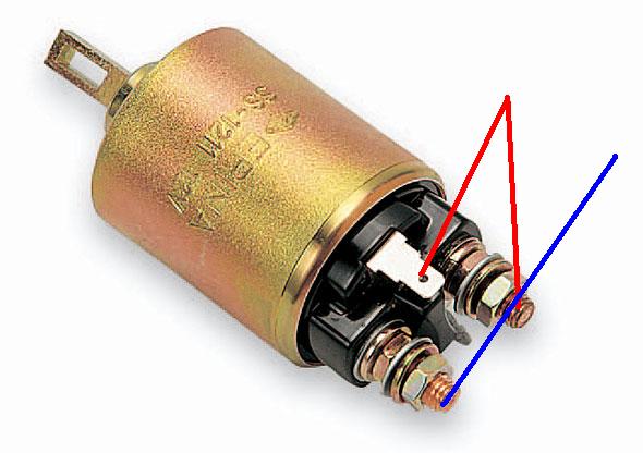

KE30_KE35_KE55 Posted December 18, 2007 Report Posted December 18, 2007 (edited) The way you can see if it is brushes causing the problem, get someone to hold the ignition on crank and hit the back of the starter where the brushes are and if it starts to spin away you know it is brushes. (Worn brushes are not letting power get through to the armature or from the armature to ground). Â could i suggest you try to diagnose the problem with a test light first before hitting the starter with a hammer. hitting the starter with a hammer could , 1 free a solenoid, 2 free short brushes, or 3 even bridge a loose connection. if it starts working you still don't know what is wrong. Â short the two terminals marked red put a test light to a good earth and test if there is power at the blue terminal. if there is power and the starter is not turning there is a problem with the motor. if there is no power at the blue terminal fit a solenoid kit. Â Edited December 18, 2007 by KE30_KE35_KE55 Quote

Medicine_Man Posted December 18, 2007 Report Posted December 18, 2007 could i suggest you try to diagnose the problem with a test light first before hitting the starter with a hammer. hitting the starter with a hammer could ,1 free a solenoid, 2 free short brushes, or 3 even bridge a loose connection. if it starts working you still don't know what is wrong. Â short the two terminals marked red put a test light to a good earth and test if there is power at the blue terminal. if there is power and the starter is not turning there is a problem with the motor. if there is no power at the blue terminal fit a solenoid kit. Â Â Of course you test it with a test light first, Check you have a 12v signal and also that there is 12v at the main post on the starter. Once you have done that and they are OK, If it still fails to motor then you can try what I mentioned previously. You could even go to the extent to take the wire off to the field housing and power it up with 12v too (If it still fails to motor then that is another good sign the brushes/armature are causing the fault). I must say that in 12 months of doing auto electrics, I have never seen a solenoid "free" by hitting it with a hammer, Nor bridge loose connections.. It is all about tracing the path of the circuit, I beg to disagree with you still not knowing what is wrong by the time you have hit it with a hammer if it is indeed brushes (mabey even armature) You would know where the fault lies. The solenoid feeds power to the field coils and brings the drive into mesh/holds it in mesh, it doesn't have any other function that would stop the motor spinning. Â Â I thought he had found the problem? Bought the bits and was happily on his way, maybe he will reply soon and this thread can be wound up. Â He has found the problem, But we are still on topic discussing how to diagnose the fault. Quote
