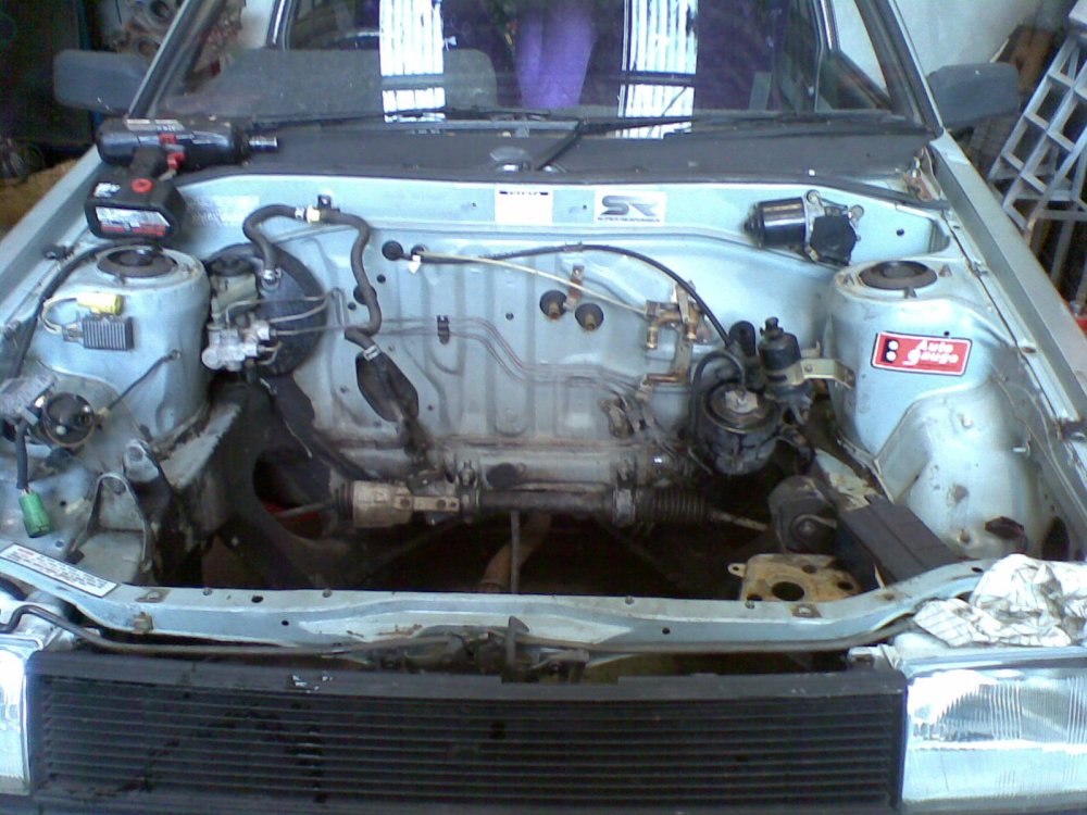

Trev Posted July 13, 2010 Author Report Posted July 13, 2010 Johno said: Good work mate, sounds like alot of work, so how did you get a LSD diff? I didn't, I think that the diff just torque locks or it is broken, it only started doing doubles when I put the GE in it. Quote

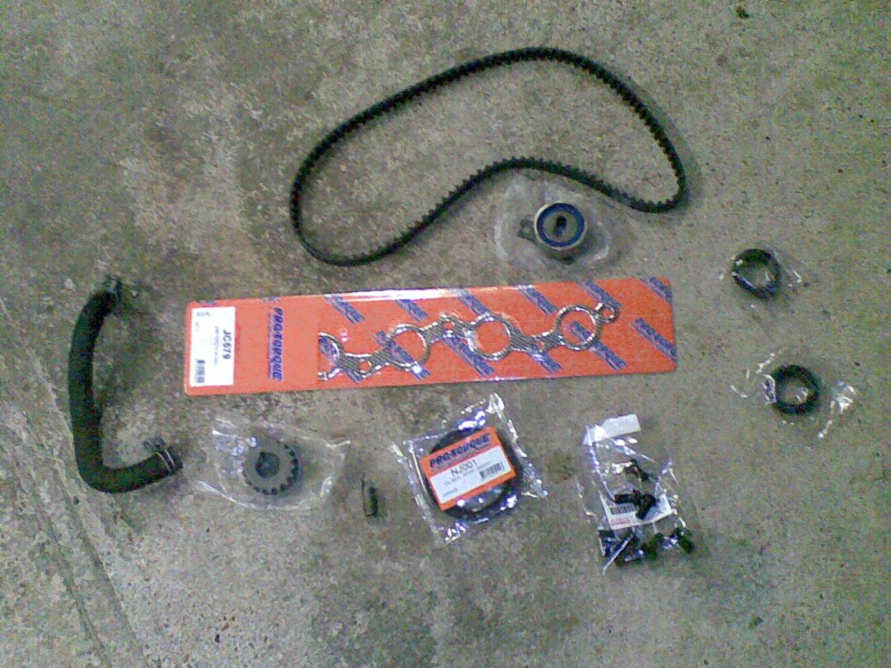

Trev Posted July 21, 2010 Author Report Posted July 21, 2010 Parts are all ready for a late 300k service and tidy up, just gotta get an oil filter. Exhaust gasket, timing belt kit (belt, crank seal & tensioner), cam seals, rear crank seal, brand new crank gear incase the other needs to be broken off, brand new flex plate bolts, a 2nd hand heater hose and the spring I took off the tensioner when I put the engine in. (sorry bout crap phone photo, camera has diarrhoea) Quote

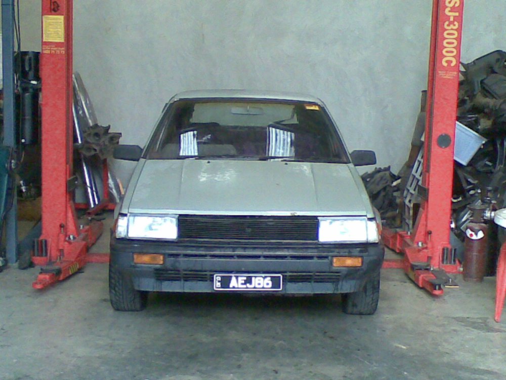

Trev Posted July 31, 2010 Author Report Posted July 31, 2010 (edited) Drove the car onto the hoist at 10:10 1hr later was pumped until I stopped for lunch and talked shit for a while and then I got tired as hell started to stuff ass about (wish I had not), only hiccup of the day was the supplied front crank seal was wrong so I got one from aussie auto. Was good to fix the issues it had and to have a heater again, ended up driving it out of the workshop at 8pm. Edited July 31, 2010 by Trev Quote

ae824ate Posted August 19, 2010 Report Posted August 19, 2010 Hi trev, could you tell me roughly how much your crank timing gear was? Cos i sorta broke mine getting it off :D Thanks, Luke. Quote
Trev Posted August 19, 2010 Author Report Posted August 19, 2010 ae824ate said: Hi trev, could you tell me roughly how much your crank timing gear was? Cos i sorta broke mine getting it off :D Thanks, Luke. I think it was $37, do you have the part number? Quote
ae824ate Posted August 19, 2010 Report Posted August 19, 2010 Yeah, ive got a downloaded workshop manual with all toyota part numbers. was yours a genuine part? Quote
Trev Posted August 19, 2010 Author Report Posted August 19, 2010 ae824ate said: Yeah, ive got a downloaded workshop manual with all toyota part numbers. was yours a genuine part? Yeah it was, have not seen them as an aftermarket part, I got it from road and track. Quote
