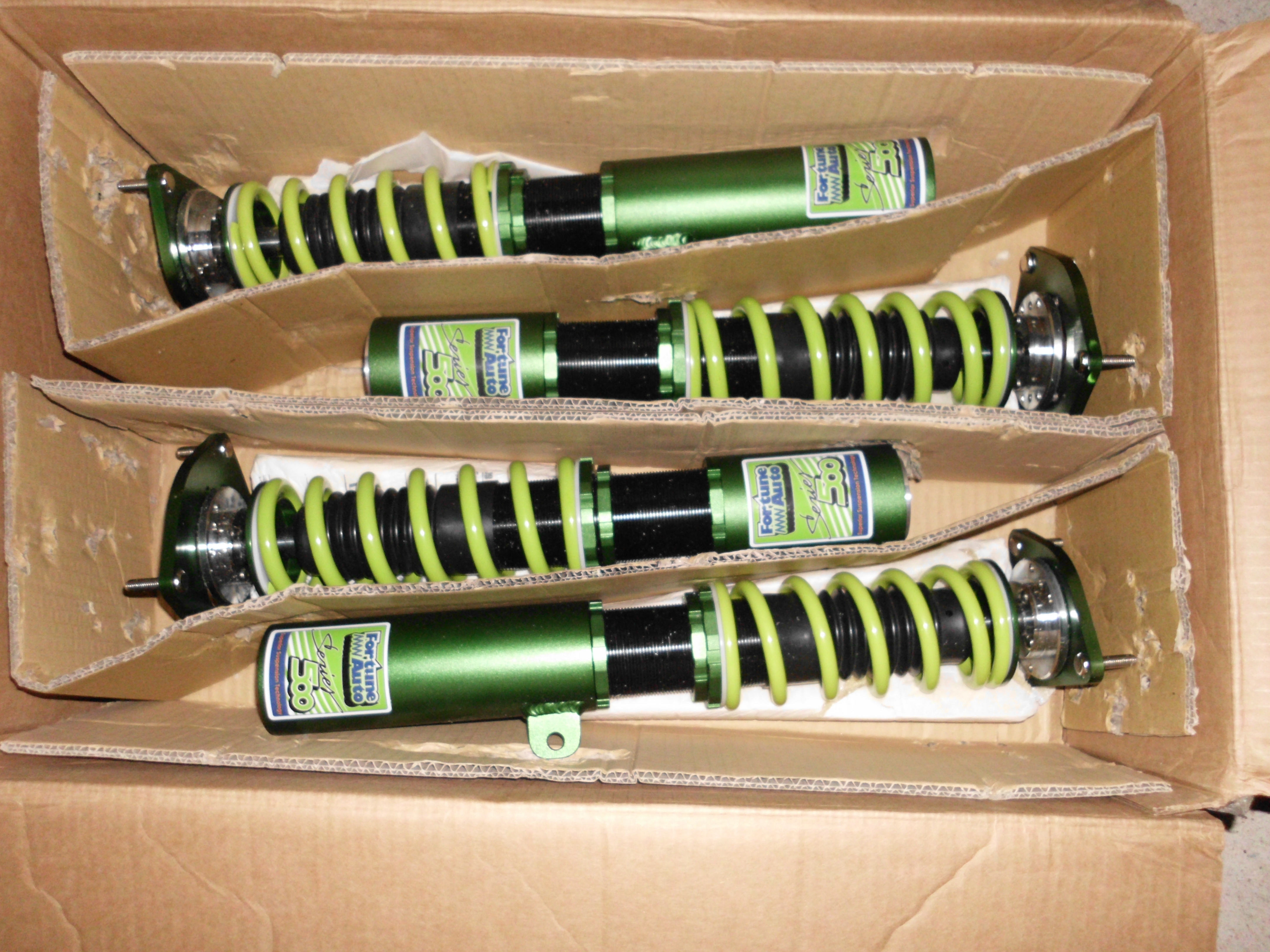

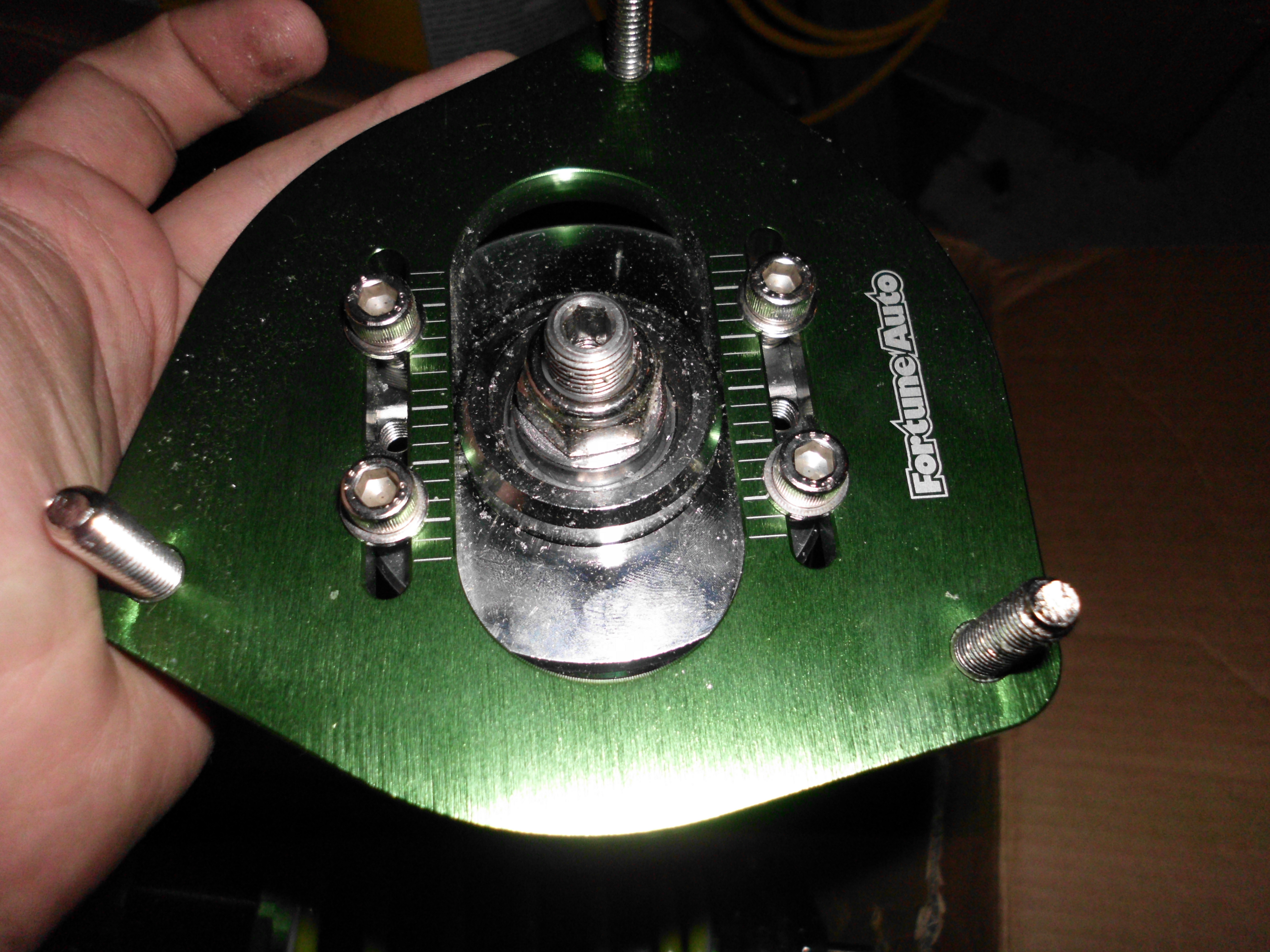

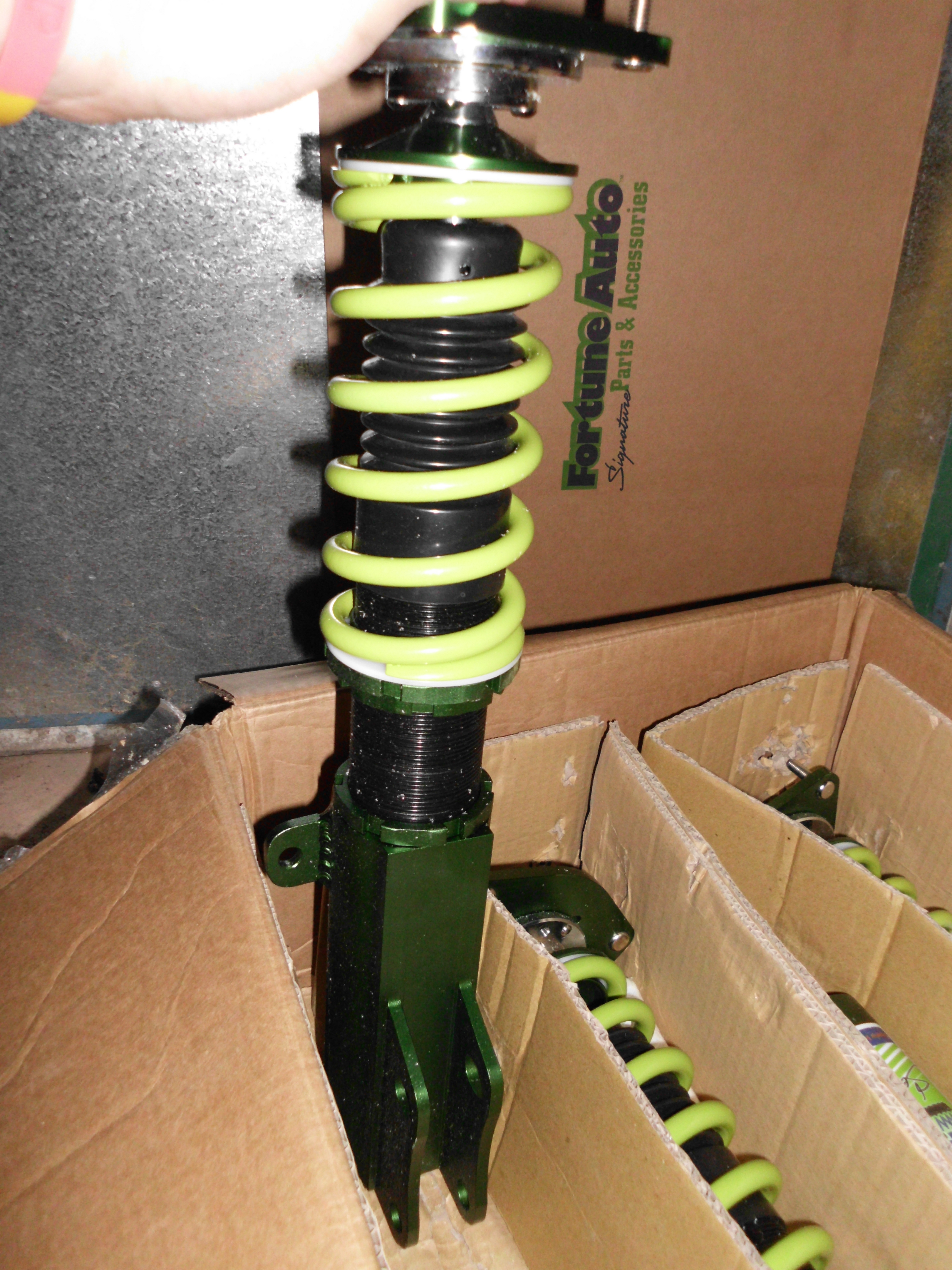

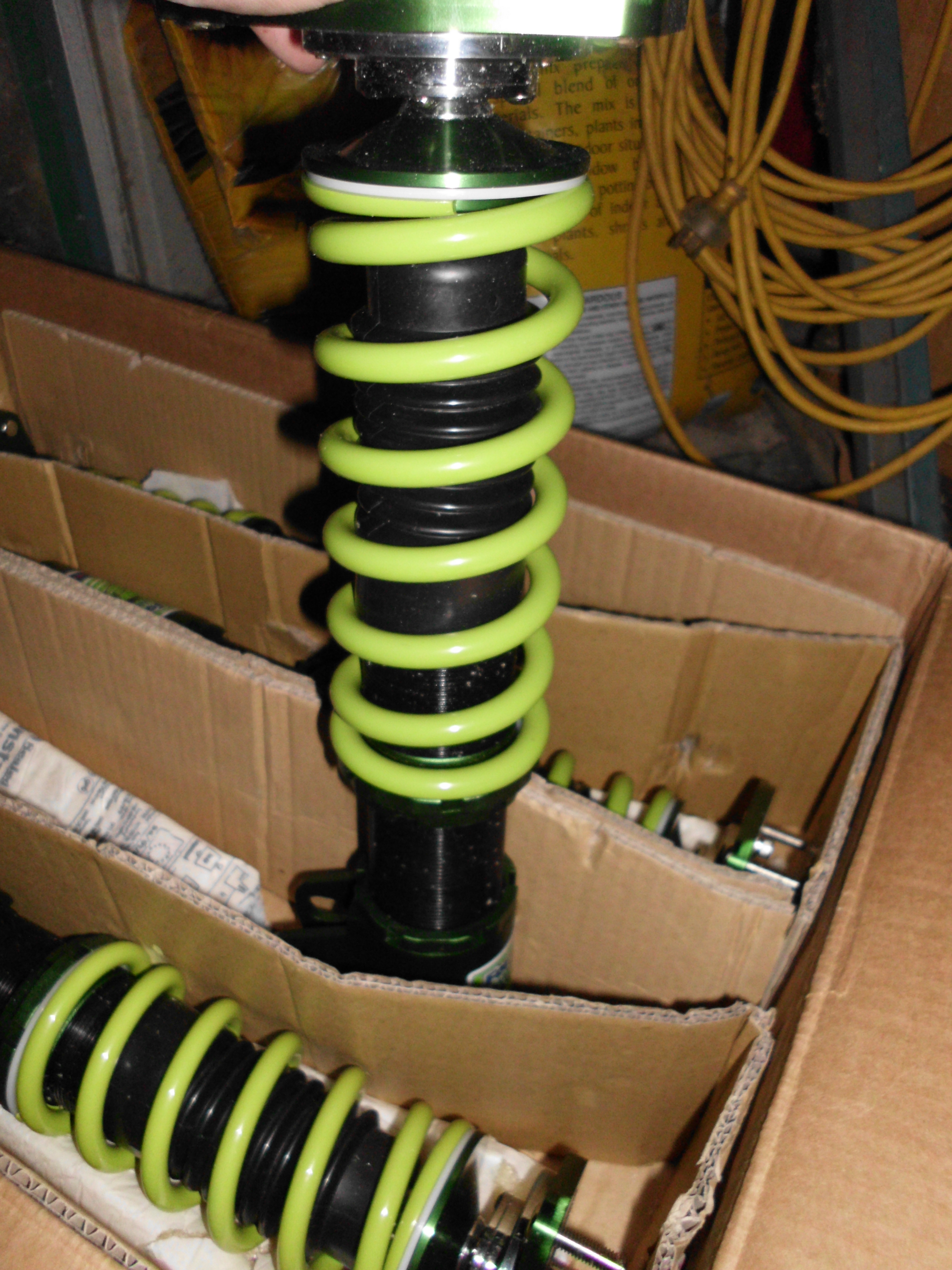

MYSTIK[RL] Posted March 21, 2012 Author Report Posted March 21, 2012 (edited) ok so i didnt have to mod a GE dizzy, just pulled the guts out of one and put it into the GZE CAS, same same really, last i heard on friday was the real tuning was about to begin. one bad thing though i was told there is a small amount of oil smoke at idle, so me thinks the oil seals in the turbo may be on the way out :| but its not critical at the moment, so i will either be rebuilding or going to a t28 at a later date. also some more new parts lobbed at my place yesterday in the form of the adjustable coilovers. will let pics do the talking slime green anyone? camber tops front back then really need to purchase some polyurethane bushes and get them installed at the same time. :P Edited March 21, 2012 by MYSTIK Quote

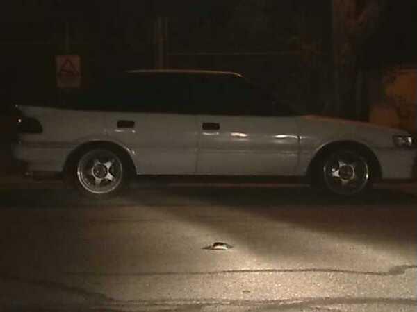

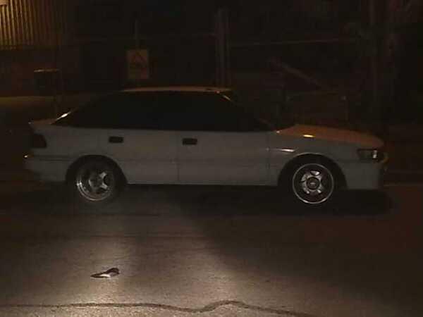

MYSTIK[RL] Posted June 15, 2012 Author Report Posted June 15, 2012 Ok, small update, injectors, fuel pump, bushes, and coilovers all in. Exhaust, wheel alignment and tune monday and a couple of crappy phone pics of what is possibly the final ride height yes i know crappy phone pics at night, i promise i will get some better ones once i get it back home so the injector issue i was having is now sorted, and the cold start tune will be alot nicer plus i wont have to let the car idle until it gets up to temp. Quote
