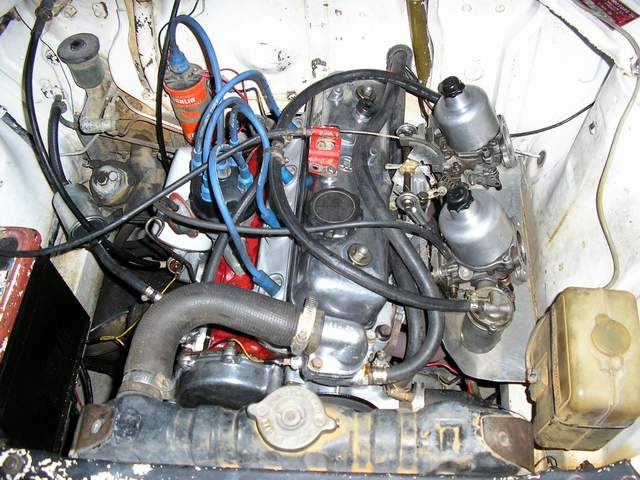

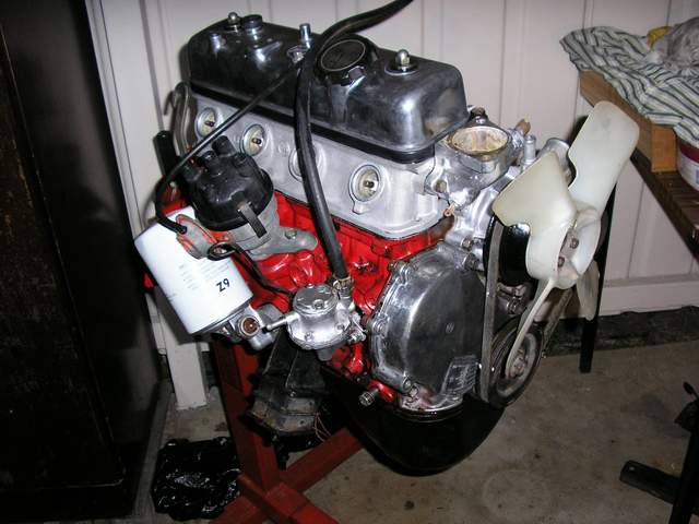

Felix Posted October 13, 2004 Report Posted October 13, 2004 (edited) woohoo, my 5k is now together and ready to go in my ke15 tomorrow. the 5k has 9.5:1 CR, mild porting, valve springs with dampers (good for over 8 grand), tighe 113 cam (25/65 65/25 400 thou lift), solid lifter conversion, double row timing chain. should go well. :) Edited October 13, 2004 by Felix Quote

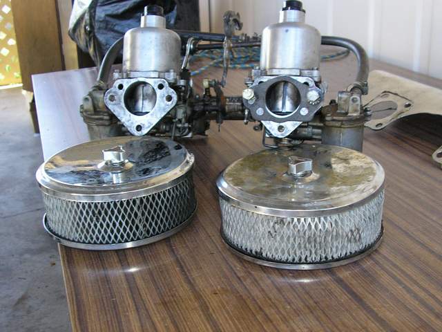

Felix Posted October 13, 2004 Author Report Posted October 13, 2004 twin 1 3/4" SU's should certainly help Quote

Felix Posted October 14, 2004 Author Report Posted October 14, 2004 haha, the mechanical fan cools better than an electric fan. when i'm sure the thing will run cool i might swap radiators over with the one in becs car which has an electric fan. BTW, becs' ke16 has an electric fan and the thing runs bloody hot in warm weather. i have never really had any cooling issues running a plastic fan, even when doing hard climbs up mt glorious. becs car ran nearly off the dial even when crawling up. the engine is now in. just need to connect up the tailshaft, and hook up the extractors, SUs, radiator, wires and all the fiddly shit. should be going later this arv. :) anyway lunch is over.....back to it Quote

Felix Posted October 14, 2004 Author Report Posted October 14, 2004 well in a ke1x you have to run the fan in front of the radiator, as there is no room behind. so really you can't set up a decent shroud, so the cooling efficiency is down. a plastic fan is way better than the original steel bladed fan. becs car has a 10" davies craig thermo on the front. when i put my old 4k in it, i will run a plastic fan on it, and try the thermo on my car. Quote
Felix Posted October 14, 2004 Author Report Posted October 14, 2004 (edited) she's a goer. got it all together and fed it water and oil and cranked it over (with coil lead removed) until the oil light went out. i topped up the oil then kicked it in the guts. it started first go! :) it runs ok. has got an exhaust leak at the head :sad: looks as though i will have to pull off the SU's to fix it. might just throw on the weber for the time being, as the linkages and return springs on the SUs need a little more thought i think. the SU's are a bugger to put on. took it for a run and it has heaps more grunt than the old 4k. it sounds a lot deeper, and really goes through the gears fast. the idle is a bit wild sounding at the moment, further work setting up the SU's and properly balancing them should help. Edited October 14, 2004 by Felix Quote
