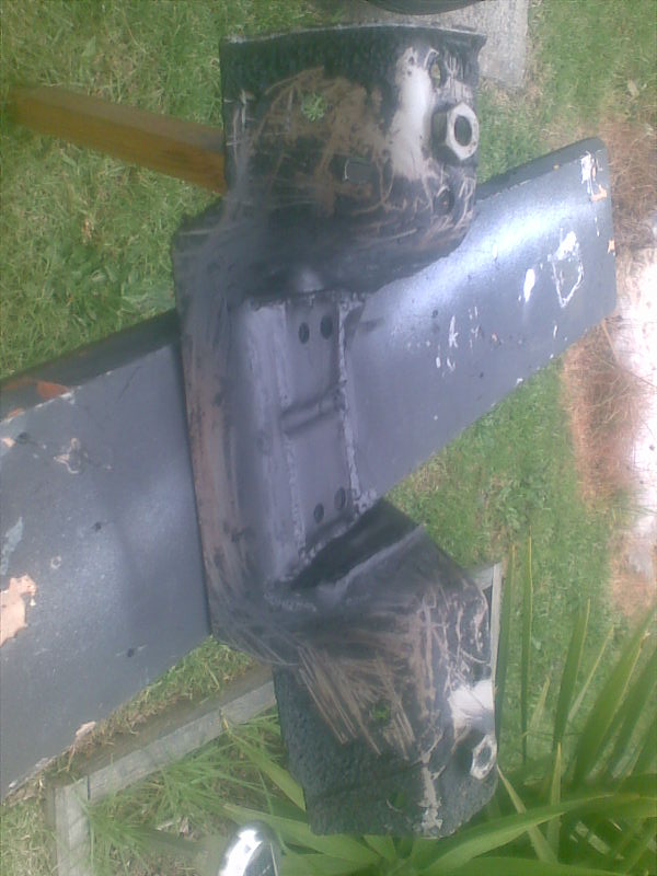

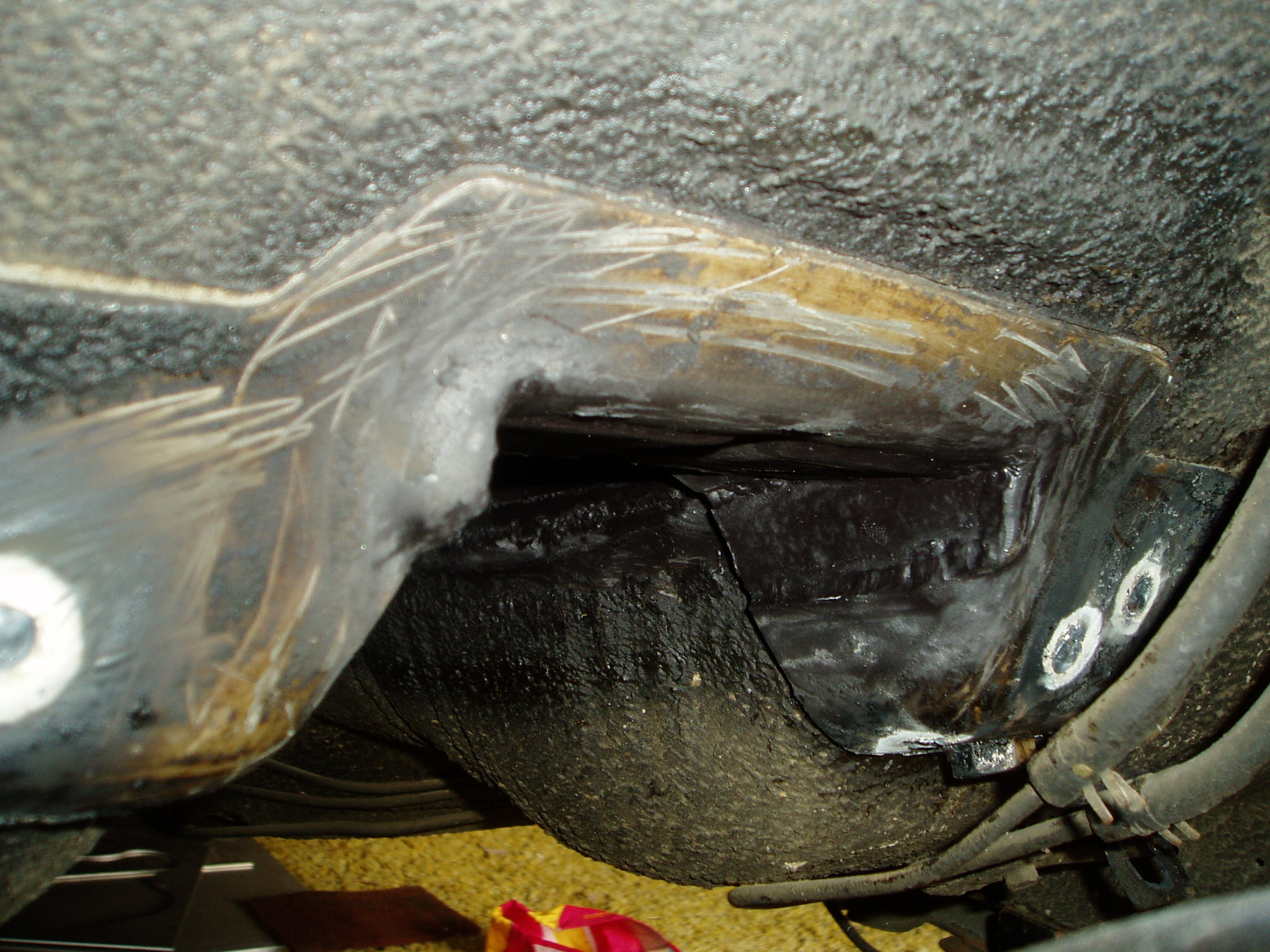

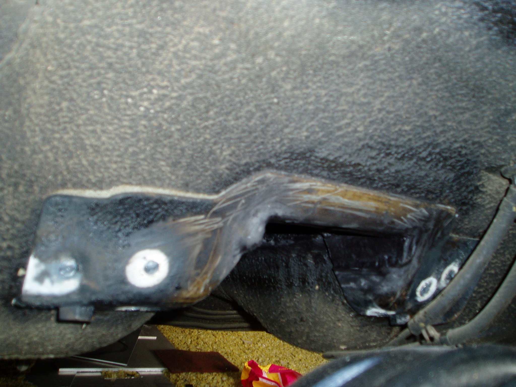

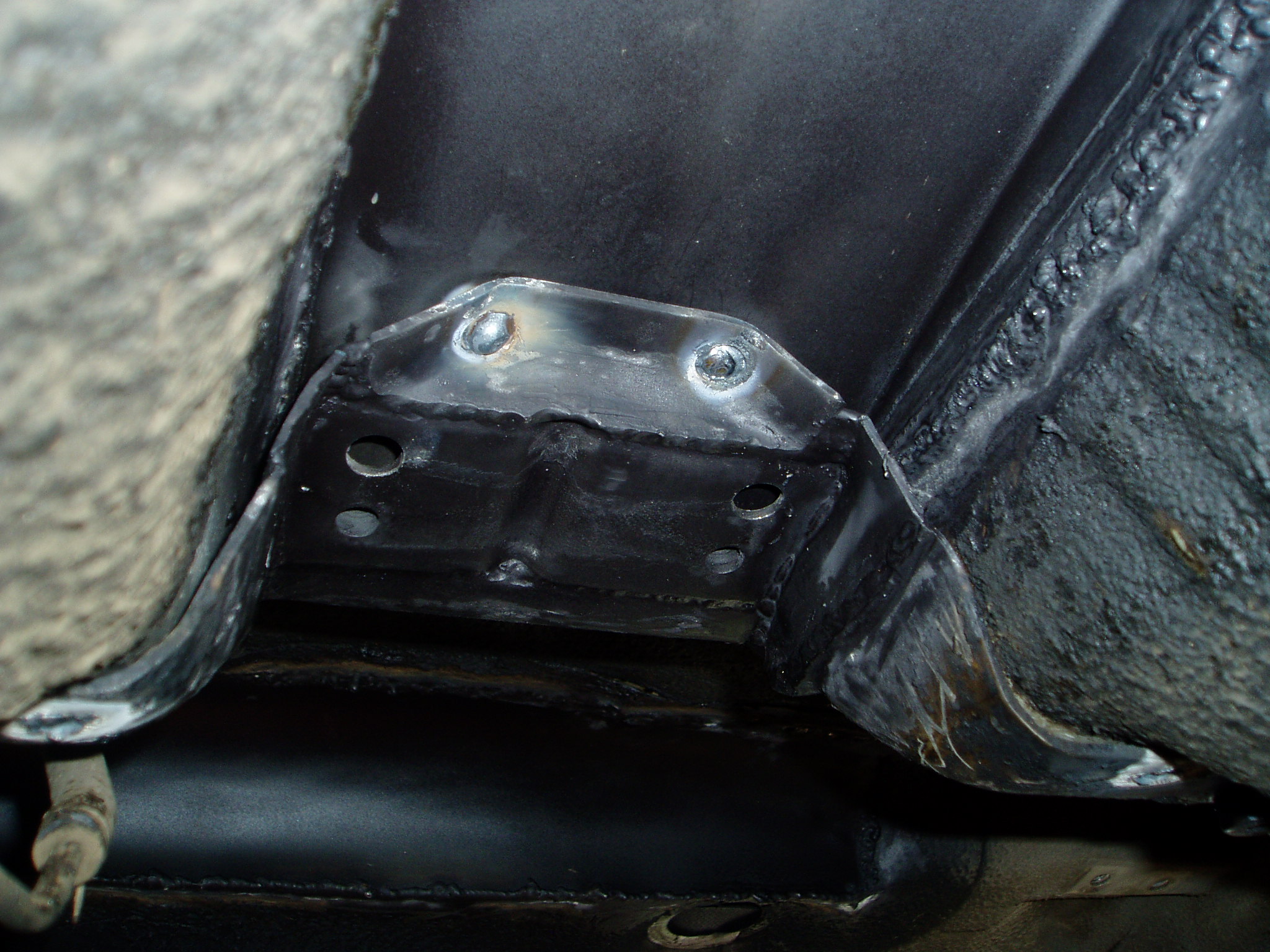

olskool Posted November 8, 2008 Author Report Posted November 8, 2008 Hey, so now I have completely finished the tunnel modifications. I fixed up that brace where the seatbelts bolt onto and made it a lot higher and welded it all back in. Seriously, once I put the underbosy sound deadener on nobody will tell. Here is some pics. This is the standard bracket. This is the finished modified bracket all welded and ready to go. And this is the job all done and welded back in. Looks standard as. :y: Quote
radrollaz Posted November 9, 2008 Report Posted November 9, 2008 Hey wayne, mate that looks great i have to do this mod to my rolla as well as the diff hits the floor in that exact spot. Wana do mine :y: Quote
olskool Posted November 10, 2008 Author Report Posted November 10, 2008 radrollaz said: Hey wayne, mate that looks great i have to do this mod to my rolla as well as the diff hits the floor in that exact spot. Wana do mine :bash: I'd love to mick, but I will tell you now, it was definitely not an easy job. There was a lot involved, and one extra job would be to pull apart your rear end. Quote

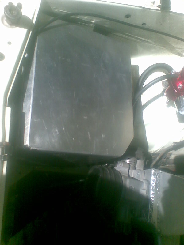

olskool Posted November 29, 2008 Author Report Posted November 29, 2008 Oh ok, yeah, that makes sense. Well hopefully by doing what I am doing it will help that. Anyway, here are a couple more pics. I finally finished the air box, well, not completely but anyway its a good excuse to put pics up. Quote

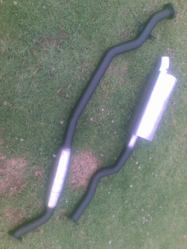

olskool Posted December 31, 2008 Author Report Posted December 31, 2008 (edited) Thanks for the replies guys. Been flat out like always working on the KE55 but I have made some progress. I polished up the inlet plenum and I finally finished the exhaust. Here is a quick pic of the finished product. You probably won't be able to notice but I have custom 4 bolt flanges for the exhaust. One of a kind, (I hope). So anyway, will be doing plenty more on the car but I don't have a very long holiday so I just gotta do what I can. Will be keeping you all uodated with pics and info as usual. Edited December 31, 2008 by olskool Quote
