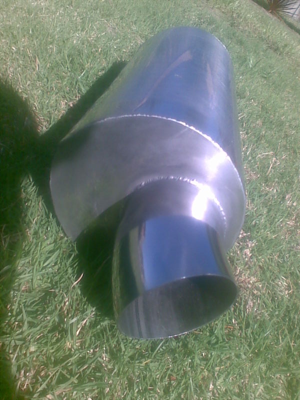

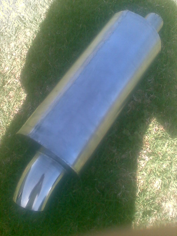

To begin with I have made a stainless steel muffler for the car. It is a straight through muffler with a polised stainless 3.5" dump pipe, that took me about 3 hrs to polish like that. So here are some pics. And, also by making the muffler myself, I will most definitely have no issues in hitting the leaf spring or anything like that.

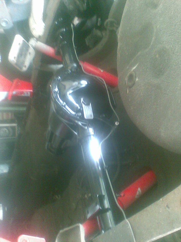

The next bit of really good news is that my diff is complete, shortened, I ended up going to 28spline axles(pretty much unbreakable for the N/A 4age) and a very tight brand new limo, brand new bearings, the whole lot ready to go. Very happy with the end product. I just gotta hurry up and finish the car so I can drive the car.

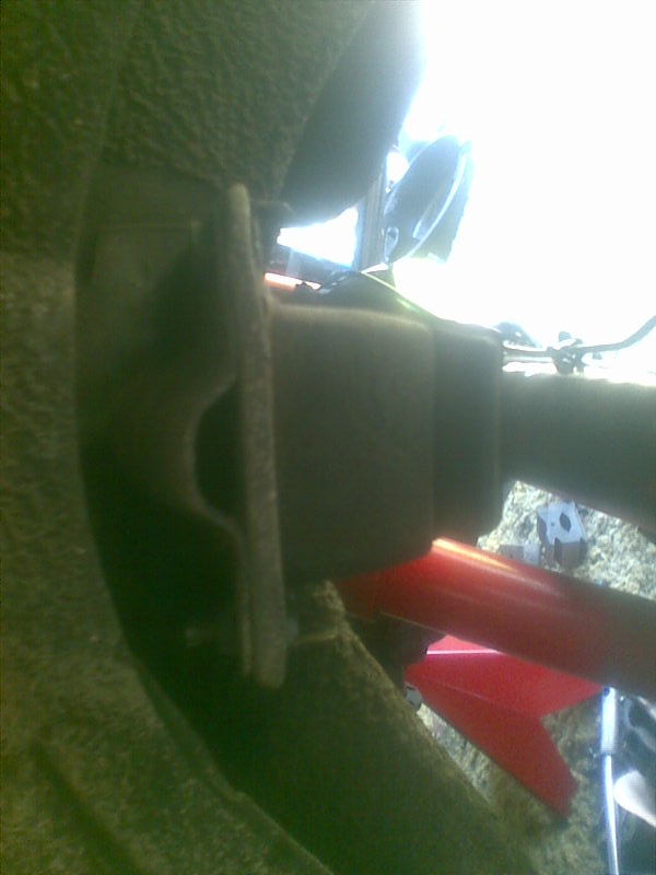

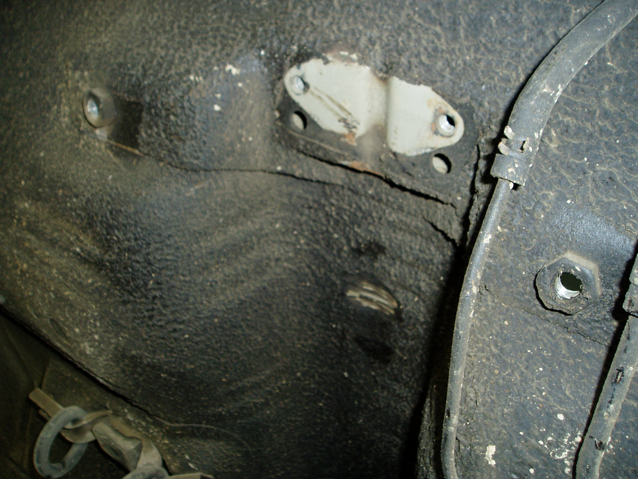

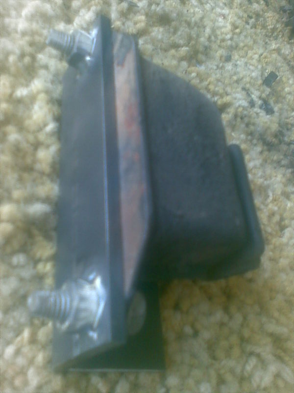

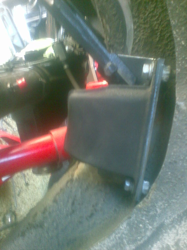

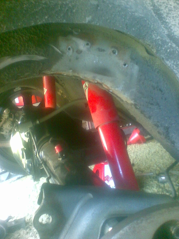

Anyway, this next thing is something I didn't plan to do but nevertheless will prove to be a worthwhile task. I have decided to partially notch a few sections to allow for better ride quality and suspension travel.
I cut out the brackets that the bump stops bolted onto.
This is where the bump stops sit standard.
This is the new bump stop bracket that I fabricated.
And this where the new position of the bump stops is going to be.
This has given a lot more clearance for the diff. The next part I will have to tackle is the rear section of the transmission tunnel. I will have to cut a section out and make a new part with extra clearance. So back to work I go. :yes:

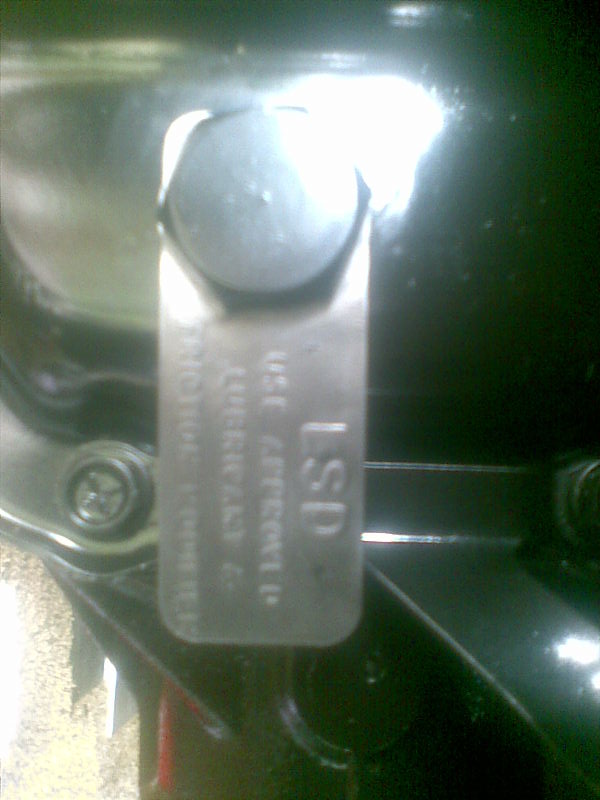

hey man, conversion is awesome so fare, your a quality welder
just cruious with your diff, i assume its the standard 3.70 ratio? or did you change to pintara to get 4.1?
also is that tag custom? because mine says "spin resistant diff"
I have two diffs. One from a skyline and one from a pintara. At the beginning of this thread there is a pic of the pintara diff where I chopped off all unnecessary brackets. The housing that you see now is still the pintara one, with the pintara 4.11 gear set, 28 spline limo and axles. Everything with those borg warners are pretty much interchangeable. That tag is standard ford falcon tag I think. I am not sure if it is custom.

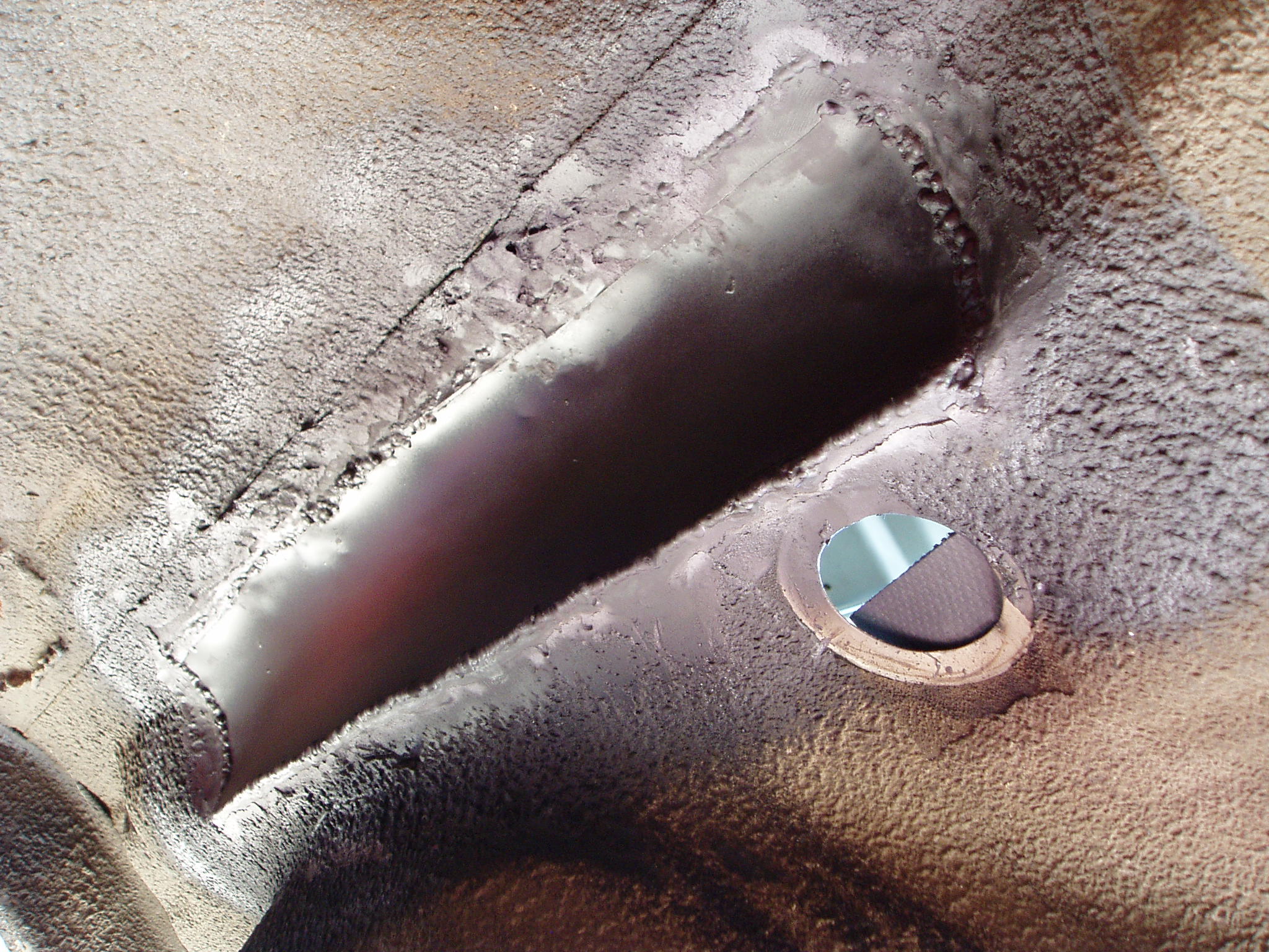

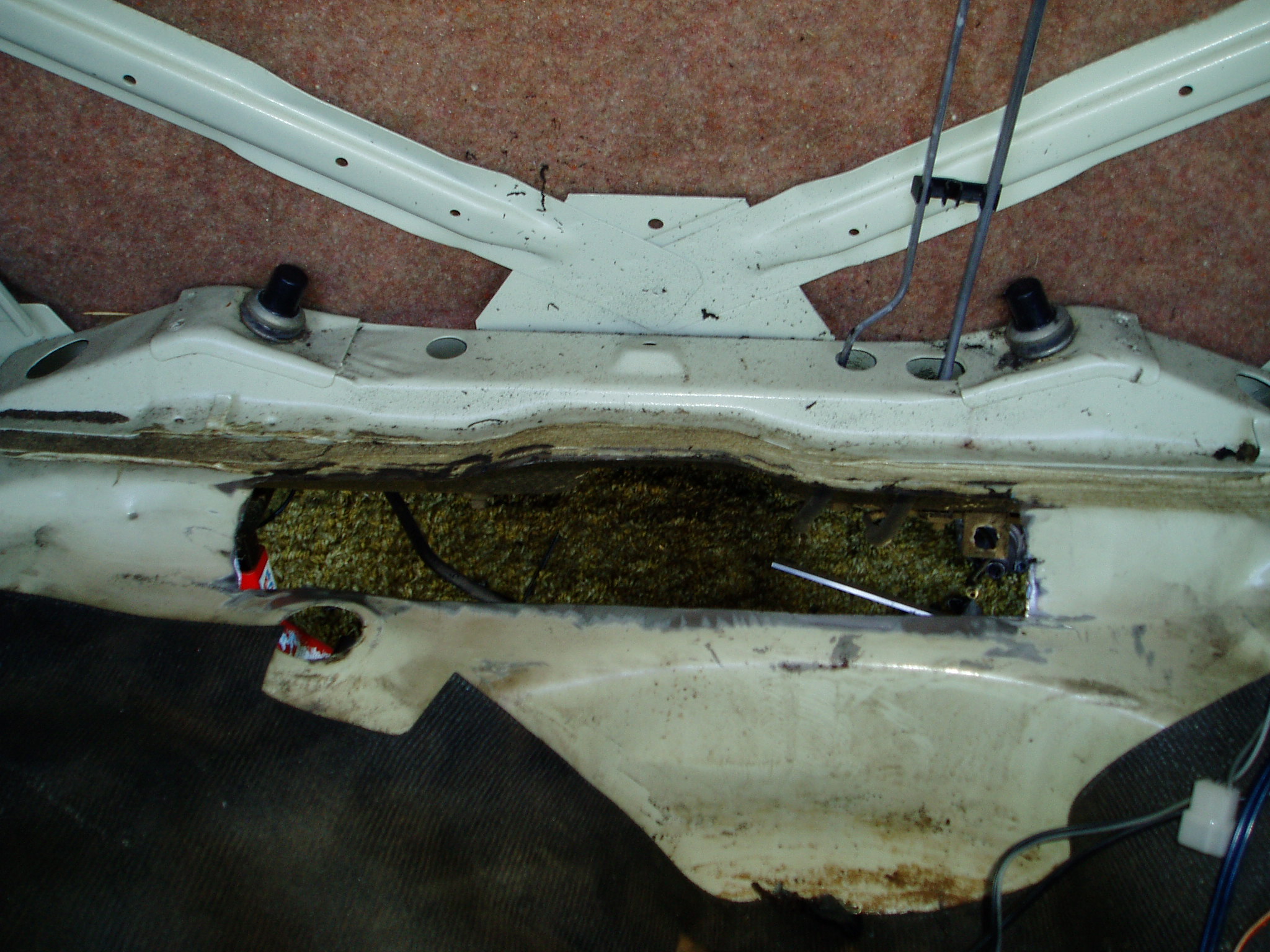

So, its been a while but the amount of work I have got done, I am quite happy with. Here is a bit of an update. So the big job that I had ahead of me was to make some extra clearances for the diff.

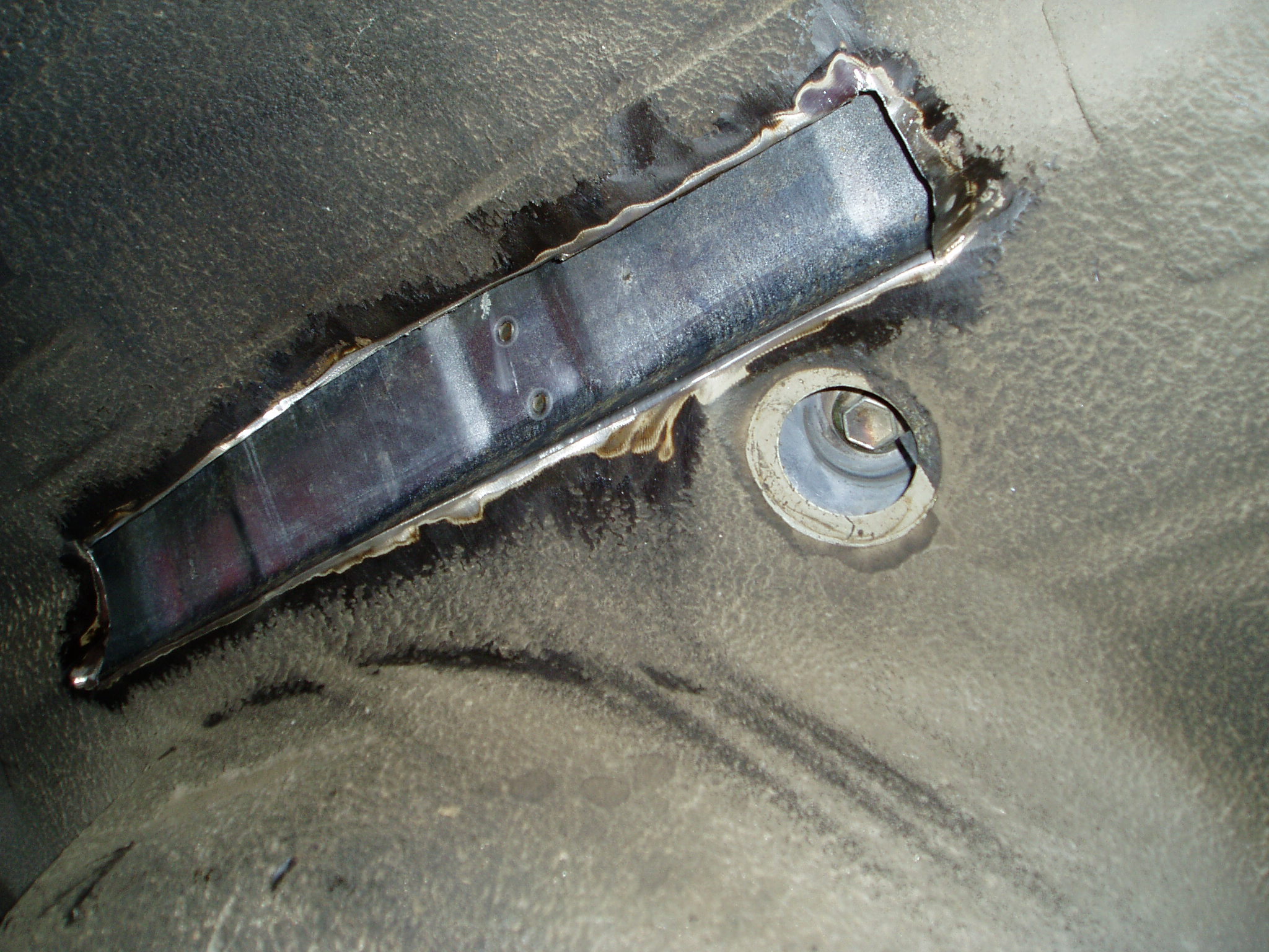

Firstly I cut out the section which is right underneath the fuel tank to allow for extra room at the back of the diff centre housing. I welded in a new section that I rolled and it just leaves the perfect amount of room for the diff also without interfering with the fuel tank.

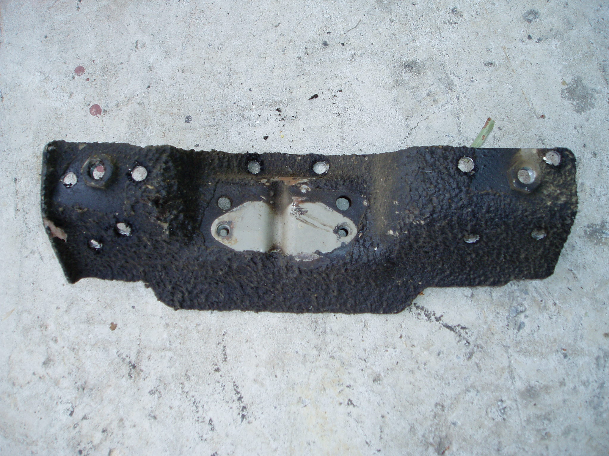

Here is the section I cut out.
And this is the job done and welded in. It may not look like it has given extra room but it most certainly has.

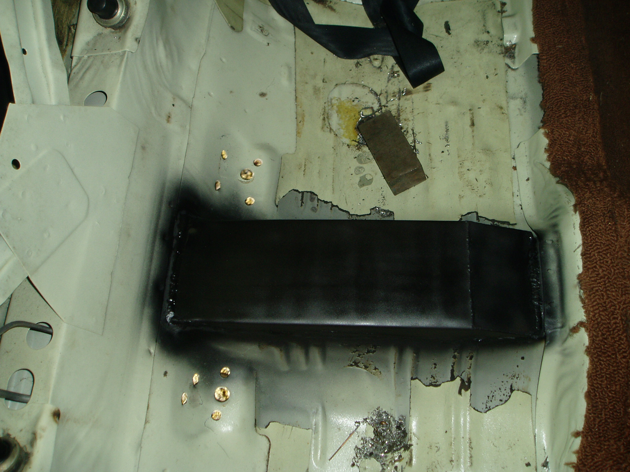

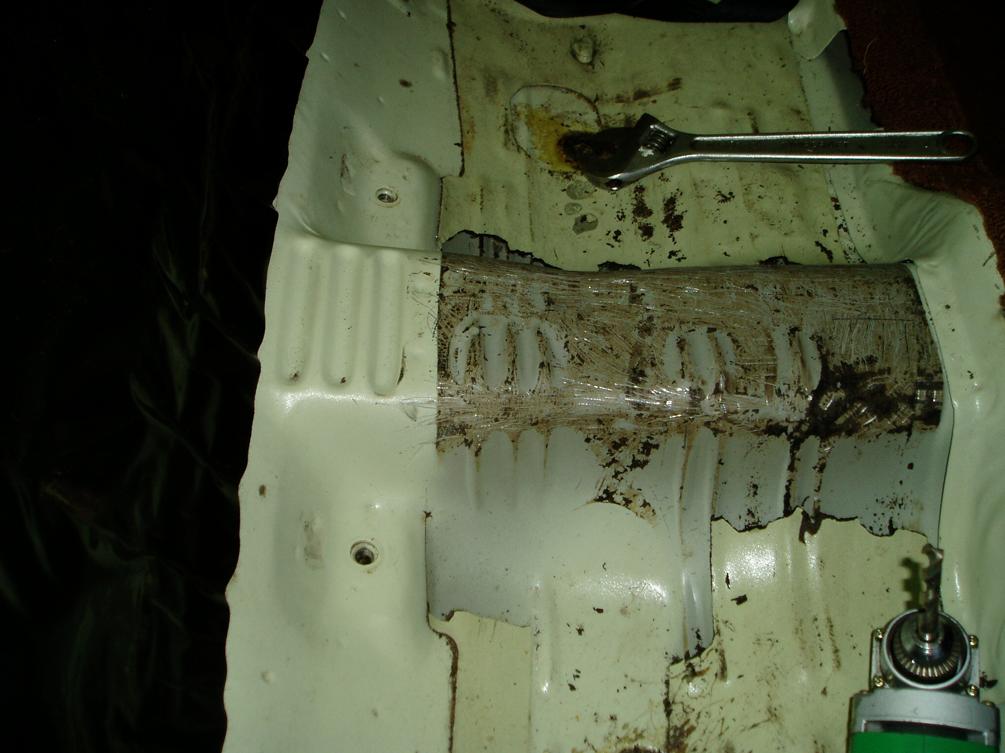

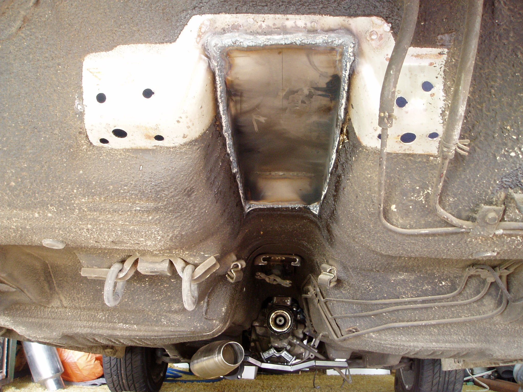

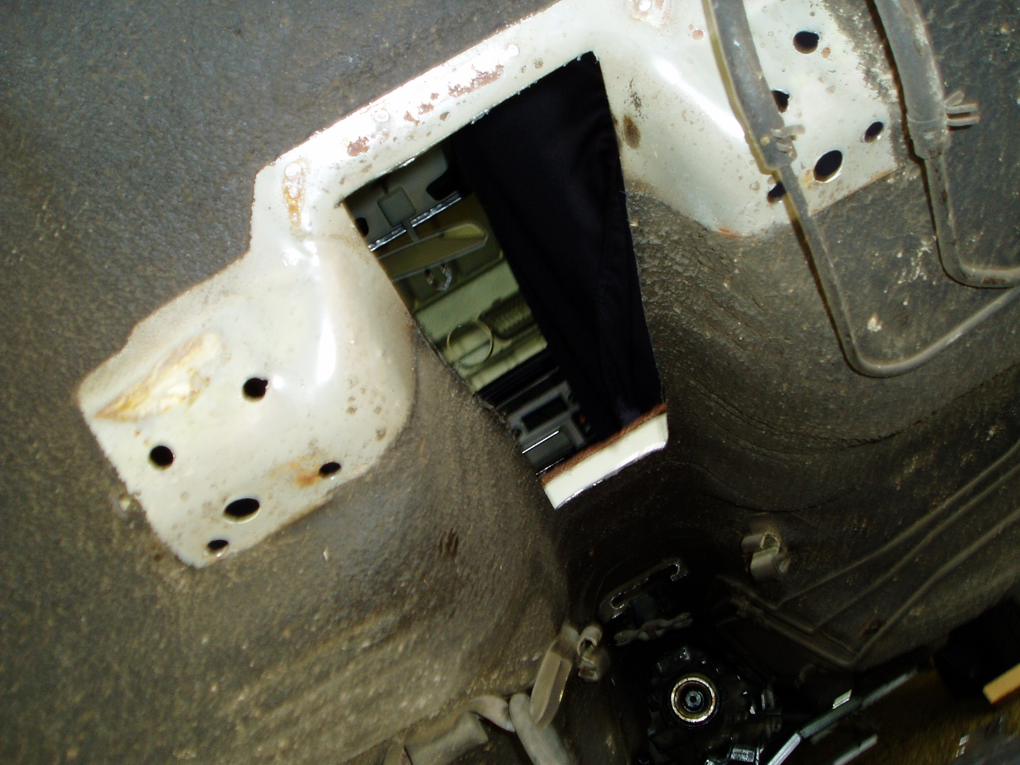

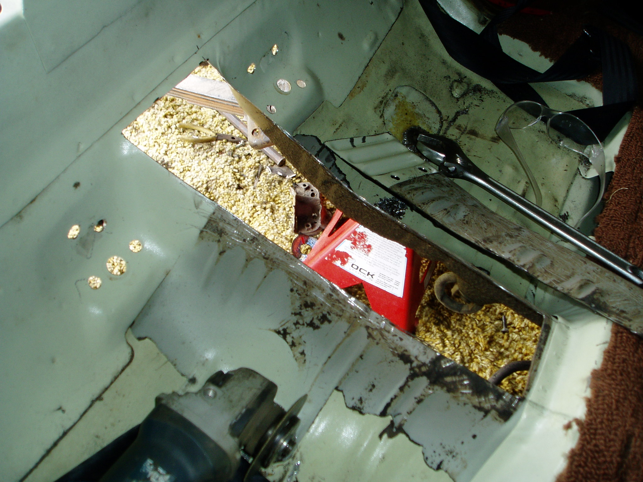

Once I finished that job I moved onto the next part. I only wanted to cut out the section of the transmission tunnel underneath the rear seat. This was the problem area as where the tailshaft bolted onto the diff is where it hit the floor. It only really hit when I got a decent bump on the road. BUT, I don't want it to happen at all. So out came this section too.
This is a structural part of the trans tunnel so I will have to modify it yet keep strength aswell.
No more for the better.

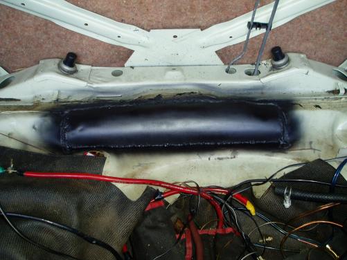

This is the structural brace. It is also a bolt on section for the seat belts, so it must be retained.

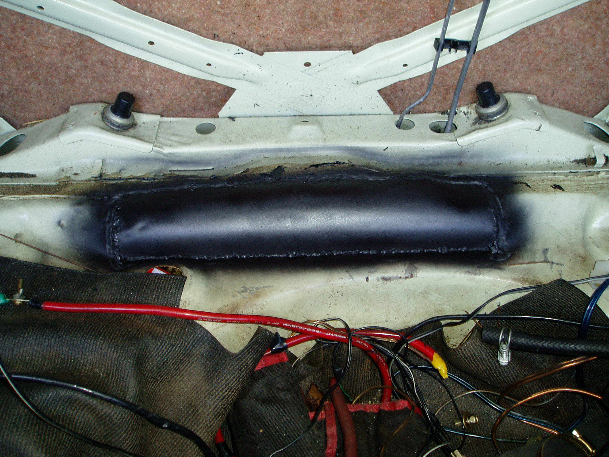

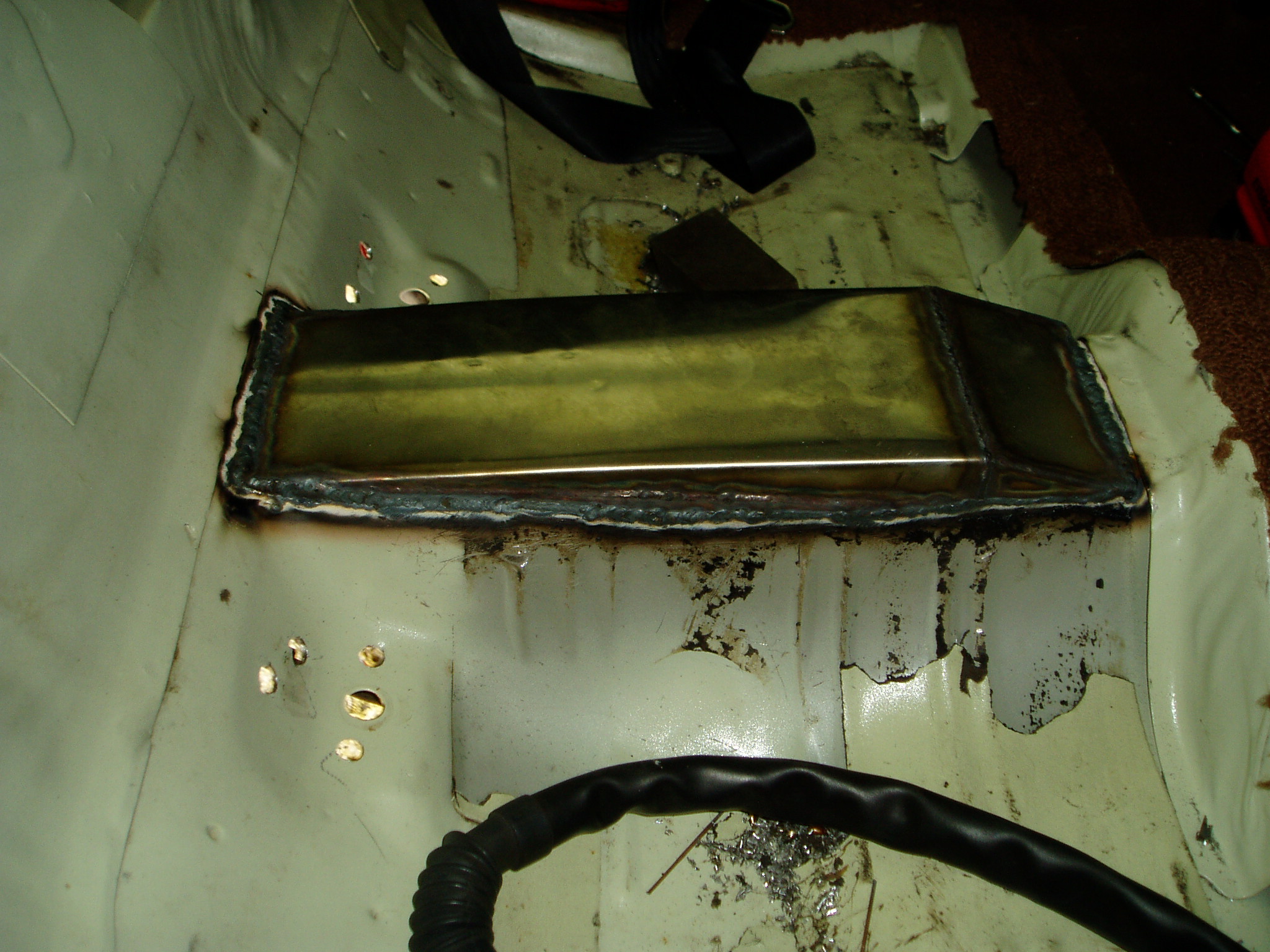

ANd here is the new section welded in with extra clearance. The next best thing is that it does not interfere with the seat. The seat sits straight back on there with no hassles. Gotta love it when things run smoothly. :)
Oh and the underbody sound deadener smells when it is on fire. :)
All painted and looking pretty.
I will be putting new underbody sound deadener on all the bits that I have welded in, but that wont be untill I am completely finished all of this welding.
