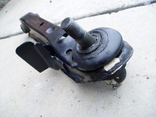

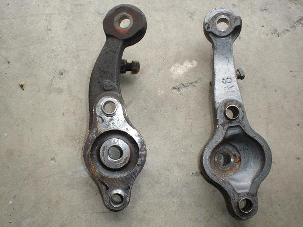

olskool Posted January 28, 2008 Author Report Posted January 28, 2008 (edited) Hello everyone, hope you all doing well after Christmas, New Years and the recent Australia Day. What a long weekend, I love it. Anyway, I got a chance to do some more work on my car finally and I am just doing a lot of shopping for it too. Gotta pamper the car too hey! :hmm: Any way, the RA65 struts that I purchased aren't an exact fit. All I had to do was modify the steering lock on the lower control arm so guess what, I DID. Turned out rather well, just gotta get it on the ground to see if it operates well. Heres some pics. The standard one. The standard one is on the left and the custom one is on the right. The custom one. Edited January 28, 2008 by olskool Quote

beerhead Posted February 2, 2008 Report Posted February 2, 2008 Hey, nice work there, coming along very nicely, great fabrication work. I don't really want to sink your boat, but I just in case you didn't know, RA65 struts in any corolla will end up with positive camber due to their stub axle angle, even with XT130 corona arms in the front end. Sigma arms rectify the problem (almost) but it'll put out your steering geometry unless you run enormous RCA's too (steering arms will not rotate along the horizontal plane) Quote
olskool Posted February 4, 2008 Author Report Posted February 4, 2008 Hey, nice work there, coming along very nicely, great fabrication work. I don't really want to sink your boat, but I just in case you didn't know, RA65 struts in any corolla will end up with positive camber due to their stub axle angle, even with XT130 corona arms in the front end. Sigma arms rectify the problem (almost) but it'll put out your steering geometry unless you run enormous RCA's too (steering arms will not rotate along the horizontal plane) Yeah, I just figured that out :hmm: , was thinking of getting camber adjustable tops, hopefully that will fix the problem. :jamie: Quote
beerhead Posted February 4, 2008 Report Posted February 4, 2008 Damn this is hard to explain properly ;) Here I go : The camber tops fix the camber issue, but the problem is, the closer the camber top is adjusted towards the engine bay the larger the degree of angle of difference that the steering arm sits at in relation to the steering bar/ tie rod ends. As the suspension compresses and rebounds when the wheels aren't pointing straight the wheels will toe in and toe out (bump steer) more due the reduction of steering symmetry caused by stub axle / steering arm angle. Quote

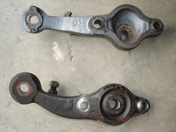

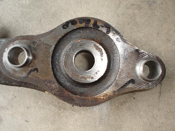

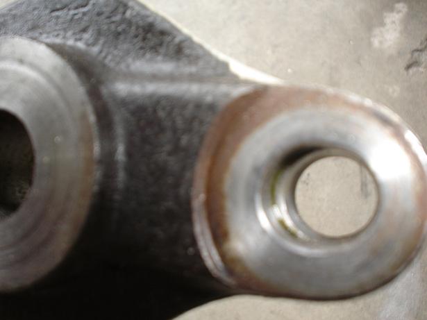

radrollaz Posted February 9, 2008 Report Posted February 9, 2008 Looks good olskool, love the cam covers :) I used RA60 struts in my car and it all bolted up but i had positive camber even with camber adjusters, so i got original corolla ke30 steering arms and got them machined out and custom sleeves put in that illongated the holes 3mm which then allowded the RA60 struts to bolt to the Ke30 steering arm. Then with the camber adjusters set as far as possible inward i ended up with -1 degree negetive camber. If you need pics let me know. :( Quote
olskool Posted February 9, 2008 Author Report Posted February 9, 2008 Looks good olskool, love the cam covers :bash: I used RA60 struts in my car and it all bolted up but i had positive camber even with camber adjusters, so i got original corolla ke30 steering arms and got them machined out and custom sleeves put in that illongated the holes 3mm which then allowded the RA60 struts to bolt to the Ke30 steering arm. Then with the camber adjusters set as far as possible inward i ended up with -1 degree negetive camber. If you need pics let me know. :bash: Pics would be awesome. Thanks heaps Mick, you have just made my day. Now I can get back on track. YAY YAY YAY. :) :) :bash: :( :bash: Quote
radrollaz Posted February 11, 2008 Report Posted February 11, 2008 Hey Olskool here are the pics i mentioned, You can see the difference between Ke30 arm (bottom) and RA60 arm (top). The Ke30 arm has more of an angle on the arm itself and also the hole in the center is in the middle were as the celica arm is straighter and the center hole is more to one side. This causes the celica steering arm to bring the whole strut in more and gives you positive camber as when it all bolts up it sits further in to begin with.The next thing is that the bolt holes on the celica arm are 3mm further apart than the corolla arm, thats why i got a machineing shop to illongate holes and fit sleeves in with a small lip on them like the standard arms have as its important that they locate the strut in place when bolted up. With out those rased lips the strut would have no support and only the bolts to hold it in place. If you have a look at both arms together you will also see that the corolla arm is thinner and also has a straight angle to it intead of the 45 degree angle of the celica's. If you have a look at both together you will see the differences and then you can see what needs to be done. Hope this helps |blink| Quote
