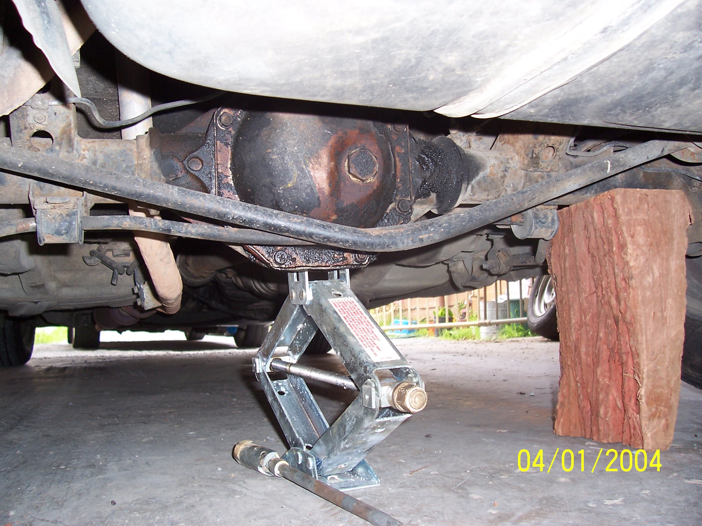

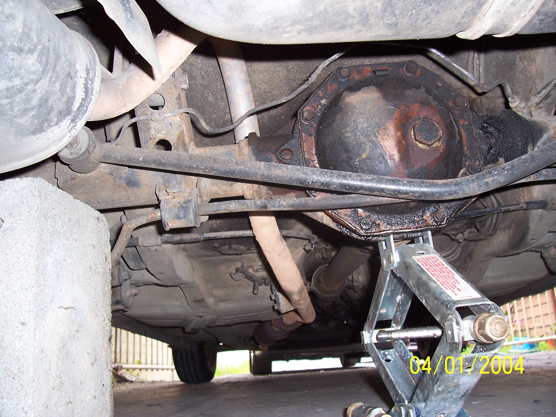

Shadex Posted September 15, 2007 Author Report Posted September 15, 2007 Ok, I jacked it up and took some pics.. here they are.. Quote
Redwarf Posted September 15, 2007 Report Posted September 15, 2007 I think we've found your problem. That Panhard is ROOTED. I'd be having a look at the mount on the drivers side, too. That thing has had a serious slap into something..... Quote
Shadex Posted September 15, 2007 Author Report Posted September 15, 2007 I think we've found your problem. That Panhard is ROOTED. I'd be having a look at the mount on the drivers side, too. That thing has had a serious slap into something..... Hmm can you point it out? I'm not sure where the snap is cause i was just looking then.. But if i take the rod off will i be out to move the wheel over just to see what it looks like? Quote
Redwarf Posted September 15, 2007 Report Posted September 15, 2007 (edited) No snap, just bent. See the rod that mounts on the chassis on the right, and on the diff on the left? The rod with the big bend in it? Well, it's meant to be a lot straighter than that. Go to a wrecker, get another one, and change it. Safety Sam also says: Buy a decent jack and some proper chassis stands before you hurt yourself. Edited September 15, 2007 by Redwarf Quote
KE30_KE35_KE55 Posted September 15, 2007 Report Posted September 15, 2007 Ok, I jacked it up and took some pics.. here they are.. Dude thats bent like a banana!. just wack it in a hydraulic press and straighten it up. or get one from a wreck. Quote

Shadex Posted September 15, 2007 Author Report Posted September 15, 2007 (edited) Lol yeah i will tomorrow, was just jacking it up like that to take some pics =D But wouldn't you think if someones changed the hole diff the panhard rod would of been changed? And he told me it was like that when he bought it and when he throw the other diffs in it never changed it. Edited September 15, 2007 by Shadex Quote
KE30_KE35_KE55 Posted September 15, 2007 Report Posted September 15, 2007 Lol yeah i will tomorrow, was just jacking it up like that to take some pics =DBut wouldn't you think if someones changed the hole diff the panhard rod would of been changed? And he told me it was like that when he bought it and when he throw the other diffs in it never changed it. The panhard rod does not come with a s/h diff. some wreckers cut them off with the oxy, they don't usually bend unless the vehicle is slid hard into a gutter. This usually also bends the rim and sometimes also bends the axle between the bearing and the drive flange. Quote

Des Posted September 16, 2007 Report Posted September 16, 2007 Lol yeah i will tomorrow, was just jacking it up like that to take some pics =DBut wouldn't you think if someones changed the hole diff the panhard rod would of been changed? And he told me it was like that when he bought it and when he throw the other diffs in it never changed it. Sounds like he slide into a gutter pretty hard and f@$ked the diff and bent the rod and just replaced the diff to try and rectify it. If your in Brisbane i have a straight panard rod you can have for free. Des :D Quote
Shadex Posted September 16, 2007 Author Report Posted September 16, 2007 Sounds like he slide into a gutter pretty hard and f@$ked the diff and bent the rod and just replaced the diff to try and rectify it. If your in Brisbane i have a straight panard rod you can have for free. Des :D Nah from Adelaide lol.. But if i go to like a self serve wreckers they would have them on the car still you reckon? Or would they all be cut with a oxy... I also gotta find some hard springs for the back.. apparntly EH or EA springs are really hard for KE70s. Quote
Des Posted September 16, 2007 Report Posted September 16, 2007 Nah from Adelaide lol.. But if i go to like a self serve wreckers they would have them on the car still you reckon?Or would they all be cut with a oxy... I also gotta find some hard springs for the back.. apparntly EH or EA springs are really hard for KE70s. Yeah, They generally only cut them when they remove the diff for some one etc, But if the diff is still in the car you have a good chance of getting a good one. Quote
Shadex Posted September 16, 2007 Author Report Posted September 16, 2007 Yeah, They generally only cut them when they remove the diff for some one etc, But if the diff is still in the car you have a good chance of getting a good one. How hard are they to take out, is it just those 2 bolts and it comes off? And with the springs do you know witch model falcon it is? someone said AU.. but there like 98+ Quote
