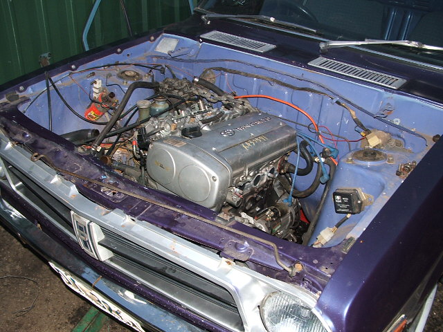

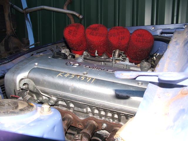

NickZ Posted September 8, 2007 Report Posted September 8, 2007 (edited) "Oh no not another thread", Yes its me again. This is my Datsun 1200 ute thats has more Toyota parts than Datsun. Upgraded to a 4AGE 20V, T50 Box and Microtech all from my 2 door KE30 and it already had KE30 front struts, LCA, Tie rod ends and steering arms. More pics as i go, but this was 4 hours work so far including pulling out the old engine. Engine mounts on the Xmember will be next and by the looks of it its going to take abit of fabrication work. Edited September 8, 2007 by NickZ Quote

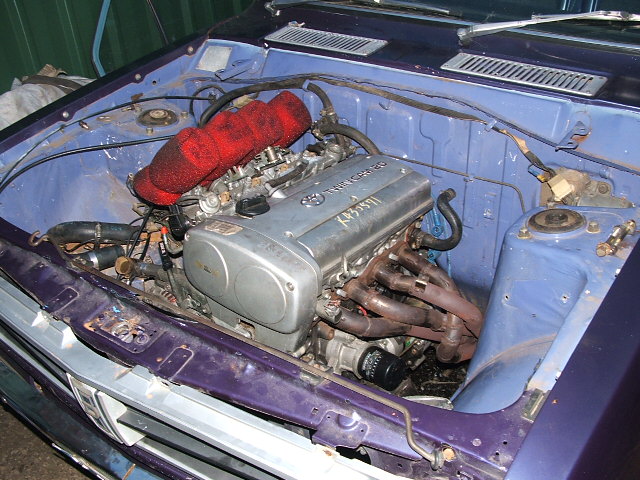

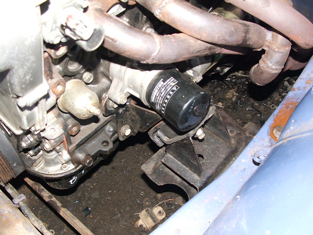

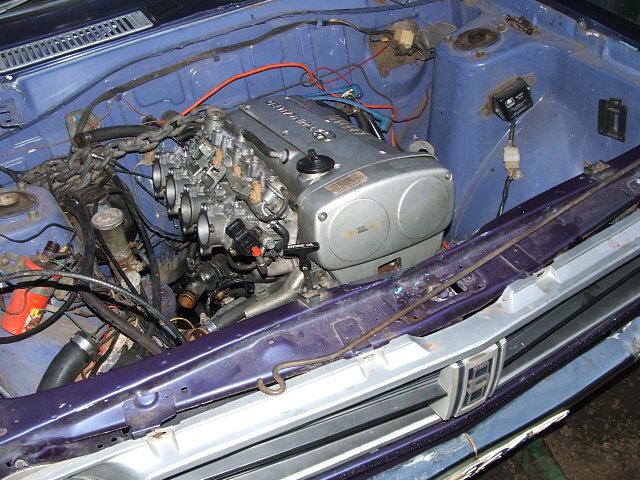

NickZ Posted September 9, 2007 Author Report Posted September 9, 2007 Todays progress. With a small amount of modification the ke30 front X member bolted in, so no fabrication was needed for the engine mounts, its all bolted in. Quote

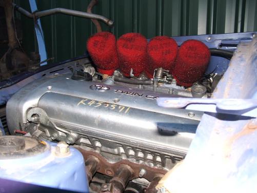

NickZ Posted September 9, 2007 Author Report Posted September 9, 2007 ive have the ute for a few years now, it was time for a upgrade, No the bonnet wont shut with the trumpets and cleaners, ill have to go for new straight trumpets. Quote
jamesrolla Posted September 9, 2007 Report Posted September 9, 2007 cut a massive hole in the bonnet for them Quote

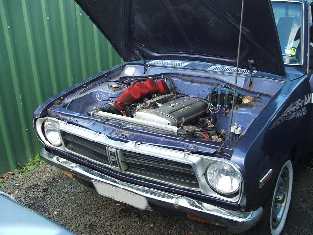

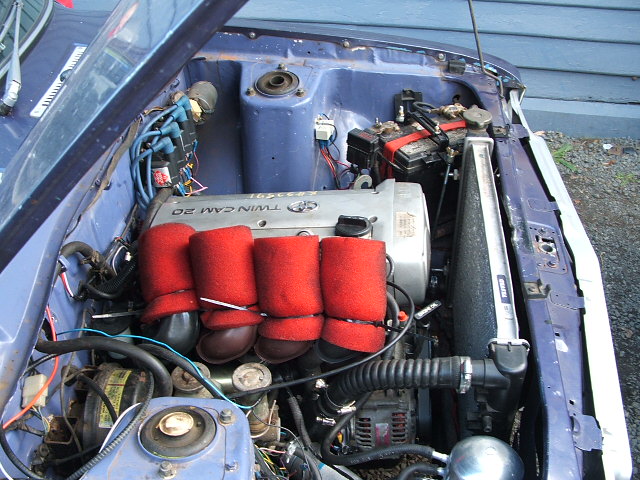

NickZ Posted September 30, 2007 Author Report Posted September 30, 2007 Well its going, just need to finish the exhaust to the rear and make a new surge tank to mount under the tray, Goes well. so it Now has: 4AGE 20V T50 5 Speed Microtech MTX 8 Multi Coil Ignition VP Aluminium Radiator Hand Made Extractors and Exhaust sortened KE30 tail shaft with 1200 rear yoke, KE30 front Cross Member RA40 Front Struts, LCA KE30 Tie Rods KE30 Sway Bar Celica clutch master cylinder KE30 Speedo Cable and soon cluster KE30 Steel rims with white walls Relocated the Battery to the Passenger side And yes the bonnet does shut and just clears the trumpets just touches the cleaner a bit Quote
