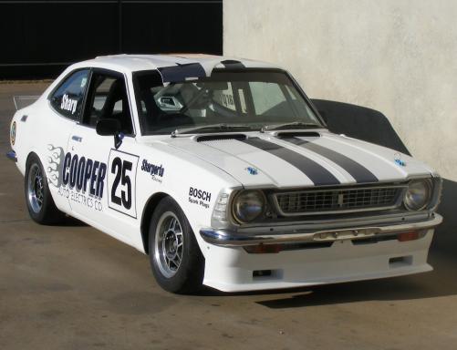

toyocharged Posted February 27, 2010 Author Report Share Posted February 27, 2010 A little update on the Rolla , Ive now had the engine rebuilt with Toda pistons,spool rods, ported head, balanced and blueprinted bottom end, 550cc inj and it will run on e85. Ive also acquired a holinger gearbox with straightcut gears and close ratios, I have upgraded the thickness of the rotors and gone to a Hawkht10 pad compouds. Fitted flares and bigger 13x7 rims and 205/60/13 tyres, It should be hitting the dyno next week and hoping for a 20hp gain over the previous setup of 182hp @ the flywheel here a few pics Quote Link to comment Share on other sites More sharing options...

toyocharged Posted March 5, 2010 Author Report Share Posted March 5, 2010 The little rolla is moving now, had a good day working on it , fixed a few things up for mandatory scrutineering and only have to get a e85 tune and fit airbox, getting the baseplate laser cut to suit the quads. Hit the track for a practice day on 27th to see if everything works, bed in brakes and road some tyres ready for bathurst at Easter:dance: :P :( Little vid of the nephew going down the driveway, its only hitting 3000rpm, not even close to being on cam, straight cut gears sound f@$kin great inside and out of the car Youtube Video -> [ Quote Link to comment Share on other sites More sharing options...

toyocharged Posted March 28, 2010 Author Report Share Posted March 28, 2010 do you use the stock KE2# strut when making up the custom coilovers? Cheers yep use the standard strut just cut and shut with a coilover kit Car has finally hit the track, fixed the gearbox leak and changed the diff to a 4.11 for Bathurst next weekend :). The car went well, missed a few shifts on the box due to the closeness of the shifts now, only really used 2,3,4 as the diff was too high. Brake upgrade seems good needs more rear though. The front l/h guard rubs so the guard needs to be trimmed for clearance, car seems to have a heap more sniff in a straightline, I couldnt really judge the upgrade of the wheels and tyres as the tyres were second hand and 4 yrs old, new tyres next week. The car has better turn in but suffered mid corner understeer and was very loose in the rear, also has a bit of a ecu interface fault on the crank angle sensor which limits it to 8500rpm. Youtube Video -> Quote Link to comment Share on other sites More sharing options...
