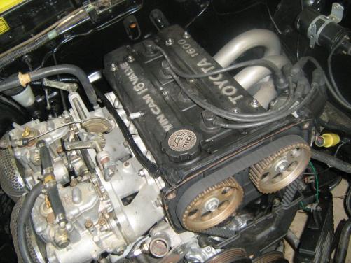

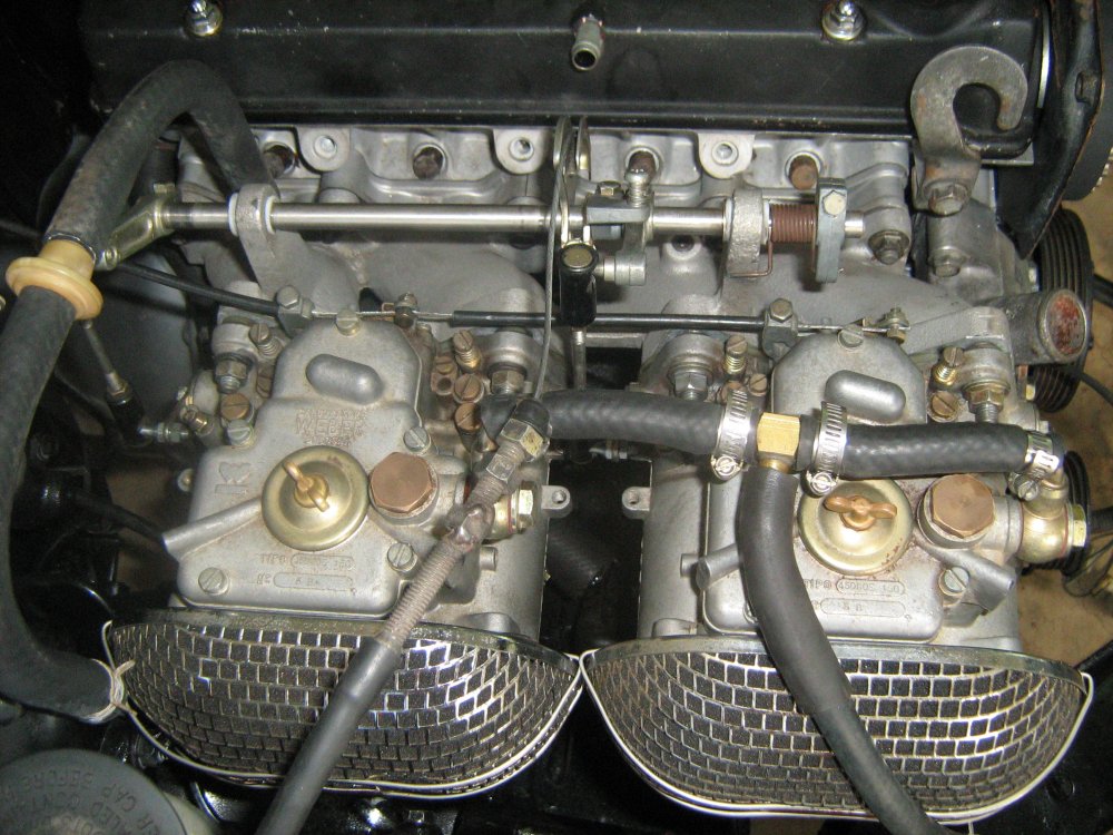

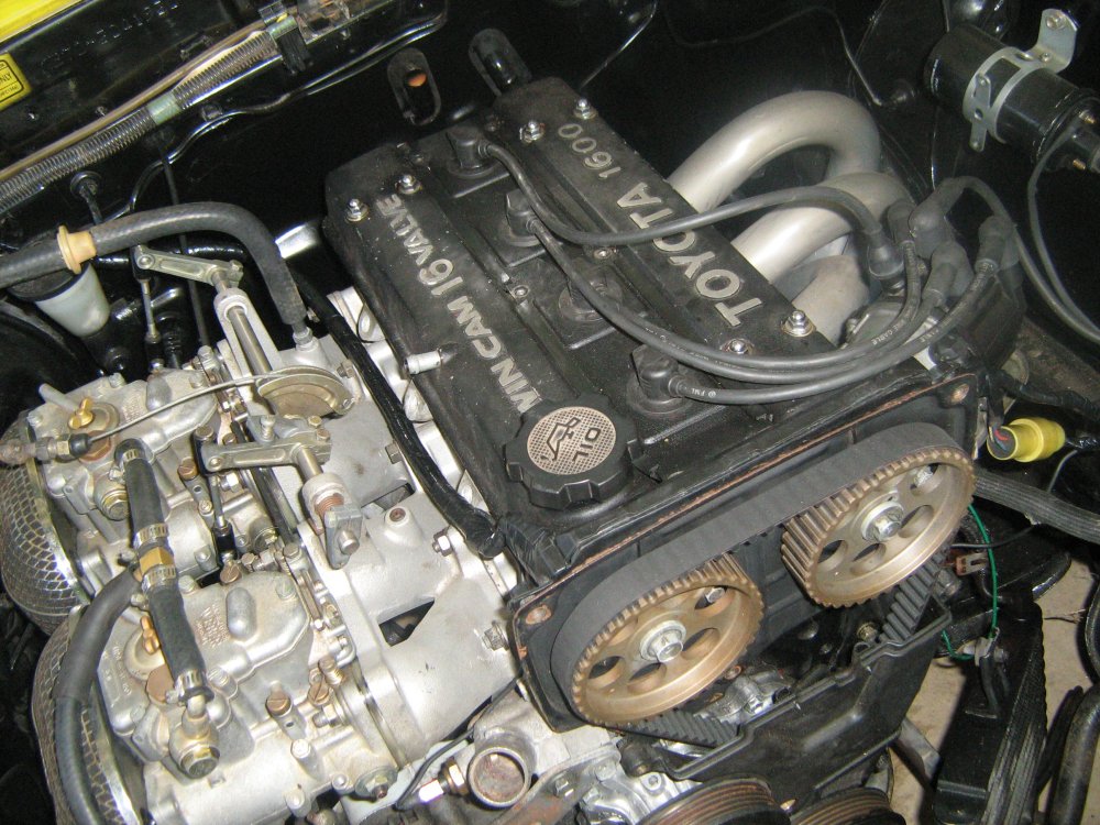

Trev Posted May 31, 2008 Author Report Posted May 31, 2008 (edited) Got rid of the missfire, The 2nd webber (number 3&4) was staying open a little bit so i hooked the linkages up and it runs alot better now and i took the accelerator cable out of the turbo sedan as it was too short anyway but it fits the van great, I just have to make up a cable bracket as i lost the one i had. Edited May 31, 2008 by Trev

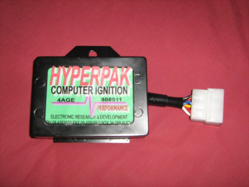

Trev Posted July 23, 2008 Author Report Posted July 23, 2008 Got a Hyperpak ignition coming for it to run the dizzy properly.

Trev Posted August 19, 2008 Author Report Posted August 19, 2008 Bit of an update, I got the fuel pump the day after i ordered it and i received the hyperpak computer today so when i get a free day i will get the pump in and do the ignition system.

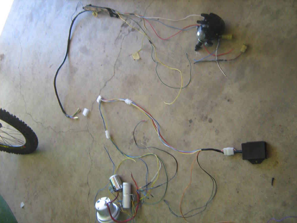

Trev Posted August 23, 2008 Author Report Posted August 23, 2008 Made my wiring harness to suit the ecu, tacho and oil/water senders:
Trev Posted August 31, 2008 Author Report Posted August 31, 2008 Fitted the new soft mounts to the carbies and hooked the ecu up so i could start it up and f@$k me this thing is very responsive, I beleive that it revs about 3 times quicker than the injected ones and it seems like its going to have alot of power, I was under the impression that the race prepped 45's would be crap on the stock engine but i sure fooled that idea. I did this accompanied by Slim (4ages), Jon (Jip_01) & Nick (Winke55) so I'm sure they will give you an idea of what it was like.

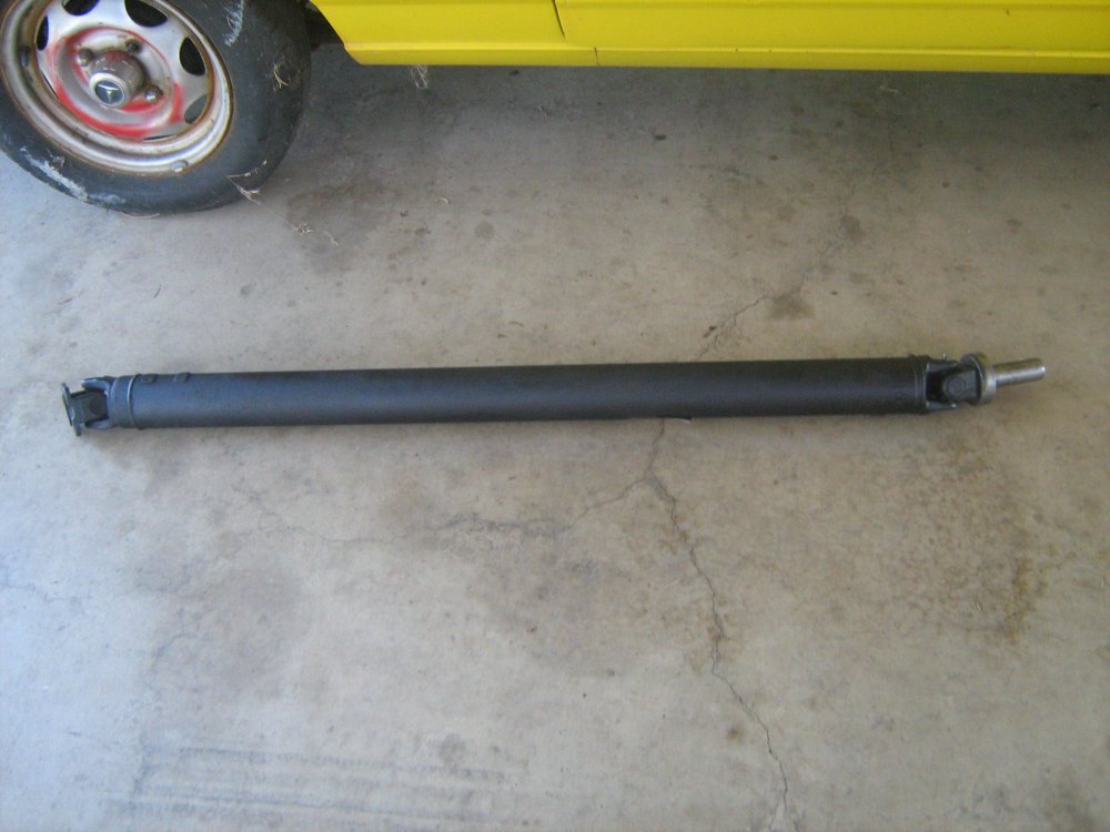

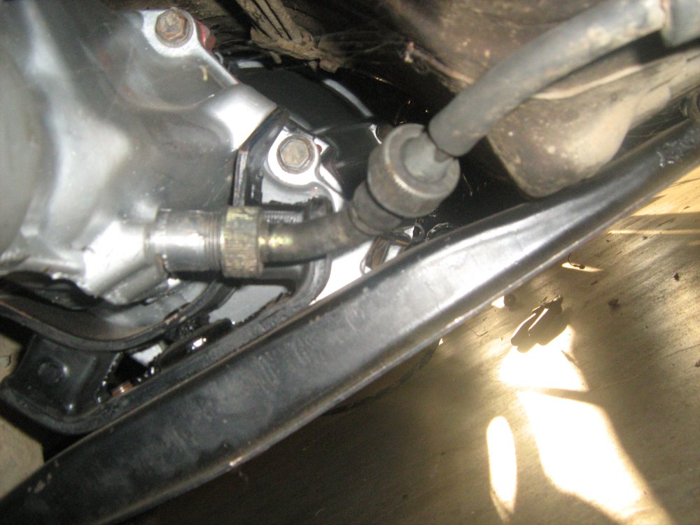

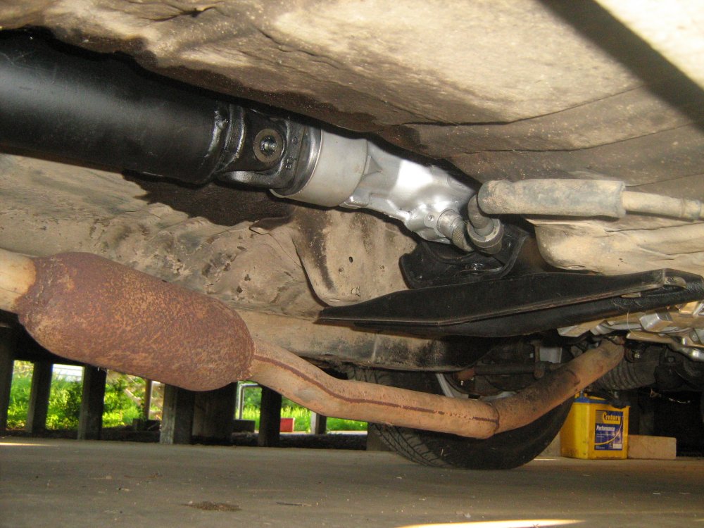

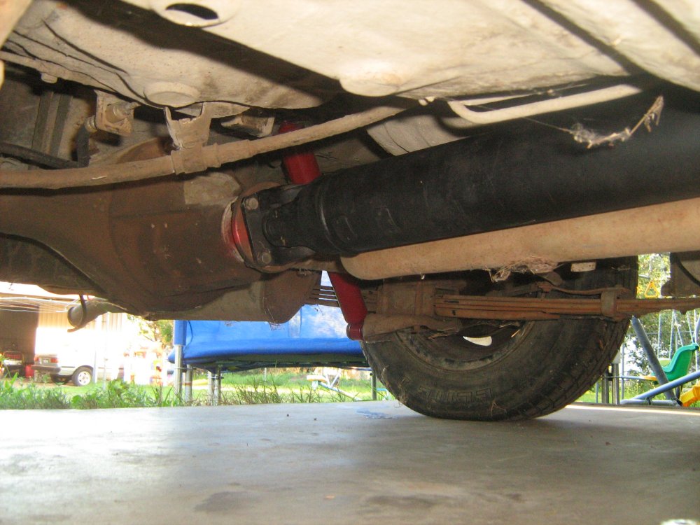

Trev Posted September 13, 2008 Author Report Posted September 13, 2008 I finally got around to putting the T50 yoke onto the 1 piece tailshaft that was behind the K50 and installed it today: I also grabbed a speedo drive 45 degree adapter out of the bosses ADM AE86 half cut so i could run my speedo cable nicely: I am hoping to take it up to work in the next 2 weeks so i can put it on the hoist and finish the fuel system and front wiring as I'm going to try to get it up to strathpine on october 5 :)
