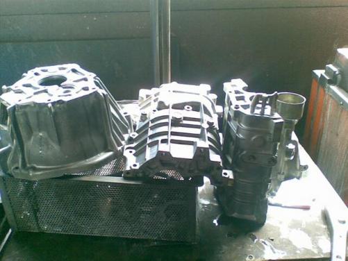

Trev Posted March 25, 2008 Author Report Posted March 25, 2008 Todays lunchtime efforts turned out good, I did a quick blast just to take all the crap off, Bearings are ordered and are on the way, Some pics... Well it has a bit more bling than what i thought it woulda, I was gonna do the gear housing black to break it up a bit but the aluminium will do fine: And finally i got this in the mail today: Will be replacing the thick gaskets with some softmounts.
Medicine_Man Posted March 25, 2008 Report Posted March 25, 2008 ooooh, that gearbox is all sexy now :D Good to see more goodies have arrived!!
camerondownunder88 Posted March 25, 2008 Report Posted March 25, 2008 Did you glass bead that gear box or use oxide? As it came up really GOOD. cameron
Kid-Ae Posted March 25, 2008 Report Posted March 25, 2008 bugger me.. what did you use to clean that gearbox? ima get me some :hmm: Great effort :D
Trev Posted March 25, 2008 Author Report Posted March 25, 2008 camerondownunder88 said: Did you glass bead that gear box or use oxide? As it came up really GOOD. cameron Glass polishing bead, Our blaster is water and air but i painted the box with aluminium paint to give a better shine. ROLLA said: bugger me.. what did you use to clean that gearbox? ima get me some :hmm: Great effort :D As above.
Kid-Ae Posted March 25, 2008 Report Posted March 25, 2008 Ah, so not quite just cleaning. Was bout to say.. Still looks tops though. Whats next on the list?
Trev Posted March 25, 2008 Author Report Posted March 25, 2008 ROLLA said: Ah, so not quite just cleaning. Was bout to say.. Still looks tops though. Whats next on the list? I thought i made it clear in the post i did with the pics that the 1st pic was the quick clean and i just went with all aluminium. Next on the list is to take the engine to work and modify the cooling pipes and give it a general clean up, Hopefully i will kit the carbies next week.
