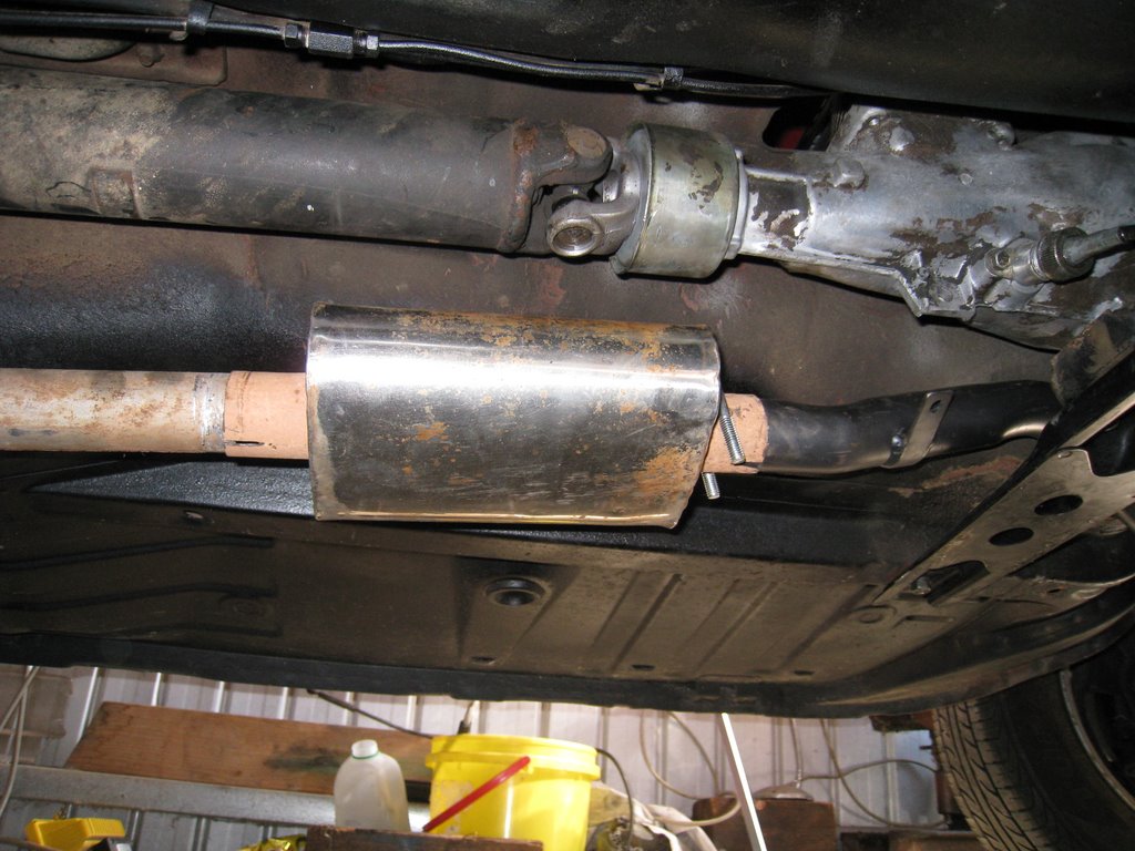

philbey Posted February 1, 2009 Author Report Posted February 1, 2009 Scotty, that muffler I pinched off you turned out to be a complete winner! I lopped off the ends and slitted them, and it fitted perfectly where the old peashooter resonator was. Now the exhaust is 1 3/4 all the way through and in fairly good condition. See pic. There is a muffler between the tank and left rear leaf, but it's too big and knocks on the spring mount. I will probably rip that out and put another smaller muffler in, depending on how loud it is. Basically all that is left to do is fit up the KE20 rad, cut the floorpan (which I'm not keen to do haha) and its test pilot time. The 40+ heat in the shed was fairly demotivating over the last 4 days though.... Quote
ScottKE1X Posted February 1, 2009 Report Posted February 1, 2009 (edited) Nice, looks pro/ Does that mean its permanent?? you should polish that bitch up :cool: didnt realise you'd matt blacked the cars whole underside mate, you must be serious!! good luck with the tunnel cut, try not to cry when doing it.... Scott. Edited February 1, 2009 by ScottKE1X Quote
