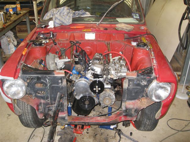

philbey Posted January 10, 2009 Author Report Posted January 10, 2009 Ryan, I'm going to call you right now, after I write this post! My KE10 starter fitted under my headers so I forgot all about it. Solenoid is close though and will probably get fried, so yeh, I'm keen. Plus that strommy is rattling around in my car and pissing me off! haha. Here's 2 pics from a few weeks back, motor is actually in now. Do I look excited haha. Quote
philbey Posted January 10, 2009 Author Report Posted January 10, 2009 Those pics are a tad old. Motor is in the car now. Went in easy enough. I painted the rocker, same blue as the block. Lovely. Scratched the crap out of it getting the throttle cables sorted though.... Repaint time! Cables worked perfectly, the idle screw setup is a bit dodgy but will suffice. BUT - I had the worst thing ever happened. Took the dizzy off, dropped the screw, heard a clang of it falling on sheetmetal.... Hmm. Did it land on the crossmember? No. Did it land on the car stand base?.... Still no..... Sounded like thin sheet metal....... hmmm. Like the same gauge sheet they make sumps out of! Damn thing went straight down the dizzy hole and past the drive gear and landed in the bloody sump. Didnt actually take long to pull it off, just jack the engine up. I ripped out my baffle as well, one of the silver solder joints cracked off, and I decided I don't like the design. When I get a Mig welder, I'll try a different design with a vertical baffle on the spare sump I've got. Also tried mounting my Fuel Reg, pain in the arse. I think I'll just zip tie it in to get a test fire happening! Quote

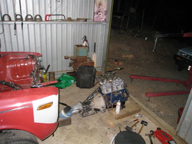

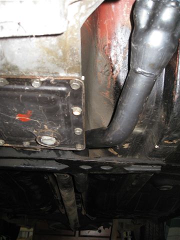

philbey Posted January 12, 2009 Author Report Posted January 12, 2009 Pic with the motor in, went to my mate Jimmy's and got myself a nice correct size pulley. Lovely..... Also scored a clutch cable and another window seal to replace my crappy aftermarket one that just wont sit right. The sandwich plate between the box was off my Auto 3K, so I had to drill a clutch hole In Situ.... Damn. Pic of the extractors over the cross member as well. Beautiful fit. These HM's are a treat. Quote

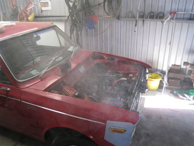

philbey Posted January 18, 2009 Author Report Posted January 18, 2009 (edited) So I juiced it up and connected the battery terminals and let out the smoke! Alternator wire had split slightly and earthed on the crossmember. See pic. Fixed that and had issues getting low voltage to the starter. After rooting around for a while I realised it was the Kill switch from the old automatic shifter... :yak: The car is cranking fine now... with the plugs out (Read This). Only just turns over with the plugs in though! For interest, I stuck a comp tester on it, looking at around 200psi, although I don't have much faith in Dad's calibrated instruments. I'll chase a 5k reduction starter this week, buy one brand new if I have to and jam that in. Just want to hear it fire up! Edited January 18, 2009 by philbey Quote

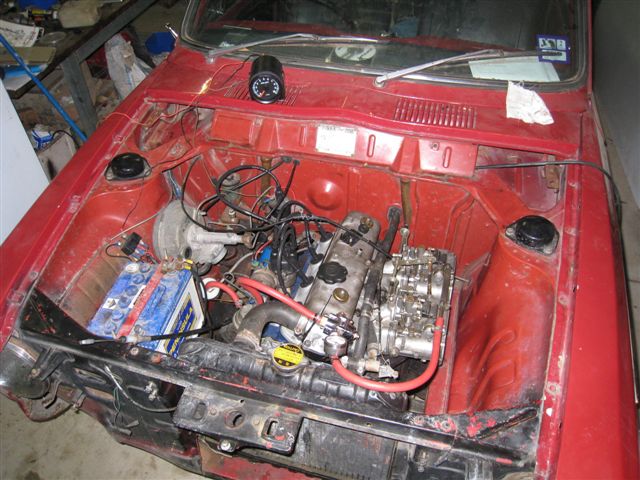

philbey Posted January 18, 2009 Author Report Posted January 18, 2009 Found other pics on the camera. This is my "just get it started" setup. Note the fuel pressure regulator zip tied to a rad hose, thats temporary until I get time to make a little bracket for it. Just going to mount on the front of the manifold. Very little room around the place. Tach is wired onto the scuttle as well so I can set idle's and so on without jumping in and out of the cockpit. The whole engine bay looks filthy but I can't be bothered painting it all up. The motor is a bit of a diamond in the rough, especially when I get the high gloss blue rocker cover on there as well! I just whacked a crappy one on there because I've already had to repaint the good one after I scratched it up getting throttle cables sorted.... Quote
