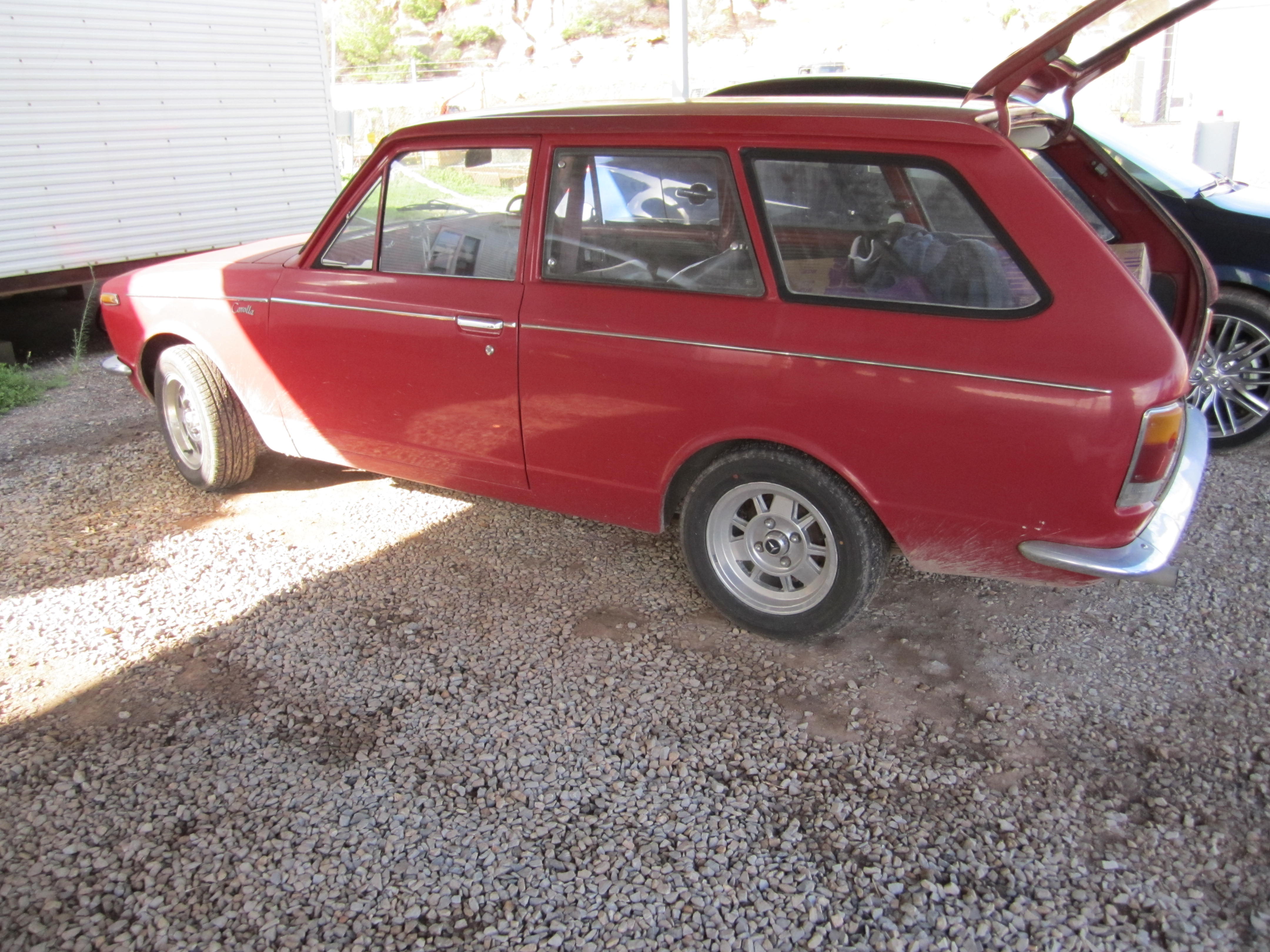

philbey Posted February 3, 2011 Author Report Posted February 3, 2011 Damn finally got through most of the nasty scratches and dings with the 120/180 grits last night. Now just to work through up to the 2000 grit then the buff and polish I'll mirror polish them for now, and I'll spray gloss black highlights inside the spokes. When the mirror fades, I'll probably just keep the lip as a high polish. Quote

philbey Posted February 14, 2011 Author Report Posted February 14, 2011 Finally finished sanding, last of the 2000 grit over and done with. Polished 2 rims, no time for the other 2, I'll get new rubber on them tomorrow, finish polishing later this week then onto the car.... Quote

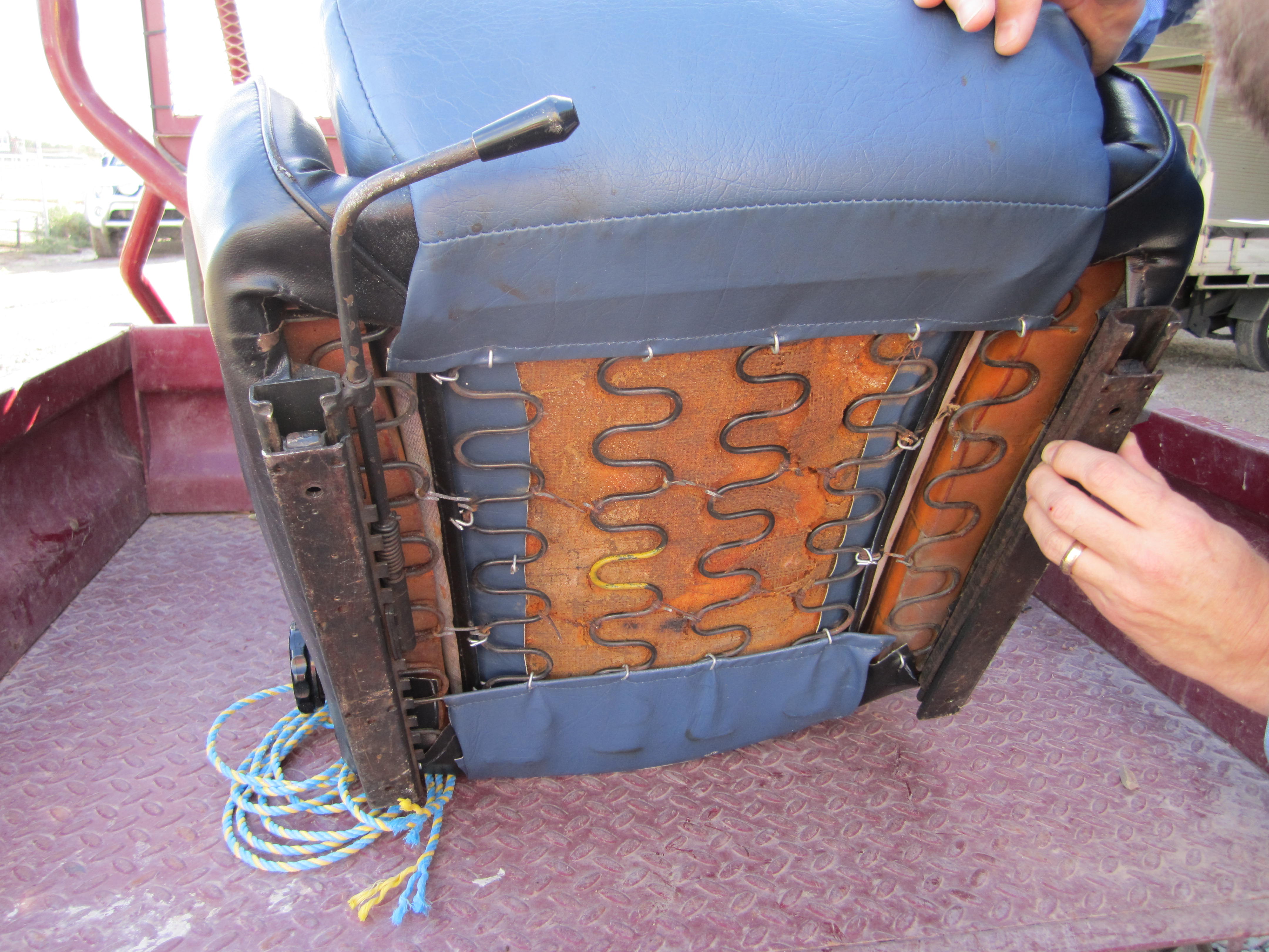

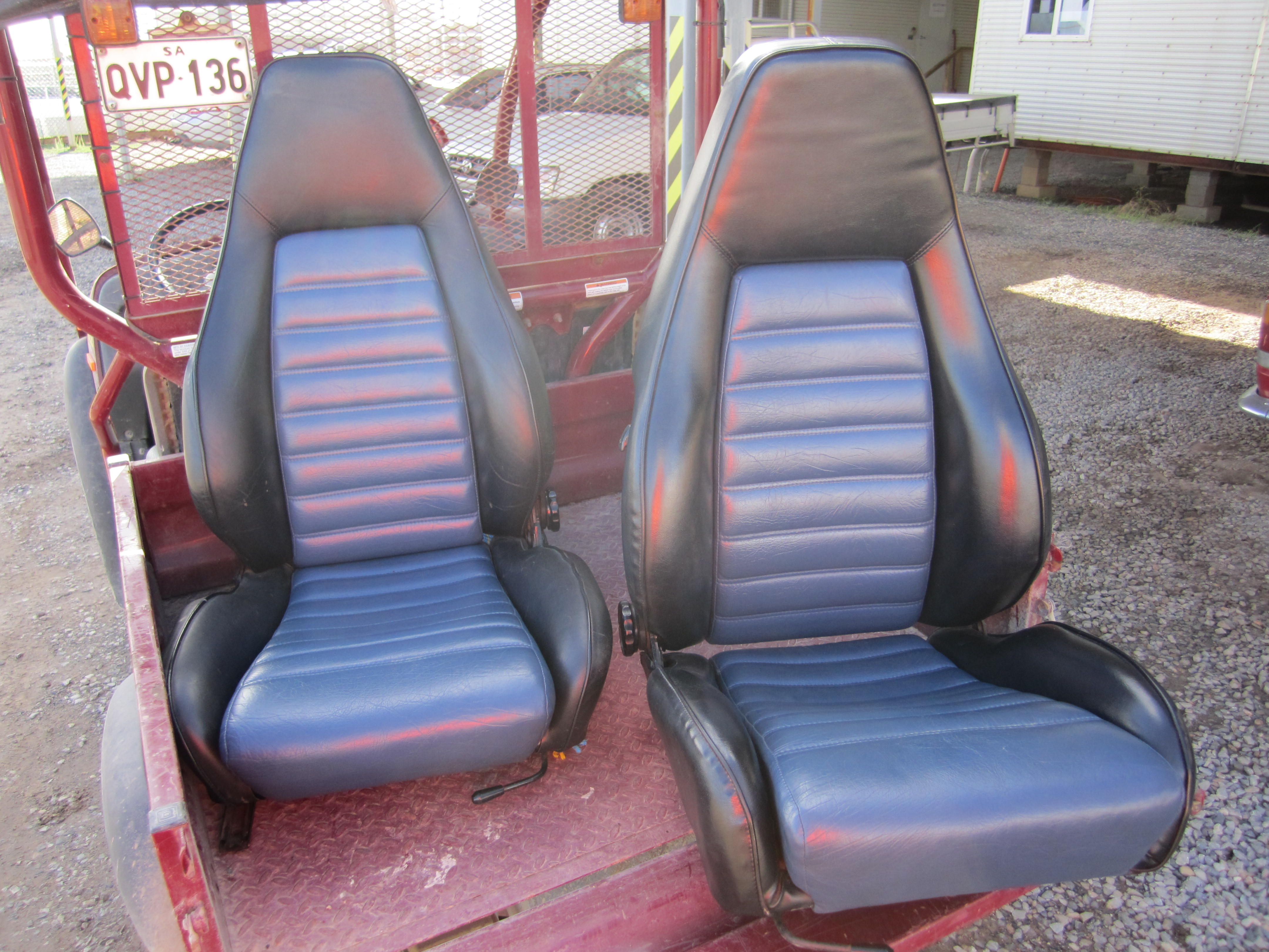

philbey Posted March 24, 2011 Author Report Posted March 24, 2011 Ok, got my mags polished and on the car, but now they're dulled a bit. But you get the idea. I'll get a better pic once I've cleaned him!! Also, bought some 911 turbo seats on ebay to fit in my 911SC. Pretty stoked, much the same as the previous ones, except Turbo ones have much bigger side bolsters. Good times. SO the plan is to fit the normal 911 seats into the rolla, mainly because the necksnappers in there at the moment are trashed! Check out the seat mounts, good old Ferdinand, these would be the easiest seats to mount in any car..... Quote

philbey Posted April 27, 2011 Author Report Posted April 27, 2011 (edited) pmp16, I had very little trouble with the 5K build. The dellortos went in fine, they tuned up fine and have held the tune for 2 years. Biggest issue was the 8cc pistons from ACL bumped the compression ratio right up but I got lucky with the Camshaft I bought being particularly large. You'd need to go with a pretty big cam for the same build, otherwise the alternative would be to take some meat out of the head. 68kw at the rear wheels. I've since had the manifold port matched and I'll put an MSD programmable 6al on eventually and hopefully push to the 100 horsepower mark!! Tojo, not sure of the exact age but I suspect they're fairly old Enkei's, especially given that the last Jap 4x110 wheels were on early RX-7s in the 70's. I actually started chasing down the actual enkei centrecaps but had awful trouble, you can get them in the US for around 50 bucks apiece!! Then just on a whim I found out that the stock KE30 centrecaps are almost a perfect fit. I did put some electrical tape around the base as they were slightly loose. I really should polish the car and wheels again and photograph it. Edited April 27, 2011 by philbey Quote
