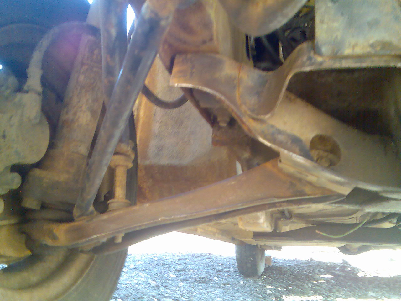

Tally Posted April 5, 2008 Author Report Posted April 5, 2008 (edited) overrated!love it dude, you should put up a pic of it with rims and fender mirrors :) hahah Fender Mirrors = tick!, Rims = tick! Got em already, just need to wait till the engine bay is all done and then ill put all my good stuff on when its back together ;) Well got down and dirty today. Got engine out, high pressure cleaned the engine bay, waited for it to dry and spent the rest of the day using a wire brush and an electric wire drill to scrape off all the surface rust that had accumulated on all the steering components. Still need another full days work to get most off. Had to use the KE70 to pull the car back to pressure clean it. We pushed it onto the car ramps with ease but the brakes seized up again lol so we had to pull it off with the KE70 again... Looks like I might have to look at the brakes next.. :dance: :hmm: God I hate rust.... Edited April 5, 2008 by Tally Quote
oh what a nissan feeling! Posted April 6, 2008 Report Posted April 6, 2008 Man that is a real overrated 25 you've got there, if youre real worried about the surface rust on struts and crossmember its pretty easy to drop it down and give it some paint. for those couple of Q's You can degrease youre steering box, the top bit is shiny alloy :dance: You should use a bit of etch on the bare metal patches, the acylic stuff is pretty thin and see through, so just brush some on if you like. To get the broken studs out drill through the remaining bit with a drill just small enough to not take the threads off, and use 'easy outs', or just pick the remainder out of the threads if you get it good enough. :hmm: Quote
