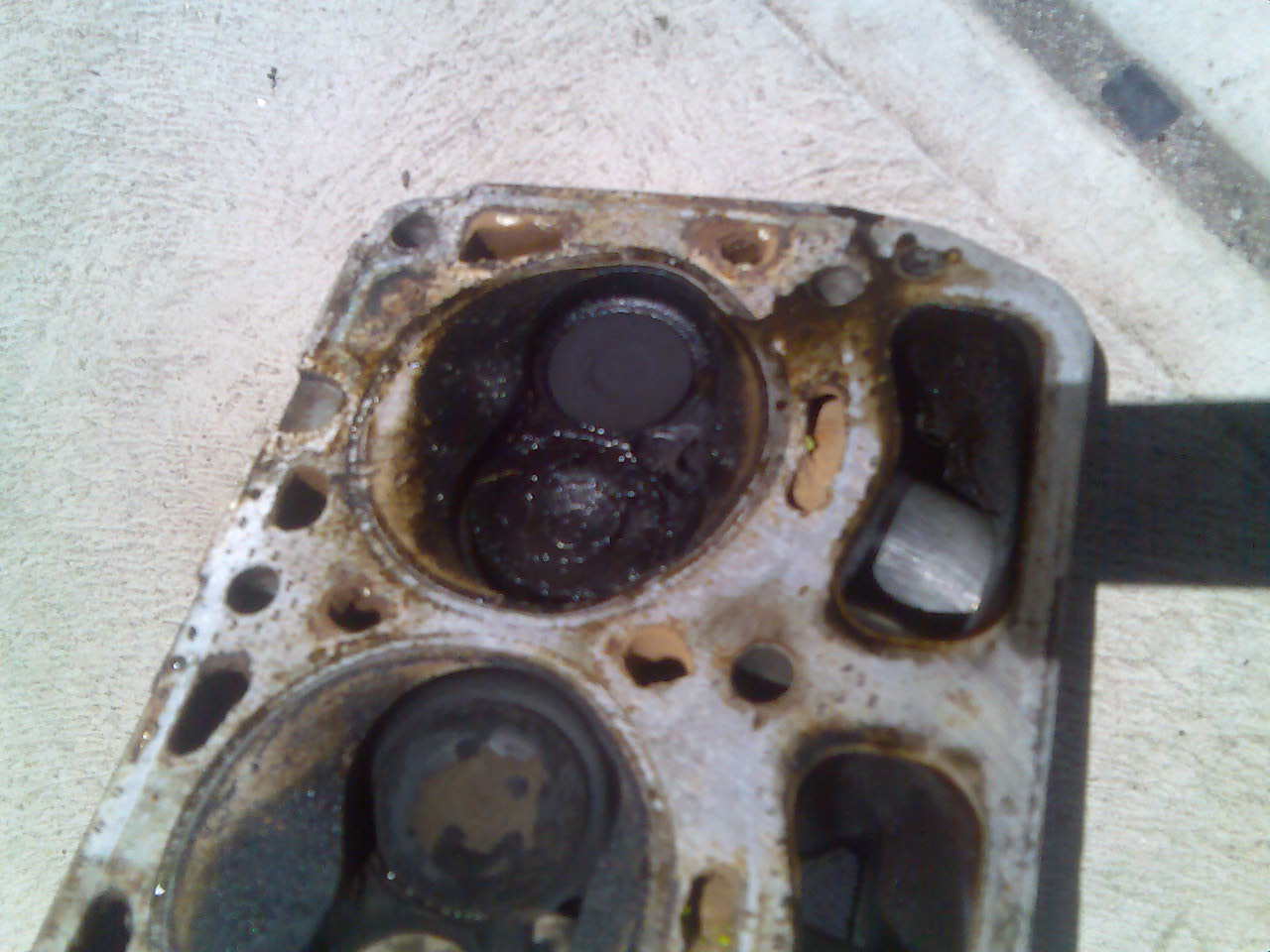

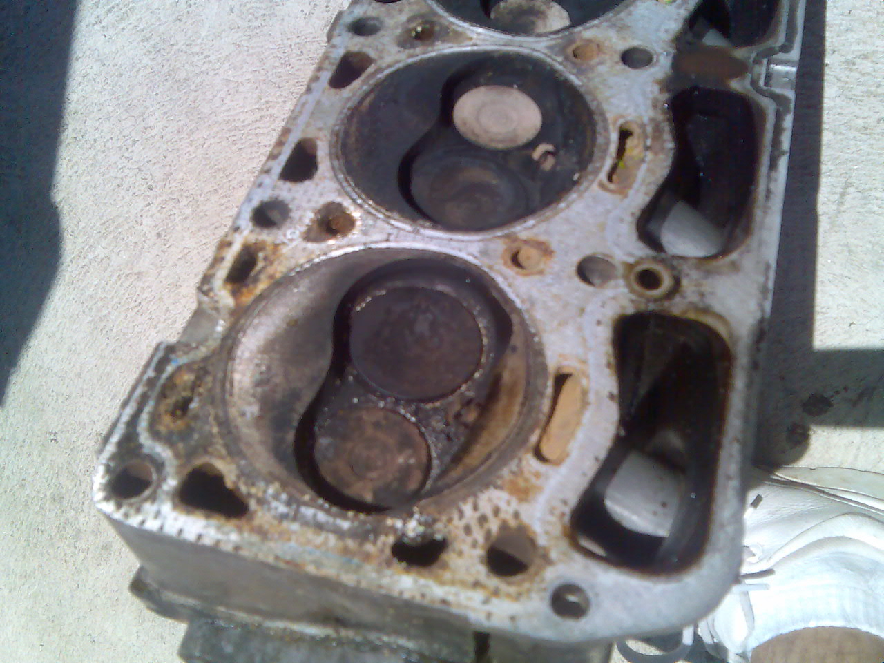

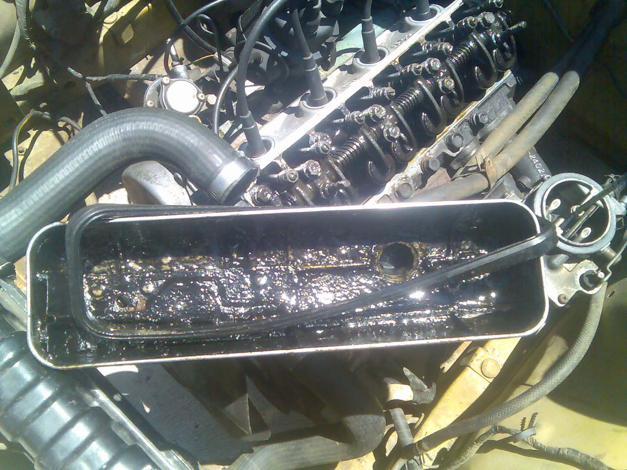

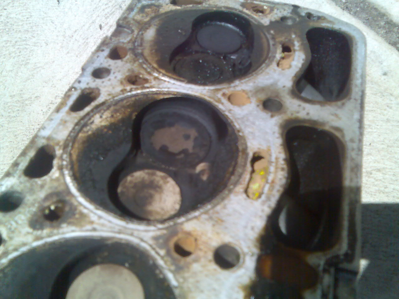

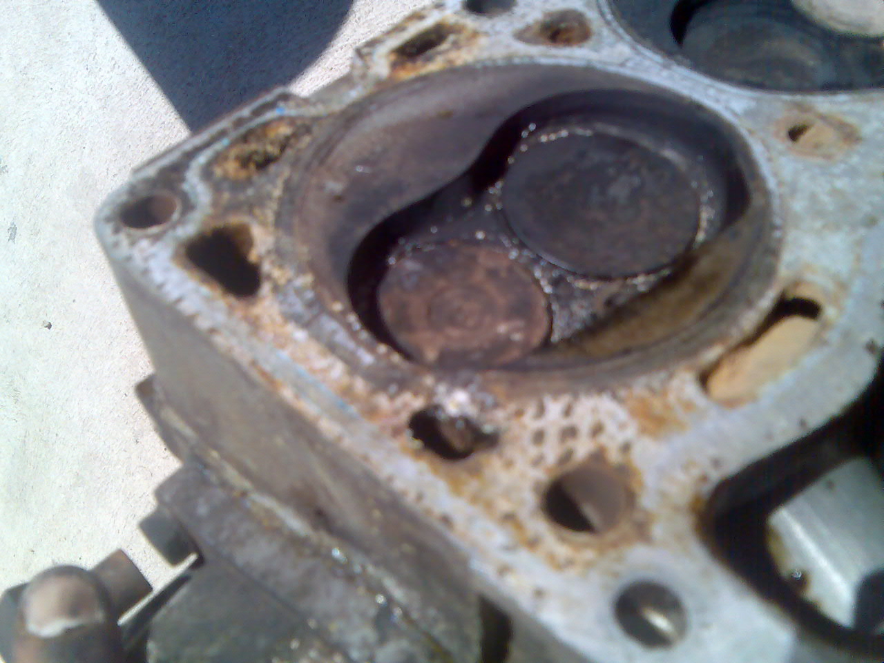

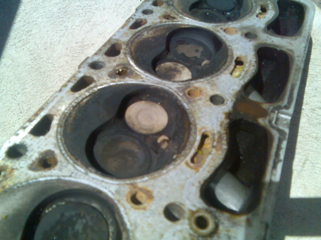

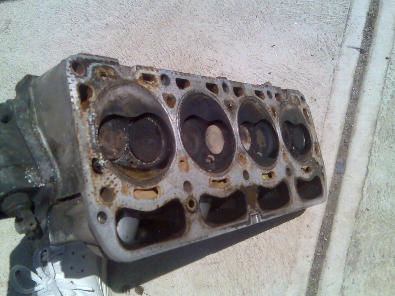

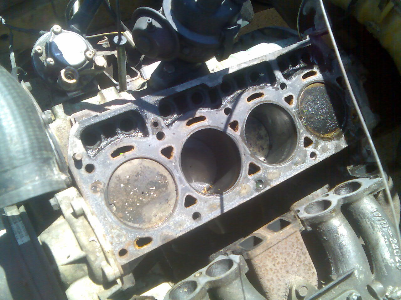

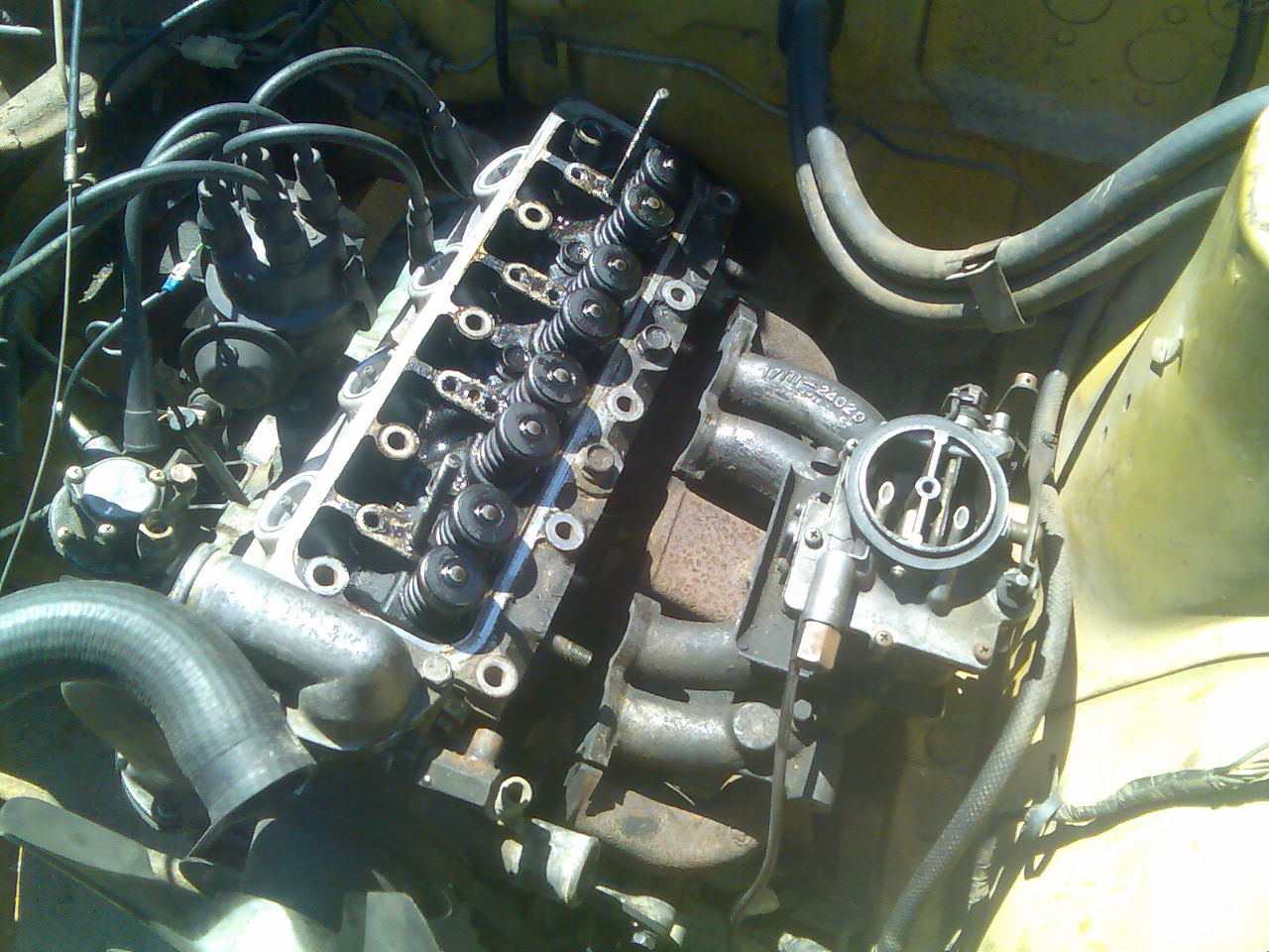

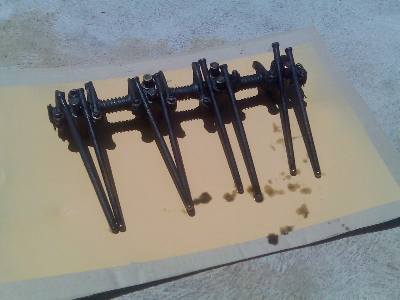

Tally Posted November 24, 2007 Author Report Posted November 24, 2007 well went and got a new headgasket and manifold gasket during the week. more problems.... Just going to cut a long story short and let the pics do some of the talking. Undid rocker Undid rocker arms and shaft. Took out pushrods. Undid manifold: Took off head: The gasket was rooted but the head was also. In the cylinder closest to the front, the water way had corrded right next to the cylinder. I think that was the casue. Ill let you guys decide as I have no idea if its ok or not. Look bad to me but. Took the head off the old engine but taht one was so far goneeeeeeeeeeeeeeeeeeeeeeeeeeeeeeeeeeee. 17 years of sitting sure does a lot of damage.. sorri don't have a pic but it was all rusted and corroded. and the top of the pistons were covered in ash. So looks like I'm up for a new head. Will put a ad up in the parts trader. Cheers guys :P Tally Looks like I'm up for a new head. Quote
