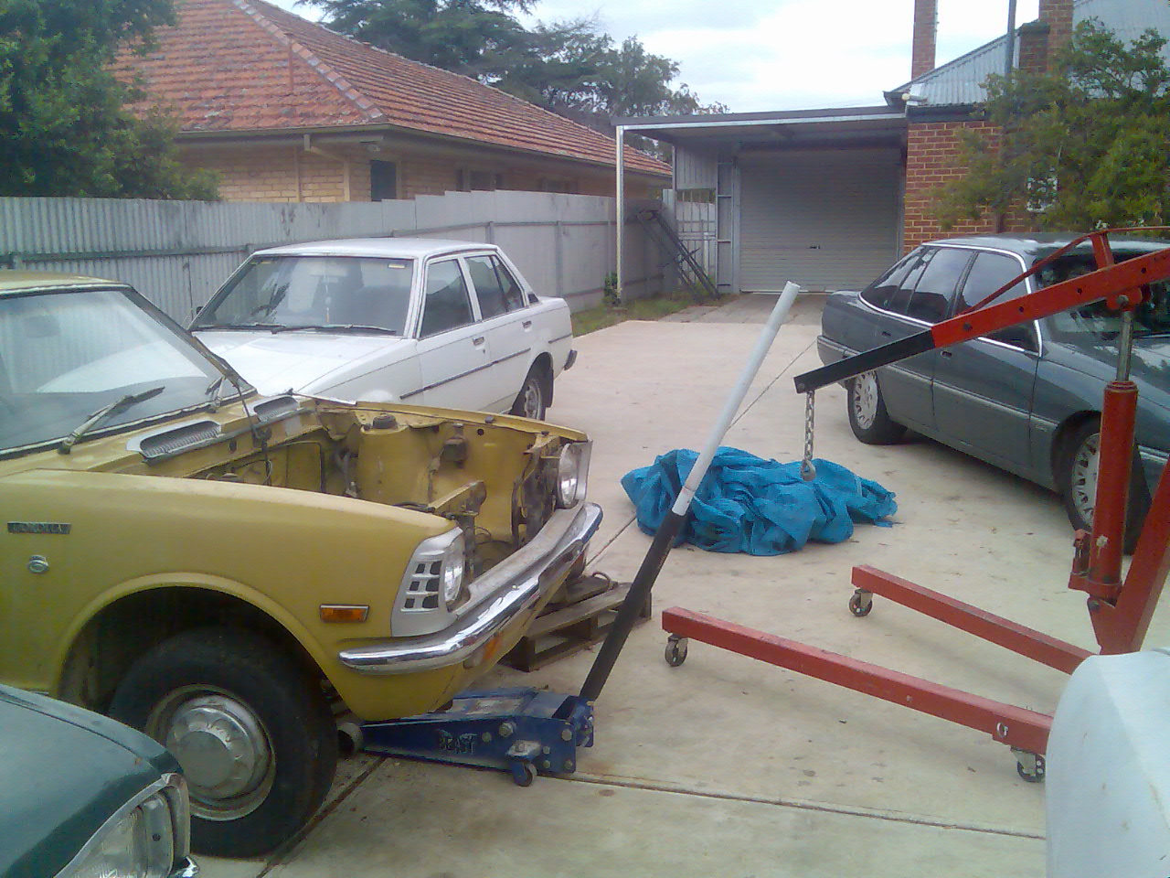

Tally Posted October 27, 2007 Author Report Posted October 27, 2007 (edited) Got the engine out today!!! Yay finally some progress!!! Didn’t get to put the new one in as it started to rain! :) Maybe put the new engine in in the morning. Need to get some degreaser, motor wash and I'm going to paint some bits in the engine bay black to make it look a bit cleaner! Cheers Tally p.s. Also I want to change the stud pattern to 4x114.3. Can I use KE30 struts? Please help me! Edited October 27, 2007 by Tally Quote

Tally Posted November 4, 2007 Author Report Posted November 4, 2007 (edited) Hey guys Nothing much has been done until today. Chucked in the new engine...... Just my luck. The engine doesnt fit the gearbox! The engine was from a early 72 KE20 and my car is a 74 KE25. The gearbox bolt spaces don't line up with the ke20 engine. I still have the ke20 gearbox though. Link to my thread in General mechanical: http://www.rollaclub.com/board/index.php?showtopic=16056 EDIT: Problem solved... mis-aligned the gearbox.... Hopefully should be running by next weekend :) Cheers Tally Edited November 4, 2007 by Tally Quote

Tally Posted November 11, 2007 Author Report Posted November 11, 2007 Update: Well today I woke up nice and early eager to run to my uncle’s place (around the corner) and start work on my beloved Corolla... Got there, took all the parts and boxes out the boot and put them in the back seat. I then took the towbar off. Much better now. Wondered what the hell that old man towed in this thing. As this was a country car I supposed he used it a lot. Well I then got stuck into the engine. I took the air filter off and adjusted the carby, choke and accelerator cable. Not that hard considering I am still learning. Next I looked at the fuel line that leads from the fuel pump to the carby. It’s cracked!!! Damn another hold-up! Luckily I still had the old engine!!! So me and my uncle carefully took it off and replaced the old one on my car. Fitted it with a few minor modifications. After that I went to put the radiator in. Nope doesn’t fit!!! WHY!!! KE20 FRONT END IS THE SAME AS KE25 TILL THE FIREWALL!!! ARGHHHHHHHH!!! The bolts didn’t line up but there was only a small gap so it isn’t to hard of a job. Then I shifted my focus to the starter motor. I couldn’t get it in as the exhaust manifold was in the way, so I got down and dirty and undid it underneath the car. Half way through my uncle comes over and puts it in in a jiffy. Bloody hell what a waste of time!!! I proceed to do up the exhaust while I helped my uncle bolt in the starter. After that we went to connect the wiring to the alternator. Just my luck, the plug doesn’t fit!!! Luckily we still have the old one off the old engine. We have a ruff idea that it’s ok as it cranked over when we were trying to get the old engine running. Went to put it in.... Damn different bracket! Again, old engine here we come! So thats were I stand right about now. So its really close to the special moment of truth..... I just hope its going to be all good, had enough dramas already. Cheers Tally Quote
