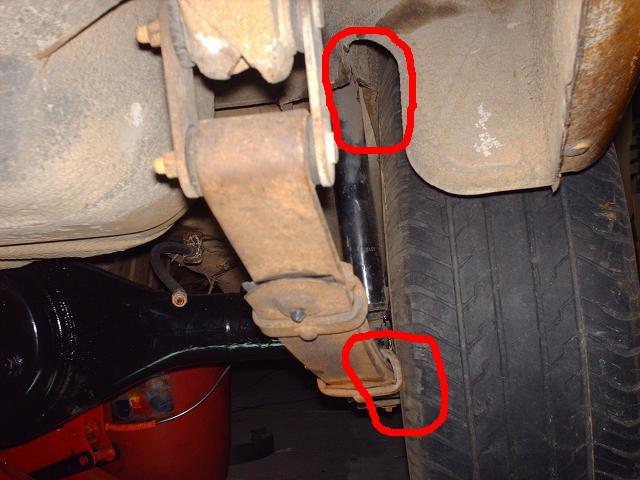

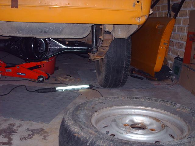

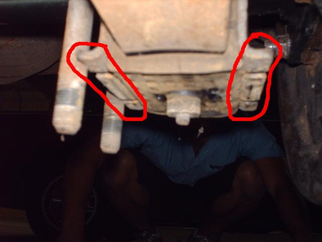

HIGH ROLLER Posted March 31, 2008 Author Report Posted March 31, 2008 Keep it up man, its gonna be great when your done. :nervous: Can't wait for the pics. Thanks for the words mate, FINALLY got to put the diff in on Friday, after waiting 2 hours at the shop because it wasn't put back together, even tho the guy said it would be ready "for sure"... quoted price was 880, which went up to 1015 because he put new wheel bearings without telling me he was charging me... The work looks great & fit perfect, but i just don't like being dicked around or lied to. ANYWAY, have to slightly modify the leaf bracket this weekend to accept the Ubolts, and will be using the original Hilux base plate and U-bolts... There is a slight complication: becuase of the axle housing size, the lower shock bolt doesnt line up... will post up pics tonight. Cheers, Mark M Quote

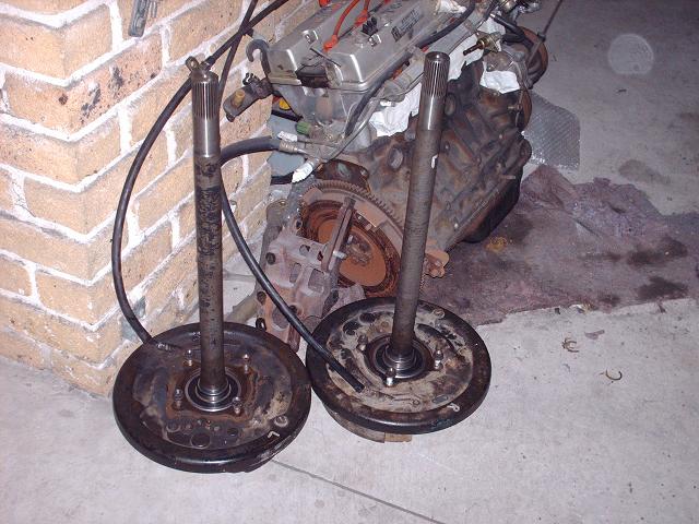

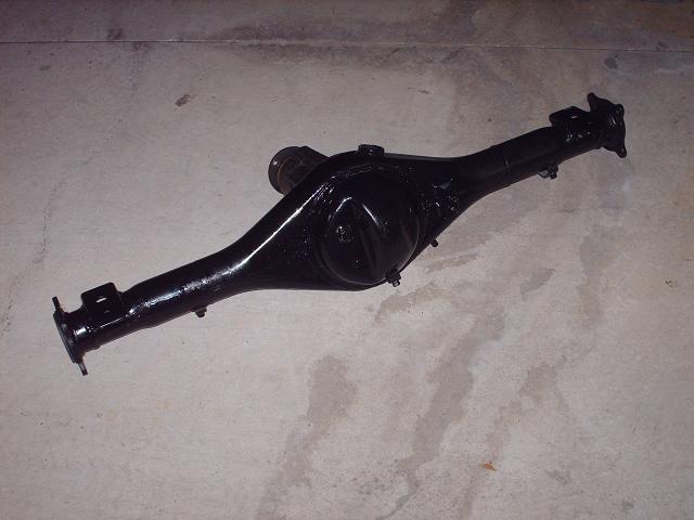

HIGH ROLLER Posted March 31, 2008 Author Report Posted March 31, 2008 so is that $1015 to cut down and weld on the leaf mounts? or does that get you stud pattern change too? new centre? i'll assume you had to supply the diff for that price. $1015- cut down and weld on all mounts, withg new wheel bearings. I supplied the complete diff (housing, axles, centre, drums). I am sticking with the Hilux 5 stud patern, will convert the front when i come to do the front brakes. Here are the pics: The Housing The Axles Mounted with Axles in The part needing modification to fit U-bolts :nervous: Will update again this weekend when i get back to it... Cheers, Mark M Quote

HIGH ROLLER Posted April 2, 2008 Author Report Posted April 2, 2008 lol dw about that i just read the last page lol things gunna be sweet as man! Bloody oath! haha thanks for the gee-up brother... going back on saturday to mod that bit i circled, secure the diff down properly, then it will pretty much be on hold till June as i'll be in Italy on holiday... Cheers, Mark Quote

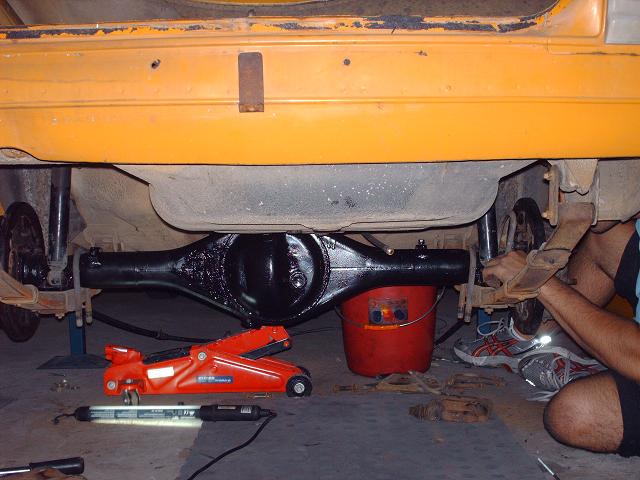

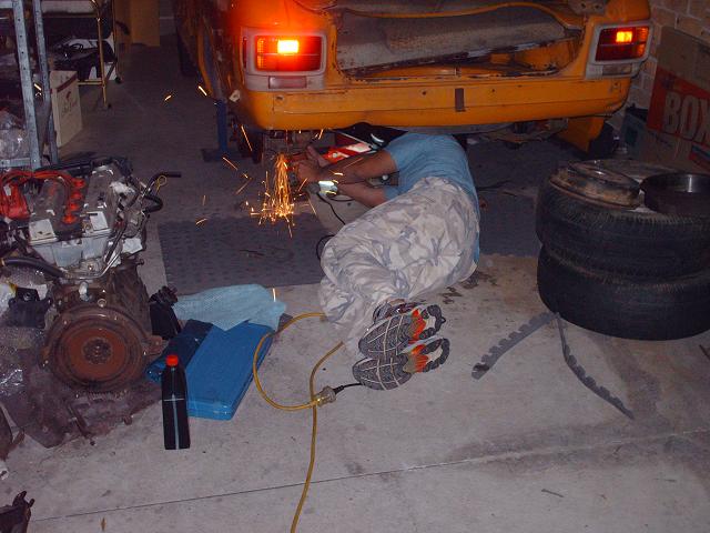

HIGH ROLLER Posted April 11, 2008 Author Report Posted April 11, 2008 (edited) Few pics My best mate, working his magic... "Houston, we have a problem!" Going to get narrower tyres this week...it rests on the leaf & inner guard...damn ute tyres... Edited April 11, 2008 by HIGH ROLLER Quote
Jono Posted April 12, 2008 Report Posted April 12, 2008 shame, all that strength of the mighty diff and you'll have to stick ugly flares on your '20 to use wide tyres! Quote
HIGH ROLLER Posted April 12, 2008 Author Report Posted April 12, 2008 shame, all that strength of the mighty diff and you'll have to stick ugly flares on your '20 to use wide tyres! nah mate, it hits on the INNER part (leaf & "tub"), just means i need rims with a bigger dish...which is what i wanted... it has at least 2inches left in the guards, and thats without rolling them. cheers, Mark M Quote
